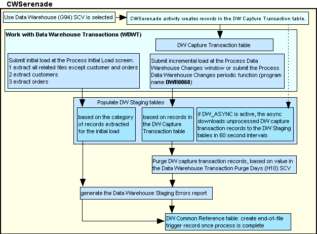

Extracting CWSerenade Data
If the Use Data Warehouse (G94) system control value is selected, you can download CWSerenade data to the DW Staging tables.
1. Submit an initial load to extract and load CWSerenade data to the CWData data warehouse. See Submitting an Initial Load for instructions and processing details.
2. On a periodic basis, submit an incremental load to extract and load changes. See Submitting an Incremental Load for instructions and processing details.
Note: You can start capturing changes at the same time you perform the initial extract and load. If there is a period when transactions are captured by the initial load and the incremental load; the system captures the latest image during the incremental load and passes the most recent data to the data warehouse.
Important: Before loading data to the CWData data warehouse, it is imperative that you verify the integrity of your CWSerenade data. Make sure you do not have any invalid records or the data in the CWData database will be inaccurate.
Download to staging tables: This flowchart explains how CWSerenade data is downloaded to the CWSerenade DW Staging tables.
You can submit an initial load at the Process Initial Load Screen in Working with Data Warehouse Transactions (WDWT). MICROS recommends you submit the initial load in stages since the load can be time-consuming.
Loading the data in stages: There are 3 categories of records to include in the initial extract and load. You should load each category separately, in the order presented below.
1. Supporting data: Reference information such as vendors, codes, financial, and business structures and the company itself.
2. Customers: You must load all customers before loading orders.
3. Orders: Based on selected date range. Note: The system does not download quotes until they are converted to orders; see Entering Pre-Order Quotes for an overview.
The submitted job runs in the QSYSNOMAX queue so as not to impair the performance of other submitted jobs.
System updates: When you perform an initial load, the system:
1.
Creates records in the DW Staging tables, based on the category of records you selected to extract and load; see Which DW Staging Tables are Updated by Each Initial Load Stage?.
2.
Generates the Data Warehouse Staging Errors Report if you selected to extract orders. This report displays order transactions that contain item or SKU errors. For example, you perform a merge/purge which updates an old order that contains an item or SKU that has since been deleted. Transactions that contain item/SKU errors remain in the DW Capture Transaction table until the errors are corrected. The system does not create any records in these DW Staging tables that are related to the order transaction in error:
• DW Order Header
• DW Order Detail
• DW Order Ship To
• DW Order Payment
• DW Order Payment Activity
• DW Order Additional Charges
3.
Creates an end-of-file record in the DW Common Reference table.
4.
Starts the Relic process to transfer the data to the cwi_staging database. See Relic Processing.
If the Use Data Warehouse (G94) system control value is selected, the system creates records in the DW Capture Transaction table, based on CWSerenade activity. The DW Capture Transaction table acts as a “to do” list for the transactions that require download to the data warehouse.
You can submit an incremental load:
• at the Process Data Warehouse Changes Window.
• by submitting the Process Data Warehouse Changes periodic function (program name DWR0068).
When you perform an incremental load, the system:
1.
Builds the supporting DW Staging tables for non-transactional activity. The supporting tables include information such as codes and categories used to group and classify data. See DW Common Reference Table.
2.
Creates records in the DW Staging tables, based on the records in the DW Capture Transaction table. Using the File code and the Key information for each DW Capture Transaction record, the job builds records in the related DW Staging table for each transaction. See DW Capture Transaction Table.
3.
Purges DW transaction records, based on the Data Warehouse Transaction Purge Days (H10) system control value. The system checks each record in the DW Transaction table and deletes any record whose Original process date is equal to the current system date minus the number of purge days specified. For example, if you processed a record a week ago, and the number of purge days is 7, the record is now eligible to be purged.
4.
Generates the Data Warehouse Staging Errors Report. This report displays order transactions that contain item or SKU errors. For example, you perform a merge/purge which updates an old order that contains an item or SKU that has since been deleted. Transactions that contain item/SKU errors remain in the DW Capture Transaction table until the errors are corrected. The system does not create any records in these DW Staging tables that are related to the order transaction in error:
• DW Order Header
• DW Order Detail
• DW Order Ship To
• DW Order Payment
5.
6.
