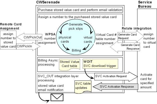

Stored Value Card Purchase and Activation
Purpose: You can purchase a stored value card item on an order to deliver to the recipient card holder by mail or email. However, before the recipient card holder can use the stored value card as a form of payment, the card must be activated by the service bureau.
Activation processing: To activate a stored value card:
1.
A customer purchases a stored value card item on an order. If the stored value card is a virtual card, the system verifies that an email address is defined for the recipient card holder. See Purchasing a Stored Value Card.
2.
During pick slip preparation, the system creates a separate pre-generated pick for each physical stored value card.
• After the picks are printed, you must:
• Use Working with Physical Stored Value Card Assignment (WPSA) to assign a number to physical stored value cards by pick control number, OR
• If you use an external system to assign numbers to physical cards, receive the card number in the CWPickIn XML Message.
See Assigning Numbers to Physical Stored Value Cards for additional details.
• For virtual stored value cards, during pick slip generation the system:
• Assigns a number to the card from the Virtual Card Number Table (FLSVCA), OR
• If you are using the Relate Stored Value Card Integration, assigns a number to the card by sending a Relate Generate Card Request to the Relate system.
See Assigning Numbers to Virtual Stored Value Cards.
3.
Once the stored value card is billed (see Billing a Stored Value Card), the system generates an SVC download trigger containing the information required to activate the card.
4.
The system sends a stored value card activation request to the service bureau for activation.
• If the Use Activation / Reversal Batch Processing (I50) system control value is selected, the system does not process the SVC download trigger until you submit the batch process from the Transmitting Activation and Reversal Transactions (SSVC) menu option.
• If the Use Activation / Reversal Batch Processing (I50) system control value is unselected, the SVC Activation integration layer job monitors for SVC download trigger records to process immediately.
See Activating a Stored Value Card.
5.
Once an approved stored value card activation is received from the service bureau, the system updates the stored value card and sends a Stored Value Card Notification Email to the customer, if defined, indicating the stored value card activation information.

Assigning a Stored Value Card Number
Before you can activate a stored value card, you must first assign a number to the card. Assigning a number to a stored value card occurs during or after pick slip generation, depending on if the stored value card is a physical or virtual card.
• Assigning Numbers to Physical Stored Value Cards
• Assigning Numbers to Virtual Stored Value Cards
Follow these steps to assign a number to a physical stored value card (SVC type Physical Card or Physical Card/Early Notify):
1. Generate a pick slip for the order containing the physical stored value card.
When you generate a pick slip for an order containing a physical stored value card, the system:
• prints a separate pick slip for each order line containing a physical stored value card. However, if you wish to print a separate pick slip for each unit of the stored value card item, set up the item as ship alone (Ship alone = Ship Alone).
• creates a record in the Pick Stored Value Card Table for each unit of the stored value card item printed.
• includes the stored value card item on the Pick Unit Report.
This table contains a record for each physical stored value card item purchased whose pick control number has not yet been confirmed. Once you confirm the pick control number, the system deletes the stored value card record from this table. The system also uses this table to validate that a number has been assigned to the physical card before the card is shipped and confirmed.
Field
Description
Company
The company where you created the pre-generated pick containing the stored value card item.
PCH control #
The pick control number assigned to the pick containing the stored value card item.
Line #
The pick control line number containing the stored value card item.
Seq#
The pick stored value card sequence number.
Card #
The number assigned to the stored value card. This field is blank when the record is created during pick slip preparation; you use the Working with Physical Stored Value Card Assignment (WPSA) menu option or the svc_card_nbr in the CWPickIn XML Message to assign a number to the physical stored value card after pick slip generation.
If you use credit card encryption, the stored value card number in this table is encrypted to provide additional security of stored value card data. See the Data Security and Encryption Guide for an overview.
If you void or reprint the pick slip: The system updates the Pick Stored Value Card table if you use the Reprinting and Voiding Pick Slips (WVRP or WSVP) menu option to void or reprint a pick slip and the pick control number containing the physical stored value card item has not yet been billed.
In WVRP when you:
The system:
Decrease the quantity allocated
Deletes the last pick stored value card record(s) created for the order line.
Void the pick slip
Deletes the associated pick stored value card records.
Reprint the pick slip
Deletes the associated pick stored value card records referencing the old pick control number and creates new pick stored value card records for the new pick control number.
Void and unreserve the pick slip
2. Assign a number to the physical stored value card.
• Use Working with Physical Stored Value Card Assignment (WPSA) to assign a number to a physical stored value card by pick control number, OR
• Use the svc_card_nbr tag in the CWPickIn XML Message to receive a card assignment from an external system.
3. Bill the pick control number containing the stored value card item.
The Use Streamlined Stored Value Card Billing (I23) system control value determines when the physical stored value card is sent to billing.
• If this system control value is selected, the system sends the pick control number assigned to the stored value card to billing immediately after you assign a number to the card.
• If this system control value is unselected, the system sends the pick control number assigned to the stored value card to billing after you wand and bill the card at the manifesting station.
If you use the Manually Confirming Shipments (MCON) menu option to confirm a pick control number containing a stored value card item, the system verifies that the stored value card is assigned a number. If the stored value card is not assigned a number, the system does not allow you to confirm the pick control number or change the status of the pick slip to carryover and instead displays an error message: All stored value card numbers must be entered before accepting.
For more information: See Billing a Stored Value Card for more information on the processing the system performs when you bill a stored value card.
To assign a number to a virtual stored value card (SVC type V), generate a pick slip for the order containing the virtual stored value card.
When you generate a pick slip for an order containing a virtual stored value card, the system:
• automatically assigns a stored value card number to the virtual card, using the next available number from the Virtual Card Number Table (FLSVCA) and deletes the record from the Virtual Card Number table.
Note: Make sure a number is available in the Virtual Card Number table to assign to the virtual stored value card; if a number is not available to assign to the card, the entire order line containing the stored value card item will not be billed and the order will print on the Stored Value Card Assignment Errors Report.
• express bills the item and sends the pick control number containing the virtual stored value card to billing.
• does not include the stored value card item on the Pick Unit Report.
Relate Stored Value Card integration: If you are using the Relate Stored Value Card Integration, the system does not assign a number to a virtual card from the Virtual Card Number table. Instead, the system:
• generates a Relate Generate Card Request and sends the message to Relate.
• receives the Relate Generate Card Response from Relate, containing the assigned card number.

Generating the Stored Value Card Activation Request
To generate a stored value card activation request, the system:
1.
Creates an SVC download trigger when an order containing a stored value card item assigned a number is billed; see Identifying SVC Download Triggers.
2.
Looks for unprocessed SVC download triggers to process, based on the setting of the Use Activation / Reversal Batch Processing (I50) system control value.
• If this system control value is selected, the system does not process the stored value card trigger records until you submit the batch process using the Transmitting Activation and Reversal Transactions (SSVC) menu option or the SVCACT periodic function (program name PFR0076).
• If this system control value is unselected, the SVC Activation integration layer job monitors for stored value card download trigger records to process at defined intervals, based on the Outbound delay time.
The system:
• looks for SVC download triggers with the File code SVC and a status of ready (R).
• determines which stored value card activation to download, based on the Key field for the activation download trigger.
• looks for a record in the Stored Value Card Table that contains this information.
3.
Looks at the Stored Value Card Activation Authorization Service (I26) system control value to determine the service bureau used to activate stored value cards.
4.
Looks at the Communication type field for the service bureau to determine how transactions are processed between CWSerenade and the service bureau.
• Integration Layer = CWIntegrate integration. The system sends activation transactions to the service bureau via a CWIntegrate site using the queues defined for the activation integration layer job. You must define communication protocols within the CWIntegrate site to translate and transmit data between CWSerenade and the service bureau. See Process Activations Using Integration Layer Communication.
• Payment Link = Point-to-point integration. The system sends activation transactions to the service bureau using a point-to-point integration. You must define communication settings in Working with Customer Properties (PROP). The system does not use the activation integration layer job to communicate with the service bureau; however, the system uses the job to process activation triggers. See Process Activations Using Payment Link Communication.
If the Communication type field for the service bureau is Integration Layer:
• CWSerenade looks at the SVC activation integration layer process field defined for the service bureau to determine the integration layer process used to process SVC download triggers. The delivered integration layer process is SVC_OUT.
• CWSerenade generates a Stored Value Card Activation Request Message and sends the message to the outbound queue defined for the SVC_OUT job and waits for a response. Note: You can define only 1 outbound queue for the SVC_OUT job. The Wait time field for the outbound queue indicates how long the system waits for a response.
• CWSerenade creates a record in the Integration Process Control table for the Stored Value Card Activation Request Message. You can review the records in the Integration Process Control table at the Work with Integration Process Control Screen.
• CWIntegrate translates the Activation Request Message into the format required by the service bureau and sends the formatted message to the service bureau.
• The service bureau receives the formatted request message, processes the activation request, and sends back a response message indicating if the activation request was approved.
• CWIntegrate translates the response message into the format required by CWSerenade and sends the Stored Value Card Activation Response Message to the SVC_OUT inbound queue.
If the Communication type field for the service bureau is Payment Link:
• CWSerenade uses the settings in Working with Customer Properties (PROP) to send the activation request directly to the service bureau in the format of the other system.
• The service bureau receives the activation request, processes the activation, and sends a response back to CWSerenade.
See Processing Authorizations and Deposits Using Point-to-Point Communication for a list of integrations that support point-to-point communication.
