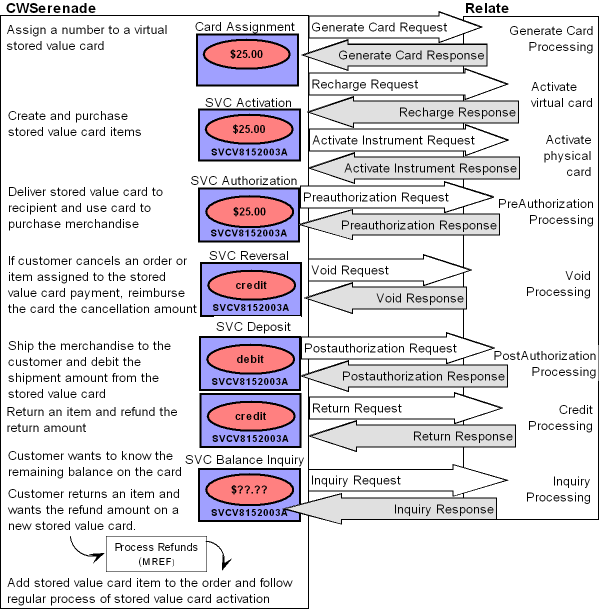

Relate Stored Value Card integration allows you to process stored value cards between CWSerenade and Relate using point-to-point communication. Processing of stored value cards remains the same in CWSerenade; however, instead of using the stored value card integration layer jobs to process the stored value card transactions and send the transactions to a CWIntegrate site via the queues defined for the integration layer jobs, CWSerenade uses the Relate Stored Value Card Messages to send the stored value card transactions directly to the Relate system for processing.
Required versions: To use the Relate stored value card integration with CWSerenade, you must be on version 8.5 or later of Relate and version 2.5 or later of CWSerenade.
In this topic:
• Transactions Processed Between CWSerenade and Relate
• Relate Integration Setup in CWSerenade
• Relate Integration Setup in Relate
• Relate Stored Value Card Messages
For more information: See Stored Value Card Overview and Setup for an overview of stored value card processing.
You can process the following transactions for the Relate integration with CWSerenade:
CWSerenade
Relate
See:
Activation
Virtual card assignment: To assign a number to a virtual card CWSerenade sends a Generate Card Request to Relate. See Assigning Numbers to Virtual Stored Value Cards.
Generate Card (virtual card number assignment)
• Relate Generate Card Request
• Relate Generate Card Response
Recharge (virtual card activation)
• Recharge Request
• Recharge Response
Activate Instrument (physical card activation)
• Relate Activate Instrument Request
• Relate Activate Instrument Response
Stored Value Card Purchase and Activation
Authorization
(both online and batch)
Preauthorization
• Relate PreAuthorization Request
• Relate PreAuthorization Response
Processing Authorizations and Deposits Using Point-to-Point Communication
Deposit
Postauthorization
• Relate PostAuthorization Request
• Relate PostAuthorization Response
Credit
Return
• Relate Return Request
• Relate Return Response
Balance Inquiry
Inquiry
• Relate Inquiry Request
• Relate Inquiry Response
Stored Value Card Balance Inquiry (MSVB)
Authorization Reversal
Void
• Relate Void Request
• Relate Void Response
Stored Value Card Authorization Reversal
Relate integration stored value card process flow:
