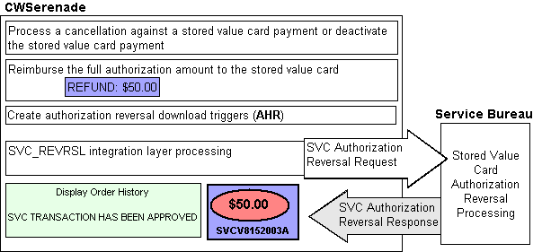

Stored Value Card Authorization Reversal Process
Purpose: The system reimburses a stored value card the original authorization amount associated with the card when you process a cancellation associated with a stored value card payment or deactivate the stored value card.
Note: If the Perform Authorization Reversal during Deposit Processing (J20) system control value is selected, when you process deposits and the deposit amount is less than the original authorization amount, the system reimburses the stored value card the difference; see Authorization Reversal Process During Deposits.
Stored Value Card Authorization Reversal Process:

For each authorization reversal download trigger, the system generates a Stored Value Card Authorization Reversal Request.
9.
The system looks at the Communication type field for the service bureau to determine how transactions are processed between CWSerenade and the service bureau.
• Integration Layer = CWIntegrate integration. The system sends authorization reversal transactions to the service bureau via a CWIntegrate site using the queues defined for the authorization reversal integration layer job. You must define communication protocols within the CWIntegrate site to translate and transmit data between CWSerenade and the service bureau. See Processing Authorization Reversals Using Integration Layer Communication.
• Payment Link = Point-to-point integration. The system sends authorization reversal transactions to the service bureau using a point-to-point integration. You must define communication settings in Working with Customer Properties (PROP). The system does not use the authorization reversal integration layer job to communicate with the service bureau; however, the system uses the job to process authorization reversal triggers. Note: This option is available only for the Relate Stored Value Card Integration. See Processing Authorization Reversals Using Payment Link Communication.
If the Communication type field for the service bureau is Integration Layer:
• CWSerenade creates a record in the Integration Process Control table for the SVC Authorization Reversal Request Message and waits for a response from CWIntegrate. You can review the records in the Integration Process Control table at the Work with Integration Process Control Screen.
• The system sends the SVC Authorization Reversal Request Message to the outbound queue defined for the SVC_REVRSL job and waits for a response. Note: You can define only 1 outbound queue for the SVC_REVRSL job. The Wait time field for the outbound queue indicates how long the system waits for a response.
• CWIntegrate translates the Authorization Reversal Message into the format required by the service bureau and sends the formatted message to the service bureau.
• The service bureau receives the formatted request message, processes the authorization reversal request, and sends back a response message indicating if the authorization reversal request was approved.
• CWIntegrate translates the response message into the format required by CWSerenade and sends the SVC Authorization Reversal Response Message to the SVC_REVRSL inbound queue.

What Happens When the Authorization Reversal is Approved?
An authorization reversal is approved if the Authorization Reversal Response message contains an authorization number. In this case, the system:
• updates the associated record in the Integration Process Control table to CMP complete (if the Communication type field for the service bureau is Integration Layer).
• updates the associated record in the SVC Authorization Reversal table with the approval date, approval time, and reversal response.
• creates an order transaction history message indicating the authorization reversal was approved: Reversal Has Been Approved.
• voids the authorization history record.
