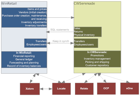

WinRetail Integration Overview
Purpose: CWSerenade’s integration with WinRetail supports the XstorePlus product, providing an integrated suite of retail, merchandising, and reporting functions. This integration includes:
• sending purchase orders, vendors, item information, and inventory information from WinRetail to CWSerenade
• sending sale and return information from CWSerenade to WinRetail
In addition to the integration between CWSerenade and WinRetail, each system can integrate separately with external systems such as Xstore, Locate, Relate, OCP, eOne, and other providers such as an authorization service.

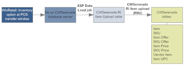

Importing Items and Related Information from WinRetail
Purpose: Items and related information from WinRetail, such as pricing, are loaded into the RI Item Upload table.
POS Transfer in WinRetail: As in the processes described above, you use the POS Transfer window in WinRetail, and then select the Inventory option to extract item-related information and write it to the designated folder.
Loading data into the RI Item Upload table: As in the processes described above, the XSP Data Load job in SQL Server takes the item-related information from the designated folder and writes the information to the RI Item Upload table. The RIUPLD periodic function reads the information in the RI Item Upload table, performs necessary edits, and creates records in the Item, SKU, and other tables. See the Working with Retail Integration Item Upload (RIIU).
