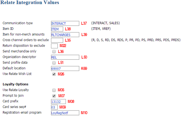

Relate Integration Values (L52)
Purpose: This screen includes the following system control values for integration with Relate:
• Relate Customer Integration (L37)
• MICROS Integration Item ID (L38)
• Item for Non-Merchandise Amounts (L39)
• Cross Channel Orders to Exclude in Sales Feed (L35)
• Return Disposition Code to Exclude in Relate Sales Feed (M22)
• Merchandise Only in Sales Feed (L36)
• Relate Organization Descriptor (L50)
• Send Profile Data to Relate (L51)
• Default Location for Sales Download (K69)
• Use Relate Wish List (M26)
• Use Relate Loyalty (M06)
• Prompt to Join Loyalty (M07)
• Relate Loyalty Card Prefix (M08)
• Relate Loyalty Card Series Sequence Number (M09)
• Relate Loyalty Registration Notification Email Program (M10)
Each is described below.
Purpose: Defines how CWSerenade communicates customer information with Relate.
Code field: Set this field to:
• SALES: CWSerenade populates the Relate Customer file with a Relate Add or Update Customer Message based on customer activity when you run the Relate Sales Feed. In this situation, the file includes only sold to customers that are associated with the invoices in the Relate Post POSlog Transaction Message. Use this setting if CWSerenade is the system of record for customer information. Note: You cannot set this field to SALES if the Use Relate Loyalty (M06) system control value is selected.
• INTERACT: CWSerenade communicates interactively with Relate when you create or update a customer, and also populates the Relate Customer file with a Relate Add or Update Customer Message based on customer activity when you run the Relate Sales Feed. When you search for a customer in customer maintenance, order entry, when creating catalog requests, or when creating customer memberships, CWSerenade looks first to Relate, rather than the CWSerenade Customer Sold To table, and you use the Customer Scan Screen. Use this setting if Relate is the system of record for customer information.
• blank: CWSerenade does not communicate customer information to Relate, or search the Relate database for customers.
For more information: See the Relate Batch Customer and Sales Integration and the Relate Customer Integration.

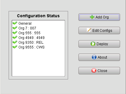

Purpose: Use this field to specify the code that identifies the Relate organization that maps to your CWSerenade company.
Code field: Enter the three-position code that matches the Organization descriptor specified through Relate’s Conflate option.
To identify the Organization descriptor:
• Open the first Conflate for Relate window. To open:
• On your Relate server, advance to the Conflate folder, typically C:\srv\conflate where C: is the root drive.
• Double-click the conflate.jar file to open the first Conflate for Relate window.
• Select the Edit Configs option to advance to the second Conflate for Relate window, then select the tab that represents your organization in Relate.
The current Organization descriptor follows the organization ID, separated by a colon. For example, the organization ID 9555 in the above image has an Organization descriptor of CWS.
• If you need to change the Organization descriptor, double-click the System / Organization ID folder in the left-hand pane to expand it, then highlight Organization Descriptor.
You can then enter an Organization descriptor in the text field, and save your entry when you are done.
Purpose: Use this field to define whether you use the Relate Loyalty Integration.
Yes/No field: Select this field if you want to use the Relate Loyalty integration.
Important: If you select this field:
• The Relate Customer Integration (L37) system control value must be set to INTERACT, indicating you communicate with Relate interactively.
• You must define a card prefix in the Relate Loyalty Card Prefix (M08) system control value.
• You must define a card series sequence number in the Relate Loyalty Card Series Sequence Number (M09) system control value.
• The Use Rewards Integration (K86) system control value must be unselected.
• The Rewards Certificates Pay Type (L54) system control value must be blank.
Leave this field unselected if you do not want to use the Relate Loyalty integration.
For more information: See Relate Loyalty Integration for processing details and the required setup.
Purpose: Use this field to define whether the system automatically displays the Customer Loyalty Registration Window during Order Entry and Work with Customers (WCST) when Relate does not find a loyalty card for the customer.
Yes/No field: Select this field to automatically display the Customer Loyalty Registration window when you:
• Select a sold to customer on the Customer Selection Screen if Relate does not find a loyalty card for the customer and the customer’s RELATE_LOYALTY_PROMPT_ATTRIBUTE setting in Relate is TRUE or blank.
• Change a sold to customer in Creating and Updating Sold-to Customers (WCST) if Relate does not find a loyalty card for the customer and the customer’s RELATE_LOYALTY_PROMPT_ATTRIBUTE setting in Relate is TRUE or blank.
• Create a sold to customer in Creating and Updating Sold-to Customers (WCST) or Order Entry (OEOM) after the customer is created in Relate.
• In Work with Customers, this window automatically displays after the final Accept to create the customer.
• In Order Entry, this window automatically displays after the system validates the customer information and source code on the order and you click Accept.
• Create an order in Order Entry (OEOM) if you do not use the CTI Customer Selection Screen and Relate does not find a loyalty card for the customer and the customer’s RELATE_LOYALTY_PROMPT_ATTRIBUTE setting in Relate is TRUE or blank. This window automatically displays after the system validates the customer information and source code on the order and you click Accept.
Leave this field unselected if you do not want the Customer Loyalty Registration window to automatically display. Regardless of the setting of this system control value, this window displays when you:
• Select Loyalty from the Action drop-down menu on the Customer Scan Screen in Work with Customers (WCST) or Order Entry (OEOM).
• Select Loyalty on the Customer Selection Screen after selecting a sold to customer.
• Select Loyalty Account on the Display More Options Screen.
• Select Loyalty Account on the More Customer Sold To Options Screen.
• Select Loyalty on the Third Streamlined Order Inquiry Screen (Order Summary) in Streamlined Order Inquiry (DORI).
When you select the Loyalty option, the system retrieves the sold to customer’s information from Relate. If Relate does not find a loyalty card for the customer, the system advances you to the Customer Loyalty Registration Window, where you can select to enroll the customer in the Relate Loyalty program.
• If Relate finds a loyalty card assigned to the customer, the system advances you to the Display Loyalty Account Screen. If Relate finds more than one loyalty card assigned to the customer, the loyalty account information for the first card displays on the screen.
• If a Relate ID is not defined for the customer in the Customer Sold To table, the system displays an error message similar to the following: This customer does not have a Relate ID. Note: If a Relate ID is not defined for the sold to customer, the Loyalty option does not display on the Third Streamlined Order Inquiry Screen (Order Summary) in Streamlined Order Inquiry (DORI).
• If a connection could not be made to Relate, the system displays an error message similar to the following: Unable to connect to Relate.
Note: In order to display the Customer Loyalty Registration window, the Use Relate Loyalty (M06) system control value must be selected and the Relate Customer Integration (L37) system control value must be set to INTERACT.
Purpose: Use this field to define the 5 digit prefix assigned to the Loyalty Card Definition in Relate that is used to assign new loyalty cards to sold to customers that join the loyalty program.
Code field: Enter the 5 digit prefix assigned to the Loyalty Card Definition in Relate that is used to assign new loyalty cards to customers.
• You must define a loyalty card prefix if the Use Relate Loyalty (M06) system control is selected.
• The 5 digit card prefix you enter here must match the 5 digit card prefix in Relate; for example, if the card prefix in Relate is 00905, you must enter 00905 in this field.
• A different card prefix is used for the Relate Stored Value Card Integration.
For more information: See Relate Loyalty Integration.
Purpose: Use this field to define the 2 digit card series number assigned to the Loyalty Card Definition in Relate that is used to assign new loyalty cards to sold to customers that join the loyalty program.
Code field: Enter the 2 digit card series sequence number assigned to the Loyalty Card Definition in Relate that is used to assign new loyalty cards to customers.
• You must define a loyalty card series sequence number if the Use Relate Loyalty (M06) system control is selected.
• The 2 digit card number you enter here must match the 2 digit card number in Relate; for example, if the card series sequence number in Relate is 02, you must enter 02 in this field.
• A different card series sequence number is used for the Relate Stored Value Card Integration.
Purpose: Use this field to define the program used to generate a Relate Loyalty Registration Notifications email when a sold to customer joins the loyalty program and is assigned a loyalty card in Relate. This email contains the loyalty card number assigned to the customer during the loyalty registration process; see Relate Loyalty Registration Notification Sample and Contents for a sample email.
System name field: Enter the program used to generate a Loyalty Registration Notification email. The base program name is LoyRegNotf.
Leave this field blank if you do not want to generate a Relate Loyalty Registration Notification email when a sold to customer joins the loyalty program and is assigned a loyalty card in Relate.
