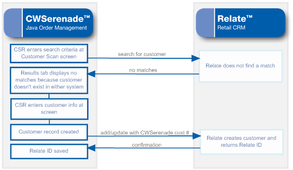

• Searching for a customer: When you search for an existing customer in a CWSerenade menu option, Relate returns a list of customers matching the search criteria. See Notes on Searching for a Customer on CWSerenade Screens for more information.
• Synchronizing customer information (add/update customer): Synchronization occurs when:
• You create a new customer in CWSerenade. CWSerenade sends a message indicating to create the new customer in Relate.
• You retrieve an existing customer record from Relate. When Relate sends the current customer information to CWSerenade, CWSerenade creates or updates its customer record based on the information received from Relate.
• You update an existing customer at a CWSerenade screen. CWSerenade sends an update message to Relate.

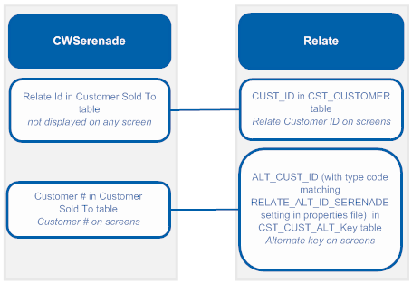

How are synchronized customers linked? A pair of synchronized CWSerenade and Relate customer records are linked by matching customer numbers:

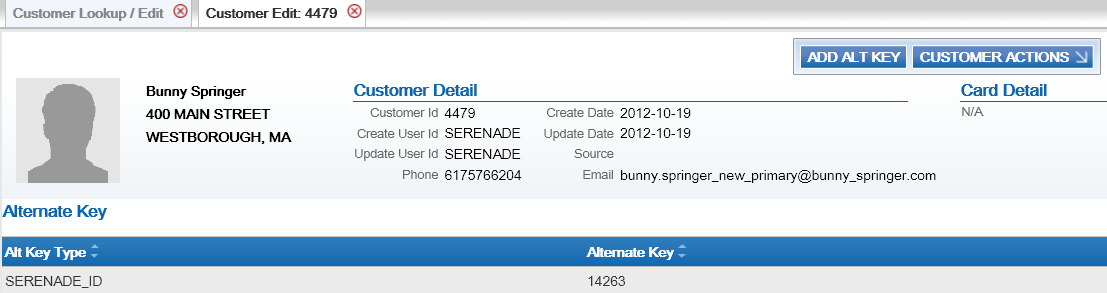

• CWSerenade : the Relate Id in the Customer Sold To table identifies the customer number in Relate
• Relate: the Serenade Alternate key in Relate identifies the customer number in CWSerenade. The RELATE_ALT_ID_SERENADE setting in Working with Customer Properties (PROP) defines the alternate key type for the CWSerenade customer number in Relate.

Creating a new customer
Searching:
• The CSR enters the search criteria at the Customer Scan Screen.
• There are no records matching the search criteria in either Relate or CWSerenade.
• The Results tab at the Customer Scan screen does not display any records.
Creating the customer:
• When the CSR enters the information on the new customer:
• CWSerenade creates the customer record in its Customer Sold To table.
• CWSerenade sends an add/update message to Relate.
• Relate creates the customer record, assigning the CWSerenade customer number as an alternate key, and sends the Relate customer number to CWSerenade.
• CWSerenade updates the Customer Sold To record with the Relate Id.

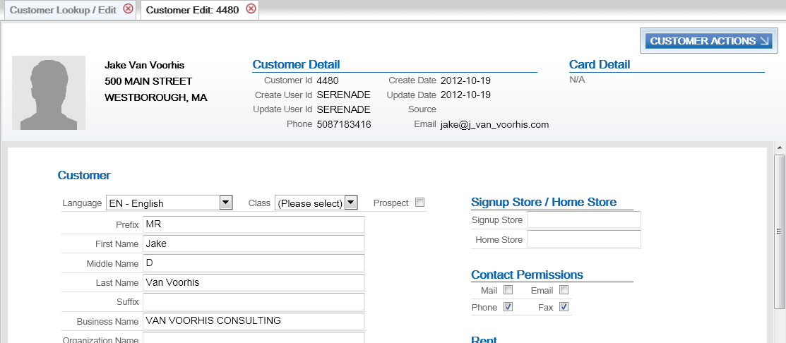

Reviewing the customer in Relate: Use the Customer Lookup / Edit option in Relate to search for, review, or update a customer.

Customer numbers
Displaying in Relate:
• CWSerenade customer number: select Alternate Key.
• Relate ID: labeled the Customer Id.
Customer number
Alternate key SERENADE_ID
Indicates the Alt Key Type of the alternate key in Relate that maps to the CWSerenade customer number.
This field is available for display in Relate by selecting Alternate Key in the Customer Lookup /Edit option.
Relate automatically creates this entry for a customer when you send the customer to Relate interactively or through the Relate Add or Update Customer Message if it does not already exist based on the RELATE_ALT_ID_SERENADE setting in the Relate Properties file. In this situation, Relates also adds a row to the CST_ALT_KEY_TYPCODE table in the Relate database if it does not already exist.
Relate id
Customer ID
Note: The Relate id:
• is not displayed on any screen in CWSerenade
• is an alphanumeric field in the CWSerenade Customer Sold To table

Customer-level information and permissions
The customer-level permissions in Relate are informational only.
Displaying in Relate: Included under the Customer option. See above.

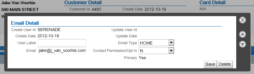

Opt in/out setting for primary email address
Email contact permission flag
CWSerenade to Relate:
Y defaults if the Email status setting for the primary email address is O1; otherwise leave blank (N).
Relate does not send this setting to CWSerenade.

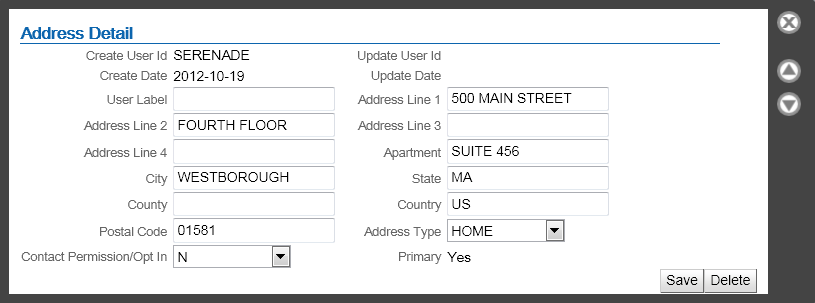

Address
Important: Only the customer’s HOME address in Relate is mapped to CWSerenade. If more than one HOME address exists in Relate, the system uses the primary HOME address. This information is required in order for CWSerenade to create the customer record correctly.
Relate automatically creates an Address type of HOME when it receives a customer from CWSerenade interactively or through the Relate Add or Update Customer Message. In this situation, Relates also adds a row to the CST_ADDR_TYPCODE table for ADDRESS_TYPECODE HOME in the Relate database if it does not already exist.
No address validation in Relate: Unlike CWSerenade, Relate does not require an address for a customer, and does not validate that the address includes certain required components; for example, no address lines are required. To prevent problems in CWSerenade, it is important that any other means you use to create customers in Relate, such as through your e-commerce site, always creates a home address when you use the Relate customer integration. If a home address does not exist in Relate, Relate displays the customer in CWSerenade without an address. Also, if certain fields for the home address are not defined in Relate, these fields will be blank when you display the customer in CWSerenade. However, when you update the customer’s address in CWSerenade so that is passes validation, the system will also update the customer’s home address in Relate
Displaying in Relate: Select Address.
N/A
Primary
Set to Yes in Relate.
Street
Address line 1
Truncated in CWSerenade to 32 positions.
Any trailing spaces are removed.
Apt/Suite
Apartment
Truncated in CWSerenade to 32 positions. If deleted in CWSerenade, also deleted in Relate.
Address (lines 2-4)
Address lines 2-4
Truncated in CWSerenade to 32 positions. Stored in the Customer Sold To Extended table. If deleted in CWSerenade, also deleted in Relate.
City
City
Truncated in CWSerenade to 25 positions.
State
State
Truncated in CWSerenade to 2 positions and validated against the states in the Country table.
Postal code
Postal code
Truncated in CWSerenade to 10 positions and validated against the SCF table.
Country
Country
Must be a 2-position country code; validated in CWSerenade against the Country table.
Note: MICROS recommends that you use the two-position ISO country code; for example, use US instead of USA.
Mail
Contact permission/opt in setting (address level)
CWSerenade to Relate updates:
• Y in CWSerenade = Y in Relate
• N in CWSerenade = N in Relate
Relate to CWSerenade updates:
• Y or any setting starting with Y in Relate = Y in CWSerenade
• N or any setting starting with N in Relate = N in CWSerenade
Note: The mail permission setting in Relate must consist of or start with the letters Y or N; otherwise, synchronizing the customer with CWSerenade results in an error when validating the customer in CWSerenade because the only valid settings in CWSerenade are Y and N.

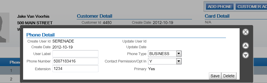

Phone numbers
The phone numbers in CWSerenade map to the soft-coded Telephone types based on the Relate Properties.
Relate automatically creates the Telephone type codes of HOME, BUSINESS, and FAX or MOBILE when it receives a customer from CWSerenade interactively or through the Relate Add or Update Customer Message. In this situation, Relates also adds rows to the CST_PHONE_TYPCODE table for types of WORK, HOME, and FAX or MOBILE in the Relate database if they do not already exist.
Note: Phone number extensions are not mapped between Relate and CWSerenade.
Phone numbers in CWSerenade are stored in the Customer Sold To Phone # table. Any formatting is removed from the phone number before sending to Relate.
Removing a phone number: If you delete a phone number in either Relate or CWSerenade, the system deletes the associated phone number in the other system.
Displaying in Relate: Select Phone. Optionally, highlight a phone number to open the Phone Detail window.
Day
varies
The RELATE_DAY_PHONE_LABEL setting in the Relate Properties file indicates the Telephone Type in Relate that maps to the daytime phone number in CWSerenade; this setting should be set to BUSINESS.
Any trailing spaces are removed from the phone number.
Primary? If there is a daytime phone number, this phone number in Relate is flagged as Primary by default after synchronizing customer information with CWSerenade.
Eve
varies
The RELATE_EVE_PHONE_LABEL setting in the Relate Properties file indicates the Telephone Type in Relate that maps to the evening phone number in CWSerenade; this setting should be set to HOME.
Primary? If there is no daytime phone number, then the evening phone number in Relate is flagged as Primary by default after synchronizing customer information with CWSerenade. Also, if you delete the daytime phone number in CWSerenade, then the evening phone number is flagged as Primary in Relate.
Mbl or Fax
varies
The RELATE_FAX_PHONE_LABEL setting in the Relate Properties file indicates the Telephone Type in Relate that maps to the third phone number in CWSerenade; this setting should be set to FAX or MOBILE.
Note: The Third Phone Number Type (L53) system control value controls whether the third phone number is labeled as the mobile or fax number in CWSerenade.
Primary? If there is no daytime or evening phone number, then the fax/mobile phone number in Relate is flagged as Primary by default after synchronizing customer information with CWSerenade. Also, if you delete the daytime and evening phone number in CWSerenade, then the fax/mobile phone number is flagged as Primary in Relate.
N/A
Contact permission/opt in setting (phone-level)
For the day and evening phone numbers: Y defaults if a corresponding phone number is defined; otherwise N defaults.
If the Third Phone Number Type (L53) system control value is set to FAX:
• N defaults if the Do Not Fax field is selected for the customer.
• Y defaults if the Do Not Fax field is unselected for the customer.
If the Third Phone Number Type (L53) system control value is set to MOBILE: Y defaults if a mobile phone number is defined; otherwise, N defaults.
Email address
In CWSerenade, the primary email address is stored in both the Customer Sold To table and the Customer Sold To Email table. Additional, non-primary email addresses are stored only in the Customer Sold To Email table.
Only the HOME email address that is flagged as primary in Relate is eligible to be included in the integration.
Relate automatically creates an Email type of HOME when it receives a customer from CWSerenade interactively or through the Relate Add or Update Customer Message. In this situation, Relates also adds a row to the CST_EMAIL_TYPCODE table for EMAIL_TYPECODE HOME in the Relate database if it does not already exist.
Displaying in Relate: Select Email. Optionally, highlight the email address to open the Email Detail window.
N/A
Primary
Email address
Email type: HOME
Only the HOME email address that is flagged a primary is eligible to be included in the integration. If the customer has any other email type in Relate, but not a HOME email type, the email address(es) are not passed to CWSerenade.

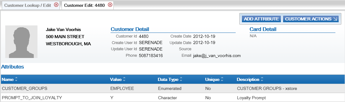

Profile data
In CWSerenade, profile data is stored in the Customer Profile table.
Included in the integration? The Send Profile Data to Relate (L51) system control value controls whether to include demographic profile data when synchronizing customer information.
Required setup: You need to complete the setup described under CWSerenade Customer Profile > Relate Attribute Definition in order to synchronize the information between the systems. Examples are provided below.
Displaying in Relate: Select Attributes.
Profile description
Attribute name
Use the Setting Up Customer Profiles (WPFL) option in CWSerenade to set up the type of demographic information you are capturing, and also use the Attribute Definition screen in Relate to create a corresponding attribute definition for each CWSerenade profile code.
Example: To capture marital status, you can set up:
• CWSerenade : a profile category with a description of MARITAL STATUS
• Relate: an attribute name of MARITAL STATUS and a description of MARITAL STATUS with a data type of Character
Note: The default value defined for the profile code in the Default Male/Female Profile Code (C74) system control value maps to Relate’s gender if the value to pass is M or F.
Profile data description
Attribute value
Use the Setting Up Customer Profiles (WPFL) option in CWSerenade to set up each valid profile data value that you can capture. It is not necessary to set up valid data in Relate; Relate stores the data as a text string.
Example: In the Setting Up Customer Profiles (WPFL) option in CWSerenade, set up profile data options such as:
• Code = M
• Description = MARRIED
Relate stores an attribute value of MARRIED.

Information that is not mapped
• From CWSerenade:
• PO Box
• Delivery code: From the Default Delivery Code for New Order Entry Customers (D13), but you can override this default. Not related to the Address type in Relate, although only addresses with a type of HOME are used as part of the integration.
• Class: From the Default Customer Class in Order Entry (D63), but you can override this default.
• Alternate customer number: However, if a third system, such as the e-commerce site, synchronizes with Relate, then its customer number might also be stored in Relate as an additional alternate key. Also, select the Enable Xstore Alt Key Creation setting in Relate Conflate configuration if the integration to Relate includes CWSerenade and XStore. Selecting this field will assign an XSTORE_ID to the customer if one does not already exist.
• From Relate:
• County: If the county is populated in Relate, this information is cleared when the customer record is synched with CWSerenade.
• Address type: Only the address with a type of HOME is used as part of the integration. If the customer record in Relate does not have a HOME address, then the address you enter for the customer in CWSerenade is created as the HOME address in Relate.
• Email address: Only the email address with a type of HOME is used as part of the integration.
• Class: The Default Customer Class in Order Entry (D63) defaults in CWSerenade.

Phone number extensions: If you add an extension to an existing phone number:
• if you add the extension in CWSerenade, the extension is not added to Relate.
• if you add the extension in Relate, the extension is not added to CWSerenade and is removed when the customer information is resynchronized.

Information used for matching: The SYNCRDB periodic function uses the following information to match customer records between CWSerenade and Relate:
• Relate Id: Relate customer number = Relate Id in the CWSerenade Customer Sold To table
• Customer number: Relate alternate key record whose Alt Key Type matches the RELATE_ALT_ID_SERENADE setting in Working with Customer Properties (PROP) = the CWSerenade customer number
• E-commerce ID: Relate alternate key record whose Alt Key Type matches the RELATE_ALT_ID_WEB setting in Working with Customer Properties (PROP) = the e-commerce site’s customer number. From the ecommerce_id passed in the CWOrderIn message, and saved as the E-commerce ID in the Customer Sold To table only if the order API was unable to synchronize the CWSerenade and Relate customer records
• Primary email address: an email address for the customer in Relate = the customer’s primary email address in CWSerenade

• Must search before creating a customer at CWSerenade screens: Because the Relate customer integration is based on using Relate as the system of record for customers, you need to use the Customer Scan Screen to search for a customer and make sure that the record does not already exist before creating a new record to avoid the possibility of creating a duplicate. Creating the customer without searching first indicates that you want the customer created, regardless of any existing duplicates.
• Relate ID: The Relate customer ID is stored in the CWSerenade Customer Sold To table, but is not displayed on any screens in CWSerenade and is not used to search Relate for a matching customer.
