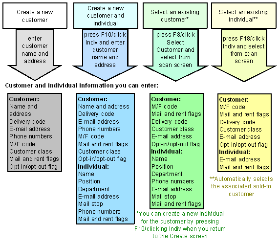

Catalog Request Creation Options
Note: You must have the Enable Catalog Request at Customer Individual Level (H81) system control value selected to enter a catalog request for an individual.
E-commerce catalog requests: If the customer associated with an e-commerce catalog request does not exist, the system will create a new customer; see Customer Creation/Update Logic in E-Commerce Catalog Requests.
Ghost customers: If you enter the customer number of a ghost customer, the system displays the Ghost Customer Warning Window.
Create Catalog Request Screen
Purpose: Use this screen to create a catalog request for a new or existing customer.
How to display this screen: At the Work with Catalog Requests Screen, select Create.
Note: You can also display this screen by selecting Catalog Request from the Select Customer Sold To For Order Screen or at the Customer Selection Screen in Order Entry.
Note: If you are creating a catalog request for an existing customer, do not complete the following fields; instead, select Select Customer to select an existing customer, then complete the Offer, Item, Source, and # of copies fields. See Catalog Request Creation Options for an overview.

Individual updates: If you selected Individual and entered an individual for the sold-to customer, the system creates the new individual for the customer. The individual’s Orig mail type (Original mail type) and Current mail type will be C, the Mail and Rent flags will default from the sold-to customer’s, and the Mail code will default from the Mail flag. If you selected Select Individual to select an existing individual, the system updates the individual’s email address, mail flag, and rent flag if you have changed them.
If the individual you enter already exists: If you selected Individual and entered an individual for the sold-to customer, and the first three positions of the individual’s first name and the first four positions of the individual’s last name match an existing individual for the sold-to customer, you advance to the Display Duplicate Individual Window. You can select the existing individual without update, or create the new individual using the information you just entered.

Enter a catalog request for a new customer
Complete the fields as described under Create Catalog Request Screen. See Catalog Request Creation Options for an overview.
Select an existing customer
Select Customer to advance to the Select Customer for Catalog Request Screen. See Catalog Request Creation Options for an overview.
Note: If the Relate Customer Integration (L37) system control value is set to INTERACT, you advance instead to the Customer Scan Screen. See that screen for more information.
Enter individual customer information
Select Individual to display additional fields for individual customer creation. The Enable Catalog Request at Customer Individual Level (H81) system control value must be selected. See Catalog Request Creation Options for an overview, or see Create Catalog Request Screen for individual field descriptions.
Work with products a customer owns
Select Cust Ownership.
• If the customer is currently associated with customer ownership records, you advance to the Work with Customer Ownership Screen.
• If the customer is currently not associated with customer ownership records, you advance to the Create Customer Ownership Screen.
Select an existing individual customer
Select Select Individual to advance to the Select Customer Individual Screen. The Enable Catalog Request at Customer Individual Level (H81) system control value must be selected. See Catalog Request Creation Options for an overview.
Note: The system does not prevent you from entering a catalog request for an individual whose Status is Inactive.
