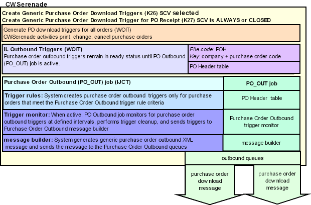

Purchase Order Download Process
The system creates a trigger in the IL Outbound Trigger table when you print a purchase order.
The IL Outbound Trigger table acts as a “to do” list for the purchase order information that requires download.
The PO Outbound (PO_OUT) job in the Working with Integration Layer Processes (IJCT) menu option monitors the IL Outbound table for purchase order download triggers to process, and generates the PO Download XML Message (CWPurchaseOrderOut) to send to the remote system.
API information flow:

Generating the Purchase Order Download Message
To generate a PO Download XML Message (CWPurchaseOrderOut), the PO_OUT process in Working with Integration Layer Processes (IJCT):
• looks for purchase order download triggers with the File code POH and a status of ready (R).
• removes duplicate purchase order download triggers. See Purchase Order Download Trigger Cleanup.
• determines which purchase order to download, based on the Key for the trigger.
• generates the PO Download XML Message (CWPurchaseOrderOut) for each trigger
• changes the status of the trigger to processed (X).

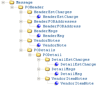

The purchase order download message contains the entire purchase order, including open, closed, and canceled lines.
For more information: See:
• Generic Outbound Purchase Order API for an overview, process flow, and setup information.
• Purchase Order Download Message: Sample XML
• Purchase Order Download Message for Drop Ship: Sample XML
• XML Messages for the DTD and schema, and a generic sample of the PO Download XML message.
• All numeric values with decimal positions are passed as explicit decimals. For example, a dollar value of $10.00 is passed as 10.00.
• Attributes are included in the response only if they contain a value. Blank attributes are not passed.

HeaderEstCharge The HeaderEstCharge element and its attributes repeat for each estimated charge applied to the purchase order header. This element is included only if there are estimated charges for the purchase order header. See Defining Estimated Charges for an overview. |
charge_code |

HeaderFOBAddress The HeaderFOBAddress element and its attributes repeat for each FOB address entered for the purchase order header or that defaulted from the vendor. This element is included only if there are any FOB addresses for the purchase order. See Work with FOB for Purchase Order Screen for an overview. |
seq_nbr |

HeaderMsg The HeaderMsg element and its attributes repeat for each header message that is flagged to print on the purchase order, receiving worksheet, or both. This element is included only if there are any header messages flagged to print for the purchase order. See Work with PO Messages Screen for an overview. |
seq_nbr |

VendorNote The VendorNote element and its attributes repeat for each vendor note that is flagged to print. This element is included only if there are any vendor notes flagged to print. See Work with Vendor Notes Screen for an overview. |
seq_nbr |

PODetail The PO Detail element and its attributes repeat for each line item on the purchase order. |
line_nbr |
A sample of the PO Download XML Message (CWPurchaseOrderOut) is presented below.
<Message source="CWSerenade" target="CWIntegrate" type="CWPurchaseOrderOut" date_created="06122009" time_created="07:32:12" transaction_type="A">
<POHeader company="3" company_desc="R&D" po_nbr="774" vendor_nbr="10001" vendor_name="SUPPLIES UNLIMITED" vendor_address1="100 MAIN STREET" vendor_city="READING" vendor_state="MA" vendor_zip="01867" vendor_country="USA" vendor_phone_nbr="(781)438-0349" vendor_fax_nbr="(888)777-6666" vendor_email_address="ksose@commercialware.com" due_date="09092009" entry_date="06122009" print_date="06122009" promise_date="07072009" offer_id="001" offer_desc="SPRING 2010" buyer="EMP" buyer_desc="EVA PREISINGER" cancel_date="08082009" account_nbr="31111" currency_rate="1.0000000" revised_date="06122009" extracted_flag="Y" recurring_po="N" sts_desc="Open" apt_code="15" apt_code_desc="END OF MONTH" confirm_po="N" negotiate_price="N" ship_via="1" ship_via_desc="BEST WAY" ship_to_address1="1800 WEST PARK DRIVE" ship_to_city="WESTBOROUGH" ship_to_state="MA" ship_to_state_desc="MASSACHUSETTS" ship_to_zip="01581" ship_to_country="USA" ship_to_day_phone="(781)555-7655" placed_name="LOUISE" shipping_instruction="CUSHIONED PACKAGING" print_worksheet="N" currency_code="USA" currency_desc="United States Dollars" po_type="I" po_type_desc="initial buy" whs="1" whs_desc="NORTHEAST WAREHOUSE">
<HeaderFOBAddresses>
<HeaderFOBAddress seq_nbr="1" fob_type="D" fob_type_descr="Destination" freight_terms="100" city="FRAMINGHAM" state="MA" zip="01701" country="USA" />
<HeaderFOBAddress seq_nbr="2" fob_type="O" fob_type_descr="Origin" freight_terms="ARRIVAL" city="READING" state="MA" zip="01867" country="USA" />
</HeaderFOBAddresses>
<VendorNotes>
<VendorNote seq_nbr="1" print="Y" entry_date="06122009" message="Please take care when packing liquids in containers " />
<VendorNote seq_nbr="3" print="Y" entry_date="06122009" message="Tape caps and use sealed plastic bags" />
</VendorNotes>
<PODetails>
<PODetail line_nbr="1" item_nbr="1780" item_desc="SUNGLASSES" discount_override="N" whs="1" whs_desc="NORTHEAST WAREHOUSE" vendor_price="7.0000" price="7.0000" vendor_order_qty="100" price_method_desc="Vendor Item Price" vendor_item="VND1780" vendor_item_desc="SUNGLASSES & TINT RIM'S" seq_nbr="1" vendor_unit_measure="EA" vendor_unit_measure_desc="EACH" vendor_price_curtype="S" vendor_price_curtype_desc="System Currency" order_qty="100" promise_date="07072009" due_date="09092009" account_nbr="31111" vendor_nbr="10001" inventory_item="Y" sts_desc="Open" entry_date="06122009" ship_via="1" ship_via_desc="BEST WAY" cancel_date="08082009" offer_id="001" offer_desc="SPRING 2006" unit_measure="EA" unit_measure_desc="EACH" buyer="EMP" buyer_desc="EVA PREISINGER" />
<PODetail line_nbr="2" item_nbr="7890" item_desc="LOGO T" discount_override="N" whs="1" whs_desc="NORTHEAST WAREHOUSE" vendor_price="5.0000" price="5.0000" vendor_order_qty="48" price_method_desc="Vendor Item Price" vendor_item="VND7890 TALL" vendor_item_desc="TALL LOGO T" seq_nbr="2" vendor_unit_measure="EA" vendor_unit_measure_desc="EACH" vendor_price_curtype="S" vendor_price_curtype_desc="System Currency" order_qty="48" promise_date="07072009" due_date="09092009" account_nbr="31111" vendor_nbr="10001" inventory_item="Y" sts_desc="Open" entry_date="06122009" ship_via="1" ship_via_desc="BEST WAY" cancel_date="08082009" sku_code="TALL" sku_desc="LOGO SHIRT TALL" offer_id="001" offer_desc="SPRING 2010" unit_measure="EA" unit_measure_desc="EACH" buyer="EMP" buyer_desc="EVA PREISINGER">
<VendorItemNotes>
<VendorItemNote seq_nbr="1" print="P" message="Please check ink color" />
<VendorItemNote seq_nbr="2" print="W" message="Confirm ink color on delivery" />
<VendorItemNote seq_nbr="4" print="B" message="Ink color on logo" />
</VendorItemNotes>
</PODetail>
</PODetails>
</POHeader>
</Message>
A sample of a drop ship PO Download XML Message (CWPurchaseOrderOut) is presented below.
<Message source="CWSerenade" target="CWIntegrate" type="CWPurchaseOrderOut" date_created="06122009" time_created="08:17:04" transaction_type="A">
<POHeader company="3" company_desc="R&D" po_nbr="776" vendor_nbr="10001" vendor_name="SUPPLIES UNLIMITED" vendor_address1="100 MAIN STREET" vendor_city="READING" vendor_state="MA" vendor_zip="01867" vendor_country="USA" vendor_phone_nbr="(781)438-0349" vendor_fax_nbr="(888)777-6666" vendor_email_address="ksosecommercialware.com" due_date="06122009" entry_date="06122009" print_date="06122009" promise_date="06122009" offer_id="001" offer_desc="SPRING 2010" account_nbr="31111" currency_rate="1.0000000" extracted_flag="Y" recurring_po="N" sts_desc="Open" apt_code="15" apt_code_desc="END OF MONTH" confirm_po="N" negotiate_price="N" ship_via="1" ship_via_desc="BEST WAY" order_nbr="5030" ship_to_nbr="1" ship_to_fname="ELIZABETH" ship_to_lname="CHURCHILL" ship_to_company="ORANGE CHURCH" ship_to_address1="694 HAVERHILL STREET" ship_to_apartment="APT 177" ship_to_city="FRAMINGHAM" ship_to_state="MA" ship_to_state_desc="MASSACHUSETTS" ship_to_zip="01701" ship_to_country="USA" ship_to_email_address="myemailaddress@msn.com" shipping_instruction="DRP SHP ORD#00005030" print_worksheet="N" currency_code="USA" currency_desc="United States Dollars" po_type="I" po_type_desc="initial buy">
<PODetails>
<PODetail line_nbr="1" item_nbr="NBC1001" item_desc="CLUB CHAIR" discount_override="N" vendor_price="33.0000" price="33.0000" vendor_order_qty="1" price_method_desc="Item Standard Cost" seq_nbr="1" vendor_price_curtype="S" vendor_price_curtype_desc="System Currency" order_qty="1" promise_date="06122009" due_date="06122009" account_nbr="31111" vendor_nbr="10001" inventory_item="Y" sts_desc="Open" entry_date="06122009" ship_via="1" ship_via_desc="BEST WAY" offer_id="001" offer_desc="SPRING 2010 unit_measure="EA" unit_measure_desc="EACH" />
</PODetails>
</POHeader>
</Message>
