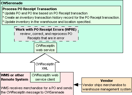

PO Receipt In information flow: This flowchart explains how PO receipt information is uploaded into CWSerenade.

Purchase Order Receipt In Process
1.
The warehouse management system receives a partial or full receipt of a PO or PO line.
2.
For each PO line received, the warehouse management system sends a PO Receipt In XML Message (CWReceiptIn) to CWSerenade via the CWReceiptIn Web Service.
Note: A separate PO Receipt In XML Message (CWReceiptIn) must be sent to CWSerenade for each PO line received.
3.
The CWReceiptIn Web Service determines if the PO Receipt In XML Message (CWReceiptIn) is a valid XML message; see Invalid XML?.
4.
If the PO Receipt In XML Message (CWReceiptIn) is a valid XML message, CWSerenade receives the PO Receipt In XML Message (CWReceiptIn) from the warehouse management system, and:
• Determines the PO to receive; see Determining the Purchase Order to Receive.
• Determines the item/SKU to receive; see Determining the Item and SKU to Receive.
• Determines the quantity of the item/SKU to receive; see Determining the Quantity to Receive.
• Determines the location and warehouse where the item/SKU should be placed; see Determining the Receipt Warehouse and Location.
5.
If CWSerenade successfully processes the PO Receipt In XML Message (CWReceiptIn), the system updates the PO and the inventory information in the location and warehouse where the item/SKU was placed. See Successful PO Receipts.
If CWSerenade cannot successfully process the PO Receipt In XML Message (CWReceiptIn), the system places the message in an error status. See Failed PO Receipts.
