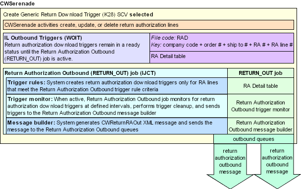

Purpose: CWSerenade allows you to send created return authorization information and completed return and exchange information to another system, such as a warehouse management system.
Outbound return information flow: This flowchart explains how return information is downloaded from CWSerenade.

Generic Return Out Download Process
The system creates return authorization download triggers in the Working with Outbound Interface Transactions (WOIT) menu option when a return authorization is created, changed, or deleted, based on the trigger rules defined for the Return Authorization Download (RETURN_OUT) integration layer job. The Return Authorization Outbound (RETURN_OUT) job in the Working with Integration Layer Processes (IJCT) menu option monitors the Working with Outbound Interface Transactions (WOIT) menu option for return authorization download triggers to process and generates a Return Authorization Outbound XML Message (CWReturnRAOut) to send to the remote system.
• Identifying Return Authorization Download Triggers
• When are Return Authorization Download Triggers Created?
• Return Download Processing
• Return Authorization Outbound Trigger Activities
• Return Authorization Outbound Trigger Rules
• Return Authorization Trigger Cleanup

To generate a Return Authorization Outbound XML Message (CWReturnRAOut), the system:
1.
During certain activities (see Return Authorization Outbound Trigger Activities), evaluates the trigger rules defined for the Return Authorization Outbound (RETURN_OUT) job to determine if the return authorization download (RAD) trigger is created. The Return Authorization Outbound Trigger Rules for the Return Authorization Outbound (RETURN_OUT) job define the criteria the return authorization must meet in order for the system to create a return authorization download trigger.
2.
When active, the trigger monitor defined for the Return Authorization Outbound (RETURN_OUT) job looks for unprocessed return authorization download triggers to process at defined intervals, based on the Outbound delay time.
The Return Authorization Outbound trigger monitor:
• Looks for return authorization download triggers with the File code RAD and a status of ready (R).
• Removes duplicate return authorization download triggers. See Return Authorization Trigger Cleanup.
• Determines which return authorization to download, based on the return authorization download trigger Key. The Key field for return authorization download triggers consists of company code, order number, ship to number, return authorization number, and return authorization line number. For example, the Key 00700001446001001001 indicates the return authorization download information is located in company 7 for order number 1446, ship to number 1, return authorization number 1, and return authorization line number 1.
• Sends the generated return authorization download message to the queues defined for the Return Authorization Outbound (RETURN_OUT) job that are active (the Enabled field is selected).
