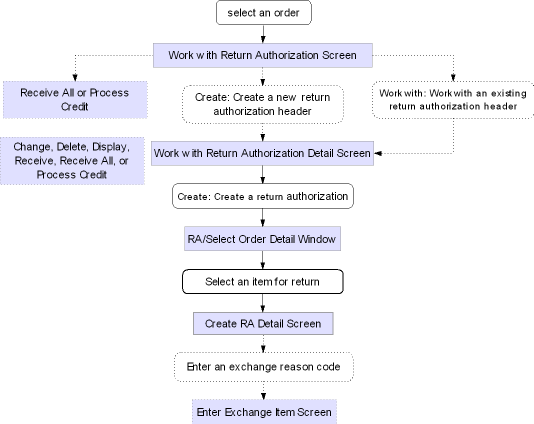

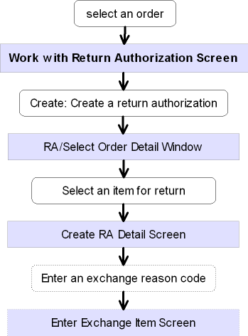

Screen Flow
When you are creating the first return authorization for an order:
When there is already a return authorization for the order:

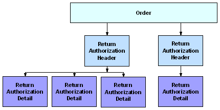

Order/header/detail structure: The relationship between the order and return authorization header and detail is illustrated in the chart below.
Each return or exchange of an item (detail record) must be associated with a header and an order. However, each order can have any number of return authorization headers, and each header can have any number of detail records.

Select Receive line for a return authorization line to advance to the Receive RA Items Screen (Receiving Detail).
Create a return authorization
Select Create to display the R/A Select Order Detail Pop-Up Window.
Receive all lines
Select Receive All to receive all unreceived items on the return authorization. See Receiving All Returns.
You cannot use this option to send return information to CWCollaborate. Instead, select Receive line for each item on the return.
Processing returns through the integration with Locate’s Drop Ship Manager module is not currently implemented.
Accept your entries
Select Accept. See Accepting or Rejecting Your Entries.
Note: Accepting entries on the Work with Return Authorization Detail screen is a final accept; if you reject entries on the Work with Return Authorizations Screen, the system will not reject the entries that you accepted on the Work with Return Authorization Detail screen. For example, if you receive an RA on the Work with Return Authorization Detail screen and then select Reject on the Work with Return Authorizations Screen, the RA will remain in a received status.
Reject your entries
Select Reject. See Accepting or Rejecting Your Entries.
Process return authorization credit
Select Process Credits to advance to the Process RA Credits Screen.
Create a tickler for the order, sold to customer on the order, and/or bill to customer on the order
Select Create tickler to advance to the Create Tickler Screen.
Note: To create a MN tickler, you must have authority to the Create Manual Tickler (B13) secured feature.
Purpose: This window lists all lines on the order that are eligible for return and do not currently have a return authorization in process. Use this window to select an order line for the return authorization.
How to display this window: Select Create at the Work with Return Authorization Detail Screen.

Select an item: You can select an item for return by Selecting it. You advance to the Create RA Detail Screen, where you can enter a return authorization for the selected item.
If there are no items on the order eligible for return, select Exit to advance to the Create RA Detail Screen (Processing Misships).
Purpose: Use this screen to enter the detail information you need to create a return authorization.
How to display this screen: Select an item at the R/A Select Order Detail Pop-Up Window. See Create RA Detail Screen (Processing Misships) if you selected Exit at the RA/Select Order Detail pop-up window to create a misship return.

RA number (Return authorization number)
A number representing the return authorization header. This number consists of the order number, ship to number, and return authorization number.

Return authorization number: numeric, 3 positions; display-only.
Line #
A number that identifies the line on the return authorization header.
Numeric, 3 positions; display-only, assigned by the system.

Enter Exchange Item Screen
Purpose: Use this screen to enter an exchange item and quantity for the returning merchandise.
How to display this screen: You advance to this screen when you enter an exchange reason code on the Create RA Detail Screen if the Require Exchange Item at Time of Receipt (F42) system control value is selected; otherwise, you advance to this screen at the time you receive the return. You can also display this screen through the Receiving Returns (WRAR) menu option.
