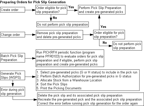

Preparing Orders for Pick Slip Generation
Pick slip preparation prepares an order for fulfillment when you create or change an order, such as creating pre-generated picks in the Pick Control Header and Pick Control Detail tables and defining whether the pre-generated picks require authorization. Preparing the order for pick slip generation in advance reduces the time it takes to run Streamlined Pick Slip Generation (WSPS) to fulfill and print the picking documents.
Pre-generated picks are picks created prior to running pick slip generation for an order. The status of a pre-generated pick is either G Generated No Authorization, indicating the pick requires authorization during pick slip generation, or H Generated Has Authorization, indicating the pick can bypass authorization during pick slip generation. Pick slip generation selects pre-generated picks to fulfill and print based on the pick slip selection criteria specified.
Pick slip preparation process:

When is Pick Slip Preparation Performed?
The system performs pick slip preparation when:
• An order is created; see Pick Slip Preparation when an Order is Created.
• A user or the system updates an order; see Pick Slip Preparation when an Order is Maintained.
• Pick slip generation (WSPS) cannot generate a pick slip; see Pick Slip Preparation when Pick Slips are not Generated (WSPS).
The system performs pick slip preparation when an order is created; see Applying Pick Slip Preparation to an Order for the updates that are performed.
Pick Slip Preparation...
applied to an order when:
Entering Orders (OEOM)
The system performs the final order accept. If the order contains multiple recipients, the system does not perform pick slip preparation until you accept the last order ship to on the order.
Generic Order Interface (Order API)
CWSerenade receives the order through the Generic Order Interface (Order API) and it is not placed in an error status. Pick slip preparation occurs after the system generates the Order Response.
Entering Batched Orders
You select to Accept or Edit/Accept the order batch. The system performs pick slip preparation only for orders that are accepted in the order batch.
Generating Membership Orders (EGMO)
CWSerenade generates a membership order.
Working with Retail Store Restock (WRSR)
You submit an Actual Store Restock to create retail store restock orders.
The system performs pick slip preparation when a user or the system updates an order. In this situation, the system performs the following updates.
1. The system REMOVES any pick slip preparation from the order; see Removing Pick Slip Preparation from an Order for the updates that are performed.
2. Once the changes to the order have been made, the system EVALUATES the order to determine if it is eligible for pick slip preparation.
3. If the order is eligible for pick slip preparation after the changes to the order have been made, the system RE-APPLIES pick slip preparation to the order; see Applying Pick Slip Preparation to an Order for the updates that are performed.

Batch Pick Slip Preparation
The PICKRFH Pick Gen Refresh periodic function (program name PFR0103) allows you to submit a process that evaluates orders for pick slip preparation, and if eligible:
1. Removes any pick slip preparation that may have already occurred for the order; see Removing Pick Slip Preparation from an Order for the updates that are performed.
2. Applies pick slip preparation to the order; see Applying Pick Slip Preparation to an Order for the updates that are performed.
Use this periodic function to:
• Initially prepare existing orders for pick slip generation; see Converting Orders to Pick Slip Preparation.
• Perform pick slip preparation for orders that initially were not eligible for pick slip preparation (for example, the order had a future arrival date).
See How to Schedule a Job for instructions on assigning this periodic function to a periodic process and to schedule when the process runs. MICROS recommends you run this periodic function on a daily basis.
For orders that qualify for pick slip preparation, the system performs the following updates.
• Creates Pre-Generated Picks
• Updates Reserved Order Lines for the Order
• Updates Authorizations for the Order
For more information: See Selecting Order Lines for Pick Slip Preparation and When is Pick Slip Preparation Performed? for more information on determining when an order line is eligible for pick slip preparation, and when the system performs pick slip preparation.

Creating Pre-Generated Picks
Pick Slip Preparation creates pre-generated picks in the Pick Control Header and Pick Control Detail tables when an order is created or changed. You can review pre-generated picks on the Display Pick Tickets for Order Screen.
• Pick Control Header Updates for Pre-Generated Picks
• Pick Control Detail Updates for Pre-Generated Picks
The system REMOVES any pick slip preparation that may have already occurred when you or the system changes an order; see When is Pick Slip Preparation Performed? to review when the system removes pick slip preparation from an order.
The system:
• Deletes the pre-generated picks for the order in the Pick Control Header, Pick Control Detail, Pick Control Label, and Pick Stored Value Card tables that are in a G Generated No Authorization or H Generated Has Authorization status, across all order ship tos.
• Resets the Qty printed and Qty remaining fields for the order in the Reserved Order Lines table.
• If pick slips have not been generated for the order and the order contains an online authorization:
• Retains records for the order in the Authorization History table that are in a status other than G Generated.
• Updates the Amount authorized in the Order Payment Method table to 0.00.
• Creates a record in the Void Auths table for the amount authorized in the Authorization History table.
• If pick slips have not been generated for the order and the order contains a manual authorization:
• Deletes records for the order in the Authorization History table that are in a G Generated status (the system retains records in any other status).
• Removes any message for the order in the Order Transaction History table regarding a manual auth detected.
• Restores any manual authorization information for the order in the Order Payment Method table.
• Deletes any records for the order payment in the Void Auths table.
Note: After removing pick slip preparation from an order and updating the order with any changes, the system evaluates the order to determine if it is eligible for pick slip preparation, and if it is, the system RE-APPLIES pick slip preparation to the order; see Pick Slip Preparation when an Order is Maintained.

110.00
TST1
today’s date
Updates the Order Payment Method:
• Removes the Authorization date, Authorization number, and Manual authorization amount.
• Updates the Amount authorized with the authorization amount.
Creates a Void Auths record for 10.00 since the authorization amount (110.00) is greater than the order total (100.00).
Pick slip generation: When you process pick slip generation for the order, the system:
• Assigns a billing batch number to the pick.
• Updates the Date updated to the date when pick slip generation is run.
• Updates the Date printed to the date when pick slip generation is run.
• Updates the Status of the pick from H Generated Has Authorization to 2 Authorized.
• Skips batch authorization for the pick.
• Determines which item/locations to reserve stock from in order to fulfill the quantity required for the pick; see Allocating Stock.
• Sorts the picks so that they generate and print in the correct order. The sort also determines when the system creates a new pick slip PDF document for the picks in the pick slip generation run. See Sorting Pick Slips into Separate PDF Documents and Pick Slip Sort within a Pick Slip PDF Document.
• Groups the picks into documents for printing; see Generating and Printing Pick Slips.
