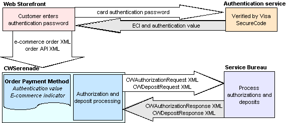

Credit Card Authentication Service
Credit card authentication services help to reduce fraud and chargeback volume on card not present transactions by requiring the cardholder to enter a card authentication password on the web storefront. The authentication password is sent to an authentication service, such as Visa’s Verified by Visa program or MasterCard’s SecureCode program, to verify the cardholder’s identify and ownership of the credit card during the online purchase.
Which credit cards? Authentication processing is available for the following credit cards:
• Visa, using the Verified by Visa (CAVV) program.
• MasterCard, using the SecureCode (AAV) program.
Which service bureaus? Credit card authentication is available when processing authorizations and deposits using the Paymentech service bureau.
Credit card authentication process:

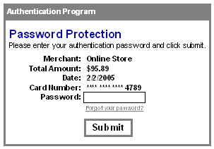

1.
At the payment screen on a web storefront, the customer is prompted to enter a card authentication password.
2.
The web storefront sends the card authentication password to the authentication service.
3.
The authentication service validates the password and sends back an electronic commerce indicator (ECI) and an authentication verification value.
• The electronic commerce indicator (ECI) indicates the level of security provided for a credit card transaction placed over the internet.
• The authentication verification value (CAVV for Visa or AAV for MasterCard) indicates whether the password the cardholder provided was approved for the credit card.
4.
The web storefront sends the order to CWSerenade in the Inbound Order XML Message (CWORDERIN).
5.
CWSerenade creates the order and:
• updates the E-Commerce indicator field in the Order Payment Method table with the electronic commerce indicator.
• updates the Authentication value field in the Order Payment Method table with the authentication value.
6.
During authorization and deposit processing, CWSerenade sends the e-commerce indicator and authentication value associated with the credit card to the service bureau in the Authorization Request XML Message (CWAuthorizationRequest) and Deposit Request XML Message (CWDepositRequest).
Authentication verification value format: In order for the service bureau to process the authentication value correctly, the authentication verification value returned from the web storefront must be in the correct format.
The Paymentech service bureau requires the authentication value to be Base 64 encoded. Base 64 is a cryptographic value derived with an algorithm that encrypts the credit card authentication data for security.
CWSerenade will not format the authentication verification value it receives from the web storefront.
7.
The service bureau sends an authentication response back to CWSerenade in the Authorization Response XML Message (CWAuthorizationResponse) and Deposit Response XML Message (CWDepositResponse). However, the response is not stored in any CWSerenade table.
