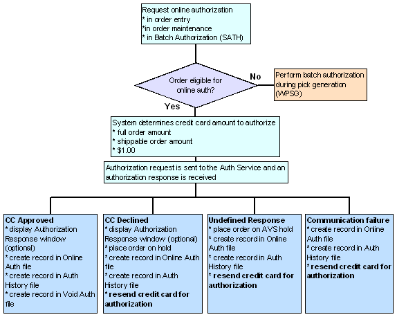

Receiving a Credit Card Authorization During Order Entry
The system performs on-line authorization when you select Accept to accept an order after determining if the order should go on hold due to the credit card payment method.
Generic order interface: If you receive orders through the Generic Order Interface (Order API), the system performs online authorization after determining if the order should go on hold and performing credit card tokenization; see Performing Online Credit Card Authorization on Web Orders.
Batch order entry: If you are using batch order entry, the system performs on-line authorization when you accept a batch at the Work with Order Batches Screen or Select Customer Sold to for Order Screen.
Order maintenance: The system performs on-line authorization when you select Auth On-Line for a credit card payment on the Enter Payment Methods Screen.
When you convert a quote to an order in order maintenance, the system will perform online authorization for eligible payment methods only if the Authorize Full Amount During Order Entry (G99) system control value is selected; see Converting Quotes to Orders.
1. The system determines if the order is eligible for on-line authorization. In order to receive a credit card authorization during order entry:

If more than one credit card is sent for authorization:
The system sends for authorization the credit card defined with a dollar amount, then sends the catch-all credit card for authorization.
Credit cards requiring authorizations less than $1.00: If the credit card amount to authorize is less than $1.00 and you have defined an authorization number in the Authorization Number for Authorizations Under $1.00 (I08) system control value, the system does not send the credit card to the service bureau for authorization and instead assigns the authorization number from the system control value to the credit card. If an authorization number is not defined in this system control value, the system sends the credit card to the service bureau for authorization, regardless of the amount that requires authorization.
3. The system sends the authorization amount to the service bureau. If there is an amount to authorize for the credit card, the system sends an authorization request in online format to the service bureau via a CWIntegrate site.
See Processing Authorizations and Deposits using CWIntegrate for more information on communicating with a service bureau via CWIntegrate and see Processing Authorizations and Deposits Using Point-to-Point Communication for more information on communicating with a service bureau directly.
4. The service bureau sends back a response. The service bureau sends an authorization response to CWSerenade.
There are 3 types of responses you can receive from the service bureau.
• R = an authorization response is received, such as declined or approved
• T = the program timed out before an authorization response was received
• U = an undefined response
Additionally, if an authorization response is received, the service bureau sends back an authorization response code, AVS response code (if performing address verification), CID response code (if performing credit card identification verification), authorization code, and date.
Vendor response settings: If a pop up window message has been defined for the vendor response received, the system displays the Select Authorization Response Option Window. Also, if a hold reason code has been defined for the vendor response received, the system places the order on hold.
Relate stored value cards: When using the Relate Stored Value Card Integration, if the Relate stored value card is the only payment on the order and the amount authorized for the card is less than the order total, CWSerenade updates the amount for the card with the amount authorized and displays the message Insufficient balance on card - please add another payment. In order to accept the order, you must add another payment to the order to cover the amount of the order that is not covered by the Relate stored value card. Example: If the order total is 500.00 and the amount authorized for the Relate stored value card is 236.20, the system updates the amount for the card to 236.20 and requires another form of payment to cover the remaining 289.55 balance on the order.

What Happens When a Credit Card is Approved?
When a credit card is approved during order entry, the system:
• during order entry, displays the Select Authorization Response Option Window if a vendor response pop up window message has been defined, the On-line authorization field for the order type is set to Window (on-line eligible and display window), and a Response time is defined for the service bureau. The message should indicate the credit card has been approved. From this window, you can accept the order or return to the order to make any corrections. If a credit card has been approved, you should accept the order.
• places the order on hold if a hold reason code has been defined for the vendor response. Typically, if an authorization is approved, the order is not placed on hold. However, if the credit card is approved but fails address verification or card identification verification, you may want to place the order on hold.
• once you accept the order, you return to the Select Customer Sold To For Order Screen, or the Customer Selection Screen if you are a CTI user.
• processes any end-of-order updates and sends the order to the Order Async.
• creates a record in the On-Line Authorization table indicating the order number, that the credit card has been approved, the dollar amount authorized, the transaction sequence number, and the authorization number. The status for this authorization is *UPDT, indicating the on-line authorization has completed.
• creates a record in the Authorization History table indicating the credit card has been approved, the authorization number, the date the credit card was authorized, and the dollar amount authorized. If you reject an order after the credit card has been approved, the system removes the record in the Authorization History table. You can review authorization history at the Display Authorization History Screen.
• creates a record in the Void Authorization table indicating the order number and the dollar amount eligible for void. If you reject an order after the credit card has been approved, the system removes the record from the Void Authorization table.

What Happens When a Credit Card is Declined?
When a credit card is declined during order entry, the system:
• displays the Select Authorization Response Option Window if a vendor response pop up window message has been defined, the On-line authorization field for the order type is set to Window (on-line eligible and display window), and a Response time is defined for the service bureau. The message should indicate the credit card has been declined and any action you should take to correct the decline or inform the customer. From this window, you can accept the order or return to the order to make any corrections.
• places the order on hold: If a hold reason code is defined for the vendor response, the system assigns this hold reason code to the order payment method and places the order header on AT (Declined Credit Card) hold. If the response received is not defined for the service bureau, the system places the order payment method on AV (Invalid Response Code) hold.
• once you accept the order you return to the Select Customer Sold To For Order Screen, or the Customer Selection Screen if you are a CTI user.
• creates a record in the On-Line Authorization table indicating the order number, that the credit card has been declined, the dollar amount submitted for authorization, and the transaction sequence number. The status of this authorization is *UPDT, indicating the on-line authorization has been completed.
• creates a record in the Authorization History table indicating the credit card has been declined, the reason why the credit card was declined, the date the credit card was declined, and the dollar amount submitted for authorization. If you reject the order after the credit card has been declined, the system removes the record from the Authorization History table. You can review authorization history at the Display Authorization History Screen.
You can send the credit card up for authorization again during order maintenance, using the Performing Batch Authorization (SATH) menu option, or during pick slip generation if the Batch/on-line field for the service bureau contains a C (on-line and batch authorizations).
When Communication Failures Occur
Communication failures can occur if the system times out before a response is received. If communication failures occur and you do not receive a response from the service bureau, the system:
• does not display the Select Authorization Response Option Window since a vendor response was not received.
• accepts the order and returns you to the Select Customer Sold To For Order Screen, or the Customer Selection Screen if you are a CTI user.
• creates a record in the On-Line Authorization table. The status of this authorization is:
• *RDY, indicating on-line authorization has not been performed.
• *SENT, indicating the on-line authorization transmission failed after the credit card was sent to the service bureau for authorization.
• *RCVD, indicating the on-line authorization transmission failed after a response was received from the service bureau, but final updates could not be completed. This may occur if the Online Authorization integration job became inactive. The authorization does not complete processing until the job is active. Once the Online Authorization integration job is active, the system updates the status of the authorization to *UPDT.
• creates a record in the Authorization History table indicating the credit card is waiting for authorization, the date the credit card was sent for authorization, and the dollar amount waiting for authorization.
The amount of time the system waits for an authorization is defined in the Response time field for the service bureau.
Grace period: The system allows a 2 day grace period to receive a response from the service bureau if the status of the authorization is *RDY, *SENT, or *RCVD. To determine the grace period, the system takes the current date - the authorization sent date to determine the number of days. Once the 2 day grace period is passed, the system declines the transmission. You will need to resend the credit card for authorization during order maintenance or pick slip generation.
What Happens When an Undefined Response is Returned?
When an undefined response is returned, the system:
• does not display the Select Authorization Response Option Window since this vendor response has not been defined for the service bureau.
• places the order on AVS hold.
• creates a record in the On-Line Authorization table indicating the order number, that the credit card is waiting for authorization, the dollar amount waiting for authorization, and the transaction sequence number. The status of this authorization is *RDY, indicating on-line authorization has not been performed.

On-line Authorization Process

Number Assignment Value
The number assignment Transaction Sequence # assigns the next available number to the credit card authorization.
Service Bureau Settings
When you are setting up a service bureau to support on-line authorization, please note these required settings:
• Industry code: enter your DBA number.
• Batch/on-line: set to I (on-line) to perform only on-line credit card authorizations; set to C (on-line or batch) to perform both on-line credit card authorizations and batch credit card authorizations.
• Response time: set the number of seconds the system waits to receive a response from the service bureau before continuing to process the order.
• Pay type cross reference (Paytypes at the Work with Authorization Services Screen): Create a cross-reference for each pay type code for which you wish to receive on-line credit card authorization, using the vendor pay code information supplied by the service bureau.
• Currency cross reference (Currency at the Work with Authorization Services Screen): Create a cross-reference for each currency code you will use on orders receiving on-line credit card authorizations, using the vendor currency code information supplied by the service bureau.
• Vendor responses (Responses at the Work with Authorization Services Screen): Optionally, you can define Vendor response pop up window messages. The messages display in a pop up window in order entry when a credit card that was sent up for authorization is declined. You can enter up to four 40-position lines of message text. Set up vendor responses for authorizations, AVS (if you are performing address verification), and CID (if you are performing credit card identification).
