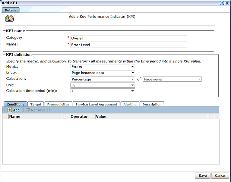

To create a KPI and, optionally, use it as the basis for alerts and service levels, do the following:
Select Configuration, then Service level management, then select KPIs, and click the New KPI button. The dialog shown in Figure 8-1 appears.
Figure 8-1 Add Key Performance Indicator (KPI)
Specify a Name and Category for the monitored KPI. If you specify a new category name, this category is automatically created.
Use Metric, Entity, Calculation and Unit fields to define the KPI, noting the following:
Depending on what you choose as the metric, you may not be required to specify values for the other fields.
Calculations might require multiple inputs. For example, if you selected the Page load time (sec) metric, you need to specify the user flow to which it refers. If the required option is not in the displayed list, you can click the Search icon to locate it.
See Section E.2, "KPI Metrics" for more information on metrics.
After saving the KPI definition, you cannot edit these fields at a later time.
Specify the Calculation time period (min) for the KPI. This can be a value between 1 and 15 minutes and can be edited later.
All KPI values are calculated every minute. This setting determines a time window for calculating a KPI value, for example if you choose average page load-time as the KPI and set the calculation time period to 5 minutes, the KPI is updated every minute using an average load-time for the previous 5 minutes.Enter a short description of the KPI into the field on the Description tab. The other tabs are described in the following sections:
Section 8.2.1, "Applying a Condition to a KPI" allows you to add filters to the KPI.
Section 8.2.2, "Applying Target Values to a KPI" allows you to define a minimum and maximum range for the KPI, and how the target should be calculated.
Section 8.2.3, "Applying a Prerequisite to a KPI" allows you to add additional requirements for the selected metric. Using this facility, you can build compound KPIs
Section 8.2.4, "Applying a Service Level Agreement to a KPI" allows you associate a KPI with an SLA. If so, you can configure the level of your committed agreement (in percentage terms) for specific time periods.
Section 8.2.5, "Applying an Alert Schedule to a KPI" allows you associate an alert with a KPI. If so, you need to define the length of time that the KPI is non compliant before an alert is issued.
Click Save.

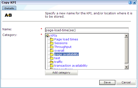

In addition to creating new KPIs from scratch, as explained in Section 8.2, "Defining KPIs and SLAs", you can also create a copy of an existing KPI, and use it as the basis for your new KPI. This is particularly useful when the new KPI is very similar to an existing one. For example, you already have an existing KPI that monitors user flow availability in the USA, but now want to create a new one for Canada. To use an existing KPI as the basis for a new one, do the following:
Select Configuration, then Service level management, then KPIs, and right click on the required KPI from the displayed listing. Select Copy from the menu. The dialog shown in Figure 8-2 appears.
Specify a new name and location for the new KPI. Optionally, click Add category to create a new category. When ready, click Save.
Use the procedure described in Section 8.3, "Modifying Existing KPIs" to modify the new KPI to meet your requirements.

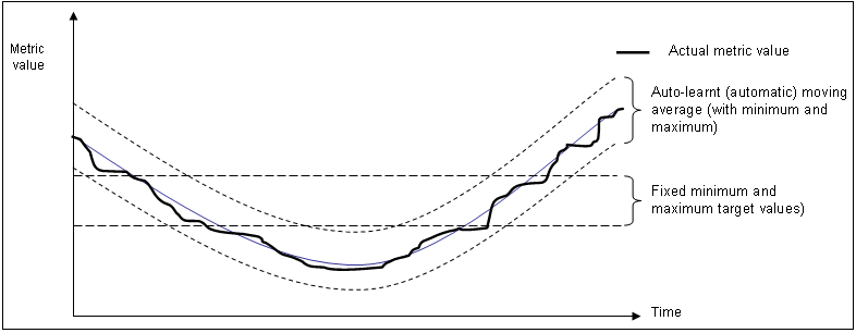

As mentioned earlier, you can specify a KPI should use automatic (or auto-learnt) targets (see Section 8.2.2, "Applying Target Values to a KPI"). Typically, visitor traffic and usage patterns can differ widely during the course of a day, for example, the number of visitors might be lower during the night than during the afternoon, or on certain days compared to others.
To accurately reflect this in the automatic target calculation, RUEI uses an evaluation algorithm that works as follows:
First, the minimum and maximum targets for a given 1-minute period are always computed from data within a sampling window around that period. This ensures that any generic trend in the value fluctuation around that specific period is taken into consideration.
Next, RUEI also looks at the data from the same sampling period over a number of previous days. This ensures that a daily trend in the value fluctuation around that specific period is also considered, for example, if the overall number of visitors at 11am each day increases as the week progresses.
The size of the sampling window, and the number of previous days to use are specified by the KPI threshold profile that has been assigned to the KPIs. Defining a threshold profile is described in Section 12.13, "Defining KPI Threshold Profiles", and assigning a threshold profile to a KPI is described in Section 8.2.2, "Applying Target Values to a KPI".
In contrast, a fixed KPI target essentially represents, either minimum or maximum, a straight line. This is shown in Figure 8-3.
Figure 8-3 Automatic and Fixed KPI Targets Contrasted
When using auto-learnt targets, be aware of the following points:
It requires a full day before the auto-learnt targets become available. Clearly, the more days of historical data that are available, the more reliable the calculated automatic targets. During the first day that a KPI is created with auto-learnt targets, these targets are automatically set to slightly above and below the actual recorded values in order to prevent the generation of alerts.
Although auto-learnt targets can signal a problem if the metric value is too high or too low, if the problem persists over a long period, these abnormal values will become part of the auto-learnt targets and will, eventually, be assumed to be normal behavior.
Auto-learnt targets can drop dramatically if the KPI value is unavailable every day at about the same time. For example, in the case of no network traffic after 18:00.
If you define a KPI to use automatic targets, and later modify the KPI to use fixed targets, the previously calculated targets (derived by monitoring the KPI over time) are set as the new fixed targets. If you are in doubt about the fixed targets that should be set for a KPI, you can use this facility to obtain realistic initial values. Of course, you are free to modify these at any time.

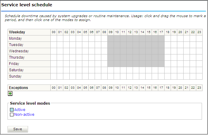

In addition to defining the KPIs that will be used to track the service levels achieved by your organization, you also need to specify when these service levels should apply. Typically, an organization has a core time (for example, 9 am - 5 pm, Monday - Friday) when the committed service level should be achieved. However, you may need to define exceptions to this, such as for public holidays. For example, a limited service between 10 am and 4 pm may be required on Easter Monday. Finally, you will also need to take account of planned maintenance periods.
The scheduling of planned service levels is maintained through the Service level schedule (shown in Figure 8-4). To open it, select Configuration, then Service level management, and then select Service level schedule.
You can mark a period within the Service level schedule by clicking and dragging over the required period of the week. Assign the selected period a status by clicking the Active or Non-active modes.
You can define exceptions by clicking the Plus (+) icon, and selecting the day, month, and year from the Exceptions list. You can remove exceptions by clicking the Minus (-) icon to the right of an exception.
Note that any changes you make are not put into effect until you click Save. On exit, any unsaved changes you made are discarded.

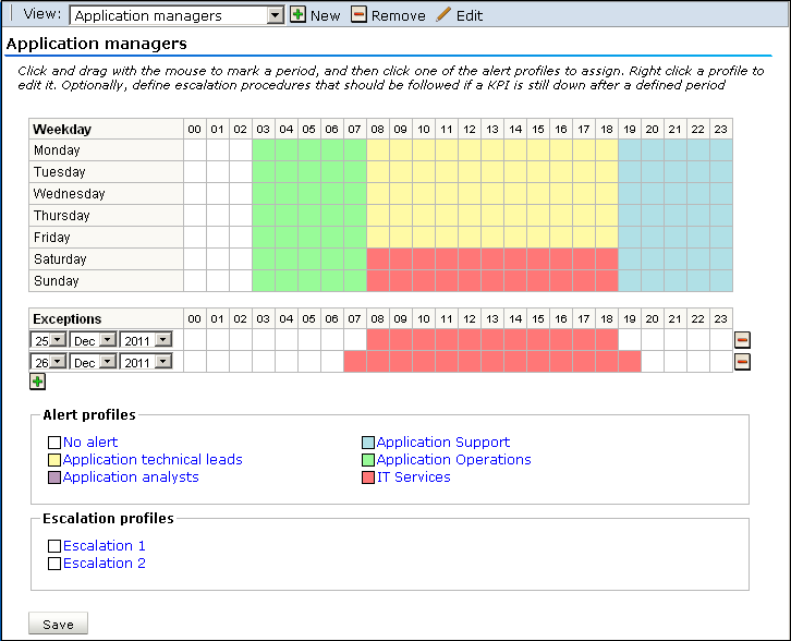

If your organization uses alerts to notify staff members about incidents that impact service levels, you will need to specify who should be notified and when. This is done through the creation of an alert schedule. You can define as many schedules as you wish to meet your operational requirements.
When you define a KPI, you specify the alert schedule(s) that the KPI should use (see Section 8.2.5, "Applying an Alert Schedule to a KPI"). Each alert schedule consists of a group of users, notification details, and the operative time frame. Exceptions to standard operating times can also be defined. To define the alert schedules that should be used by your KPIs, do the following:
Select Configuration, then Service level management, then select Alert schedule. The window shown in Figure 8-5 appears.
Use the View menu to review the currently available alert schedules.
You can define exceptions by clicking the Plus (+) icon, and selecting the day, month, and year from the Exceptions list. You can remove exceptions by clicking the Minus (-) icon to the right of an exception. You can mark a period within a schedule by clicking and dragging over the required period of the week. Assign the selected period by clicking one of the alert profiles.

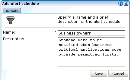

Click New within the toolbar to define a new alert schedule. The dialog shown in Figure 8-6 appears.
Specify a unique name for the alert schedule and, optionally, a brief description. It is recommended that it includes an indication of its scope and purpose. When ready, click Save.

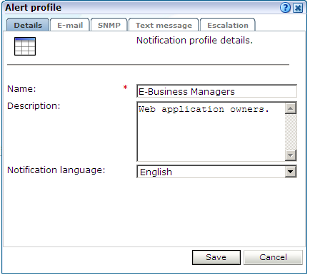

Each profile can be customized by right clicking it, and selecting Edit from the context menu. This is shown in Figure 8-7.
The dialog shown in Figure 8-8 appears.
Use this dialog to specify the name and a brief description of the users to be notified. Use the other tabs in this dialog to specify the recipients of E-mail, SNMP, and text message notification. Use the Enabled check box for each method to activate notification.

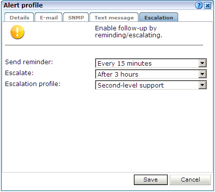

It is important to understand that there are two states associated with a KPI: the KPI state, and the alert state. The KPI state can change at each measuring interval. The alert state is controlled by the properties you define for the alert. For example, consider the case in which a KPI starts to fail, and you have defined a calculation range of 5 minutes (the default), and a DOWN duration of 15 minutes. Although after 5 minutes the KPI is considered to be failing, you will not be notified about it unless it has been continually down for 15 minutes.
Similarly, the reminder and escalation durations you specify in Figure 8-9 refer to the alert. Hence, specifying a reminder duration of every hour would generate a reminder notification every 60 minutes after the original alert was sent while the KPI is still failing. It is recommended that you carefully review the values you specify for these settings to meet your operational requirements.

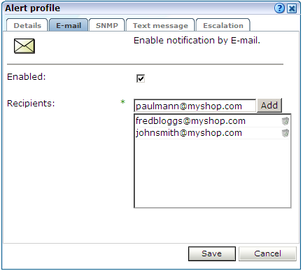

To define E-mail alert recipients, click the E-mail tab to open the dialog shown in Figure 8-10, and do the following:
Use the Recipients fields to specify the E-mail addresses of the users to be notified. Click Add to include a user in the notification list. Note that you can remove a user from the list by clicking the Remove icon to the right of the user.
Check the Enable check box to activate E-mail notification. When ready, click Save.

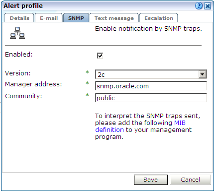

To define SNMP alert recipients, click the SNMP tab to open the dialog shown in Figure 8-11, and do the following:
Ensure that the Enabled check box is checked. Note that if not checked, no SNMP traps will be generated.
Use the Version list to specify which version of the SNMP protocol is being used. The default is version 2c.
Use the Manager address field to specify the client software address. This must be a valid network address, and can either be an IP address or a host name.
Use the Community field to specify the group to which information is sent. This string acts as a password to control the clients' access to the server.
Check the Enable check box to activate SNMP notification.

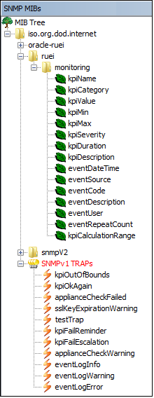

Download the Management Information Base (MIB) definition and incorporate it into your address book of managed objects. It contains necessary information about how the received SNMP messages should be interpreted. Note that the file (oracle-ruei.mib
) is also available within the RUEI installation zip file in the RUEI/extra
directory. The structure of the MIB file is shown in Figure 8-12Foot 1 .
The available KPI information and metrics in the MIB represent the most important properties of every KPI configured within the system, and can be used as the basis for filtering and alerting. They are explained in Table 8-1.

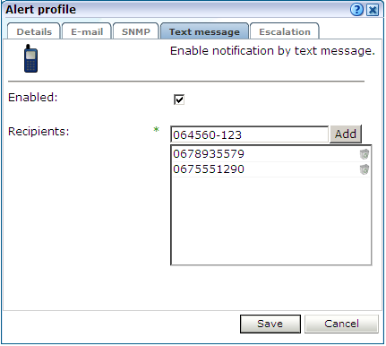

To define text message notifications, click the Text message tab to open the dialog shown in Figure 8-13, and do the following:
Use the Recipients field to specify the telephone numbers of the users to be notified. Click Add to include a user in the notification list. Note that you can remove a user from the list by clicking the Remove icon to the right of the user.
Check the Enable check box to activate text message notification. When ready, click Save.

Footnote 1: This screen features the iReasoning MIB Browser (http://www.ireasoning.com
). This utility is not distributed as part of RUEI, and requires a separate license. It is intended only to illustrate the structure of the provided MIB file.
