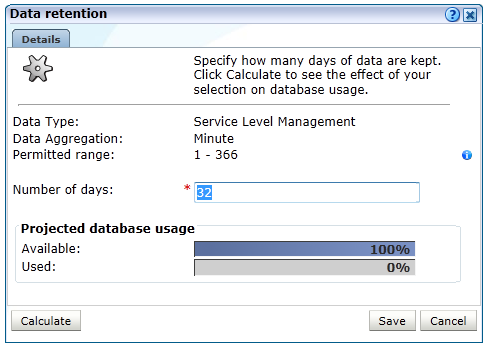

    Figure 12-20 Change Data Retention
    change data retention
  3. Use the dialog's control to specify the retention policy for the selected option.
    The projected database utilization (based on monitored traffic levels) is indicated. Information about disk space utilization is available within the dialog boxes for individual settings. Be aware that these estimates are based on the highest usage within the deployed processing systems. For example, if an item has a usage within the Reporter of 50%, and 20% within a Processing Engine, the higher value is used to report usage and availability.
    For most settings, you can click Calculate to see the effect of your selection on database or disk space usage, as applicable.
    When ready, click Save. Note that changes to disk space allocations take effect after approximately 10 minutes, while changes to database allocations only take effect after midnight.

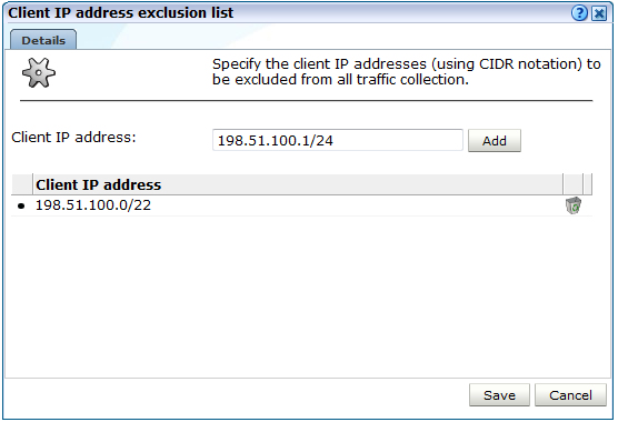

To exclude the collection of client traffic, do the following:
  1. Select Configuration, then General, then Advanced settings, and then Client traffic exclusion. Click Client IP address exclusion list. The dialog shown in Figure 12-31 appears.
    Figure 12-31 Client IP Address Exclusion List Dialog
    Description of Figure 12-31 follows
    Description of ''Figure 12-31 Client IP Address Exclusion List Dialog''
  2. Specify the IP address of the clients whose traffic you do not want monitored. Note that this must be specified in CIDR format. For each address, click Add. When ready, click Save.
    Information about the CIDR format is available at the following location:
    http://tools.ietf.org/html/rfc4632
