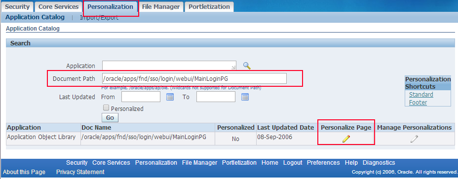

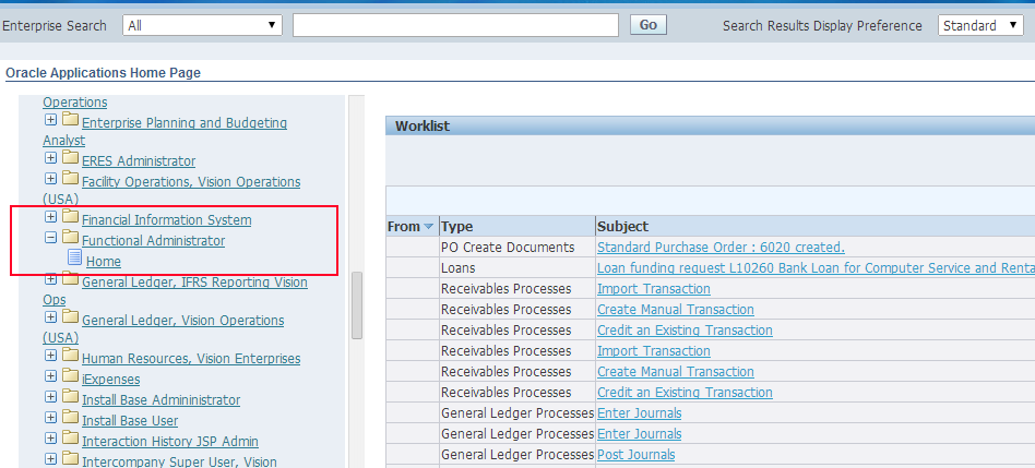

Log into EBS as the SYSADMIN user and select the Functional Administrator Responsibility option.
Navigate to Personalization tab and enter the path /oracle/apps/fnd/sso/login/webui and click Go to retrieve the document.

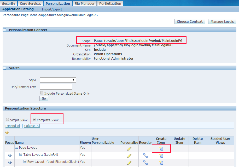

Select the Personalize Page icon for the MainLoginPG document as shown in Figure N-3.
Accept the defaults on the Choose Personalization Context screen and click Apply. Note that the scope is now /oracle/apps/fnd/sso/login/webui/MainLoginPG.

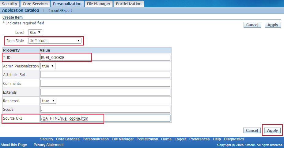

Select the Complete View option and click on the Create Item icon for the Page Layout row as shown in Figure N-4
On the following screen (Figure N-5):
Set Item Style to URL include
Enter a name for the ID, for Example RUEI_COOKIE
Set Source URI to /OA_HTML/ruei_cookie.htm
Click Apply to save changes
On the Personalization page you will see the "include url" item added using the steps above.

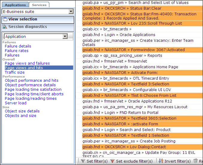

Select Browse data, open the All sessions group, select Session diagnostics, and locate the recorded session (by user ID or time). You can filter on applications.
Open the session and verify that:
There where more page views than just the login page. This verifies that the session ID is preserved in the OA framework after the login.
At least some Oracle Forms activity has been recorded with "unidentified action". This verifies that servlet calls are recorded correctly.
The page names reported within the Data Browser indicate events similar to those highlighted in Figure N-6.

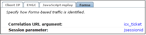

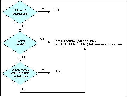

The tracking mechanisms that should be specified for the Correlation variable and Session URL argument are best determined through a number of flow charts.
Figure N-7 shows how the Session parameter can be determined. If running in socket mode, this setting is not applicable. Otherwise, the Forms URL should be examined for an argument that provides a unique value for each Forms session. Typically, this argument is located after a semicolon or question mark character in the URL. For example, jsessionid or JServSessionIdforms. Note that if the specified parameter is not found in the URL, then the cookie is searched for it.
The Correlation variable allows the sessions (on TCP and socket mode) to be merged into one end-user session. Figure N-8 shows how the Correlation variable can be determined.
If unique client IP addresses are used, then this setting is not applicable. If running in socket mode, sessions are annotated with the value from the Correlation variable (available via "INDEX_INITIAL_CMDLINE") available on both HTTP and socket-mode traffic. For EBS environments, this will always include the icx_ticket variable. For non-EBS environments, some other variable must be specified. On the HTTP layer, the variables are found in the query part of Forms-initializing calls, or in constructions such as gp1=....&gv1=... , where gp1 specifies the value name.

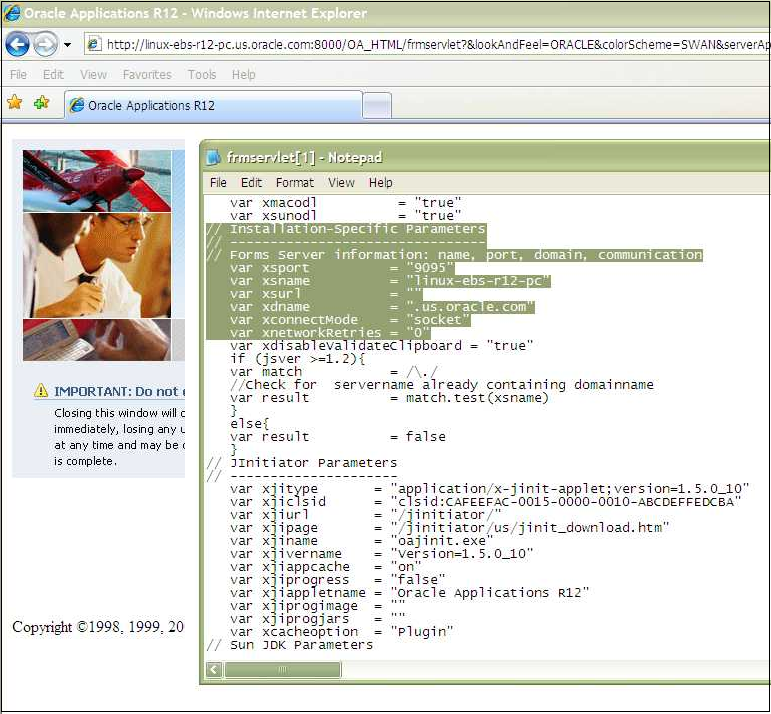

This section presents a description of how to check whether the Oracle Forms server is running in servlet or socket mode.
Oracle Applications Release 12
Note Oracle Application Release 12 is, by default, configured to run in servlet mode.
Use the following command:
$ grep connectMode FORMS_WEB_CONFIG_FILE
The current connection mode is reported:
connectMode=servlet
Alternatively, use the following command:
$ grep frmConnectMode CONTEXT_FILE
<forms_connect oa_var="s_frmConnectMode">servlet</forms_conr....

Note Oracle Application Release 11 is, by default, configured to run in socket mode.
$ grep connectMode FORMS60_WEB_CONFIG_FILE
connectMode=socket
$ grep xsport FORMS60_WEB_CONFIG_FILE
The required port number is required:
xsport=9095
$ grep socket CONTEXT_FILE
<forms_connect oa_var="s_frmConnectMode">socket</forms_conr....
Finally, you can also check the HTML source of the page used to launch the Oracle Forms application. To do so within Internet Explorer, select View, and then Source. This contains the connection mode, as shown in Figure N-10.
The relevant connection mode information is highlighted.

The EBS-specific data items shown in Table N-2 are reported by RUEI.
Table N-2 EBS-Specific Data Items
| Item | Description |
Database Time per Page (ms) |
Database time per page. This is only available if Chronos or End User Monitoring is enabled. |
Total Database Time (ms) |
Total Database Time |
EBS Action |
Description of the action executed by the user (depends on framework how this is determined |
EBS Component |
Description of the active component (if it can be determined in this framework) |
EBS Form Hierarchy |
The component hierarchy of the element that was active inside Oracle Forms protocol during measured activity |
EBS Form Message |
The information related to specific programmed messages indicating start/end Oracle Forms messages |
EBS Form Name |
The name of the Oracle form related to the activity |
EBS Form Name Description |
The description of the Oracle Form Name that was active |
EBS Framework |
The EBS framework used. For example, FORMS (Oracle Forms traffic), OA (Oracle Application framework), JTT (JTT framework), servlet (servlets), and other-traffic (only visible when the unclassified pages setting is checked; use page-URL to see the actual URL). |
EBS JSP Filename |
The name of JSP-based files used. For example, this could contain login-events or actions such as 'runforms'. |
EBS Java Class |
The class name of the component that was active for user activity |
EBS Module |
The EBS module within which the end user was navigating |
EBS Module Code |
The EBS Module within which the end user was navigating |
EBS Responsibility |
The responsibility that was active during activity |
EBS Responsibility ID |
The id for the responsibility that was active during activity |
EBS User Input |
The literal text that was entered by user during activity in cases where it could be identified. |

It is strongly recommended that after configuring an EBS suite definition, you login to the EBS application, and execute a critical path through the application. Then, you should search for recorded action within RUEI, and use the Session Diagnostics feature to verify that it is correctly reported. In particular:
Verify that descriptions are reported, and not codes. If codes are reported instead of application names, or page-group level codes instead of page-group names, it indicates that the information derived from the create_EBS_info.pl script is not activated correctly.
A large number of reported short sessions indicates that Forms traffic is not being measured.
A large number of reported .jsp files indicates the need for manual page naming (if required by the customer).
If a large portion of the reported traffic contains unidentified actions, this indicates that Forms tracking is not functioning correctly. You should consider the following:
If you do not see such things as "Status Bar" and "Textfield" (as shown in Figure N-6), this indicates that some specific characteristic in the monitored traffic is not being captured. In this case, you should contact Customer Support.
