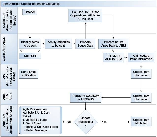

Figure 2-1 illustrates the integration sequence for item attribute update from Oracle E-Business Suite to Agile PLM.
Figure 2-1 Sequence Diagram for Item Attribute Update
This image is described in surrounding text

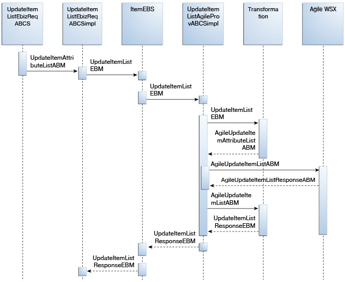

Figure 2-2 illustrates the item attribute update integration services orchestration.
Figure 2-2 Item Attribute Update Integration Services Orchestration
Table 2-1 list the activities involved in the item attribute update integration services orchestration.
Table 2-1 Activities in Item Attribute Update Integration Service
Step Activity Remarks
1
The Publish Item Attributes Update concurrent program is initiated.
The Publish Item Attributes Update concurrent program in Oracle E-Business Suite invokes UpdateItemListEbizReqABCS.
2
UpdateItemListEbizReqABCS proxy service invokes the UpdateItemListEbizReqABCSImpl.
An invoke activity in UpdateItemListEbizReqABCS invokes the UpdateItemList operation on UpdateItemListEbizReqABCSImpl. It also sends the response back to the CP. If the invokation is successful, the Response status is sent as 'S' with message:- "Synchronization In Progress, please check the BPEL instance id" and the CP is completed. Otherwise, the Response status is sent as 'E' with message:- "Synchronization failed, please check the BPEL instance id" and the CP errors out.
3
UpdateItemListEbizReqABCSImpl invokes ItemEBSV2.
An invoke activity in UpdateItemListEbizReqABCSImpl invokes the UpdateItemList operation on ItemEBSV2 with UpdateItemListEBM as input.
4
ItemEBSV2 routes the UpdateItemListEBM to UpdateItemListAgileProvABCSImpl.
ItemEBSV2 routes UpdateItemListEBM as input to UpdateItemListAgileProvABCSImpl.
5
UpdateItemListAgileProvABCSImpl invokes Agile PLM's Item Operational Attribute Update Web service.
UpdateItemListAgileProvABCSImpl transforms UpdateItemListEBM to AgileUpdateItemListABM and invokes the UpdateItemList service operation on the Agile PLM Web service to update the item cost-related attribute information from Oracle to Agile PLM.
AgileUpdateItemListResponseABM is returned to UpdateItemListAgileProvABCSImpl.
Note: The UpdateItemListAgileProvABCSImpl composite uses the oracle/wss_http_token_client_policy (or oracle/wss_username_token_over_ssl_client_policy integrated with Agile PLM 9.3.4 Web Service Security enabled) client security policy while calling ItemABS Service hosted on the Agile server. The security credentials for this are stored in the csf-key AgileWebServicesKey on Fusion Middleware (FMW). The Agile username and password need to be setup correctly so that the Agile service is invoked successfully from the AIA composite in the FMW layer.
6
UpdateItemListAgileProvABCSImpl sends a response to ItemResponseEBSV2.
UpdateItemListAgileProvABCSImpl transforms AgileUpdateItemListResponseABM to UpdateItemListListResponseEBM and sends it to ItemResponseEBSV2.
7
ItemResponseEBSV2 sends UpdateItemListListResponseEBM to UpdateItemListEbizReqABCSImpl.

2.7 Integration Services
The integration services for the item attribute update are:
  • UpdateItemListEbizReqABCS
  • ItemEBSV2
  • UpdateItemListEbizReqABCSImpl
  • UpdateItemListAgileProvABCSImpl
2.7.1 UpdateItemListEbizReqABCS
This is a synchronous proxy service which will be invoked by the Ebiz Concurrent Program and will in turn invoke the asynchronous UpdateItemListEbizReqABCSImpl service.
2.7.2 ItemEBSV2
ItemEBSV2 is the Enterprise Business Services (EBS) that exposes the following operations related to the item attribute update integration flow in relation to the ItemEBO.
The following list itemizes the routing rules:
  • ItemEBSV2 service
    UpdateItemList: Routes UpdateItemListEBM to UpdateItemListAgileProvABCSImpl
  • ItemResponseEBSV2 service
    UpdateItemListResponse: Routes UpdateItemListResponseEBM to UpdateItemListEbizReqABCSImpl
2.7.3 UpdateItemListEbizReqABCSImpl
This service is called when multiple items in Agile PLM with all the operational attributes as well as the attributes from Oracle E-Business Suite, such as unit cost, need to be updated. This is a push from Oracle E-Business Suite to Agile PLM through a batch process.
The process includes:
  • The requester ABCS, defined as a synchronous process, receives a list of item IDs from the Oracle E-Business Suite concurrent program.
    The list contains only those IDs that have last_update_date greater than the last run date of the concurrent program.
  • The requester BPEL process filters the list of IDs to a list of IDs that are present in the cross-reference tables in the Fusion Middleware (FMW) layer.
    This provides a list of items that are in Agile PLM. The original list of item IDs can contain items that are from the non-Agile PLM sources as well.
  • The BPEL process then makes an OA Adapter call to the PL/SQL API, which provides the details of the sent item. This is the item ABM.
  • A transformation converts the ABM to an EBM.
    An asynchronous request-delayed response call is made to ItemEBSV2 with UpdateItemListEBM. This service is routed to the appropriate provider.
  • The BPEL instance is reactivated from dehydration store when the asynchronous call returns from the provider and provides the status of the transaction back to the caller concurrent program (because it is a synchronous call).
  • The concurrent program logs the status of this call.
2.7.4 UpdateItemListAgileProvABCSImpl
The UpdateItemListAgileProvABCSImpl is used to facilitate the communication between the ItemEBSV2 and the Agile PLM Web service used for updating the item attribute information in a batch mode in Agile PLM.
  • The UpdateItemListAgileProvABCSImpl receives the UpdateItemListReqMsg that contains the UpdateItemListEBM.
  • The transform operation is called to convert the UpdateItemListEBM into the AgileUpdateItemListABM.
  • The AgileUpdateItemListABM is sent as input to the Web service operation UpdateItemList (coarse-grained APIs in Agile PLM) to update the items in Agile PLM.
  • The AgileUpdateItemListResponseABM is received upon successful implementation of the coarse-grained API.
  • The transform operation is called to convert AgileUpdateItemListResponseABM to UpdateItemListResponseEBM, which is returned as an output of this BEPL process.
  • If the UpdateItemList service operation fails on the Agile PLM side, a new fault is generated and is sent across with an appropriate error message.
