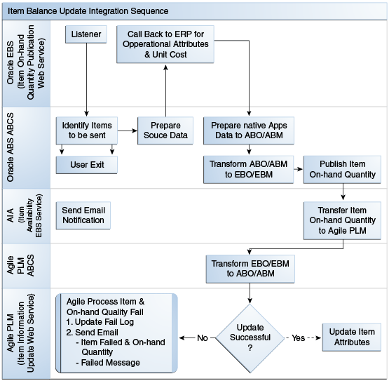

The update of item balance information from Oracle E-Business Suite to Agile PLM is performed as a batch process.
The item balance update process includes:
  1. Item balance information (that is on hand quantity) is modified in Oracle E-Business Suite.
    This modification could be done in specific organizations or in a single Oracle E-Business Suite organization. You can designate, as a part of a configuration parameter, a single Oracle E-Business Suite organization from which all item attribute information is always retrieved. In such a case, it is not necessary to have Agile PLM multi-sites.
  2. The input for this process consists of a batch of item on hand quantity or balance information with their unique identifiers and values that need to be updated in Agile PLM.
  3. The batch process for publishing the changed information initiates at a specified frequency, which is configurable.
    While the update to information in Agile is normally driven through the scheduled batch processes, it is also possible to trigger the information update event from Oracle E-Business Suite through the Integrations Administrator and running the Publish Engineering Change Order Updates function.
  4. The process retrieves the last date and time where the item information update process completed successfully.
  5. The process retrieves the list of items whose on hand quantity has changed after the last successful run.
    In addition, it retrieves the list of mapped attribute values for these items. The data is retrieved from one or more organizations as per site-org mappings or from the configured single organization.
    Item balance information can exist in multiple organizations in Oracle E-Business Suite. Any change in any of the three types of attributes (reserve quantity, available quantity or on hand quantity) may take place in just one, or in a few, or in all organizations. Oracle E-Business Suite determines which organization corresponds (maps) to which flex-field in Agile PLM using the Domain Value Map (DVM) AGILE_TARGET_SITE_MAPPING.
In the case of a single site environment:
  • Sites are mapped to the Oracle E-Business organizations through a specified P2 attribute (example, P2.ebiz Org)
  • Item balance information is retrieved from the specified organization and updated in the mapped attributes in Agile
  • In case an item is mapped to multiple organizations, the values from the first Organization in the transformed XML file are picked up for update
In the case of multi-site environment:
  • The attribute to be updated is defined on the Site tab of the item in Agile PLM.
  • Based on the update of the item attribute value in an Organization, the change is reflected in the mapped attribute in the corresponding Site.
The process updates the information in Agile PLM.
If the complete update is processed successfully, the process updates the date and time of last successful run. If the update for an item fails, the system continues to process other items in the batch. A list of all errors encountered when processing the batch are accumulated and logged.
Figure 3-1 illustrates the integration sequence for item balance update from Oracle E-Business Suite to Agile PLM.
Figure 3-1 Integration Sequence for Item Balance Update
This image is described in surrounding text

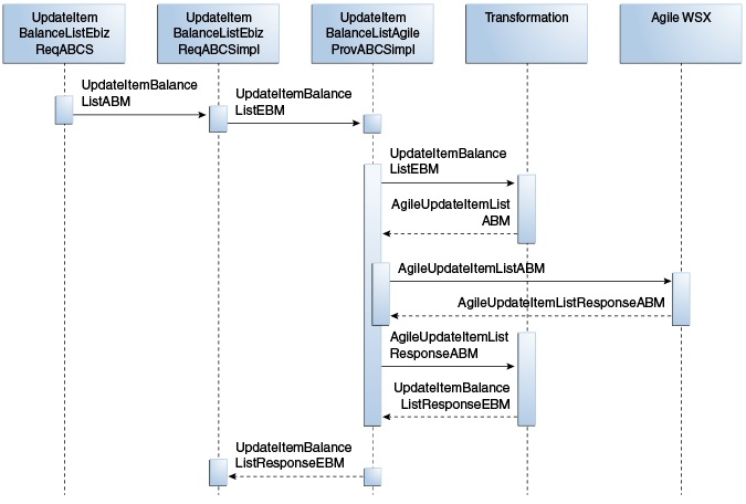

3.2.2 Item Balance Update Integration Services Orchestration
Figure 3-2 illustrates the item balance update integration services orchestration.
Figure 3-2 Item Balance Update Integration Services Orchestration
Table 3-1 lists the activities involved in the item balance update integration services orchestration.
Table 3-1 Activities in Item Balance Update integration services orchestration
Activity Remarks
1
Publish Item Balance Update concurrent program is initiated.
The Publish Item Balance Update concurrent program in Oracle E-Business Suite invokes synchronous proxy service UpdateItemBalanceListEbizReqABCS.
2
UpdateItemBalanceListEbizReqABCS synchronous proxy service invokes the asynchronous UpdateItemBalanceListEbizReqABCSImpl.
An invoke activity in UpdateItemBalanceListEbizReqABCS invokes the initiate operation on UpdateItemBalanceListEbizReqABCSImpl. It also sends the response back to the CP. If the invokation is successful, the Response status is sent as 'S' with message:- "Synchronization In Progress, please check the BPEL instance id" and the CP is completed. Otherwise, the Response status is sent as 'E' with message:- "Synchronization failed, please check the BPEL instance id" and the CP errors out
3
UpdateItemBalanceListEbizReqABCSImpl invokes UpdateItemBalanceListAgileProvABCSImpl.
An invoke activity in UpdateItemBalanceListEbizReqABCSImpl invokes UpdateItemBalanceList operation on UpdateItemBalanceListAgileProvABCSImpl with UpdateItemBalanceList EBM as input.
4
UpdateItemBalanceListAgileProvABCSImpl invokes Agile PLM's Item Balance Web service.
UpdateItemBalanceListAgileProvABCSImpl transforms UpdateItemBalanceListEBM to the AgileUpdateItemBalanceListABM message and invokes the UpdateItemList service operation on Agile PLM Web Service to update Item On-Hand Quantity information from Oracle to Agile PLM.
AgileUpdateItemBalanceListResponseABM is returned to the UpdateItemBalanceListAgileProvABCSImpl service.
Note: The UpdateItemBalanceAgileProvABCSImpl composite uses the oracle/wss_http_token_client_policy (or oracle/wss_username_token_over_ssl_client_policy integrated with Agile PLM 9.3.4 Web Service Security enabled) client security policy while calling the ItemABS service hosted on the Agile server. The security credentials for this are stored in the csf-key AgileWebServicesKey on Fusion Middleware (FMW). The Agile username and password need to be setup correctly so that the Agile service is invoked successfully from the AIA composite in the FMW layer.
5
UpdateItemBalanceListAgileProvABCSImpl sends the UpdateItemBalanceListResponseEBM to UpdateItemBalanceListEbizReqABCSImpl.
UpdateItemBalanceListAgileProvABCSImpl transforms AgileUpdateItemBalanceListResponseABM to UpdateItemBalanceListResponseEBM and returns it to UpdateItemBalanceListEbizReqABCSImpl.
UpdateItemBalanceListEbizReqABCSImpl sends the response to the concurrent program in Oracle E-Business Suite.

3.7 Integration Service
The integration services for the item balance update are:
  • UpdateItemBalanceListEbizReqABCS
  • UpdateItemBalanceListEbizReqABCSImpl
  • UpdateItemBalanceListAgileProvABCSImpl
3.7.1 UpdateItemBalanceListEbizReqABCS
This is a synchronous proxy service which will be invoked by the Ebiz Concurrent Program and will in turn invoke the asynchronous UpdateItemBalanceListEbizReqABCSImpl service.
An invoke activity in UpdateItemBalanceListEbizReqABCS invokes the initiate operation on UpdateItemBalanceListEbizReqABCSImpl. It also sends the response back to the CP. If the invokation is successful, the Response status is sent as 'S' with message:- "Synchronization In Progress, please check the BPEL instance id" and the CP is completed. Otherwise, the Response status is sent as 'E' with message:- "Synchronization failed, please check the BPEL instance id" and the CP errors out.
3.7.2 UpdateItemBalanceListEbizReqABCSImpl
This service is called when a participating application needs to update multiple item balance attributes on their system such as on-hand quantity from Oracle E-Business Suite. This is a push from Oracle E-Business Suite to the other participating application through a batch process.
The process includes:
  • The requester ABCS, defined as a synchronous process, receives a list of item IDs from the Oracle E-Business Suite concurrent program.
    The list contains the IDs that have last_update_date greater than the last run date of the concurrent program.
  • The requester Business Process Execution Language (BPEL) process filters the list of IDs to a list of IDs that are present in the cross-reference tables in the Fusion Middleware (FMW) layer.
    This provides a list of Items that are in the Agile PLM application. The original list of Item IDs can contain items that are from non-Agile PLM sources as well.
  • The BPEL process then makes an OA Adapter call out that calls the PL/SQL API, which provides the details of the sent item.
    This is an ItemBalance Application Business Message (ABM).
  • A transformation converts the ABM to an EBM.
  • An asynchronous request-delayed response call is made to the UpdateItemBalanceListAgileProvABCSImpl with UpdateItemBalanceList EBM as input.
    This service is routed to the appropriate provider.
  • The BPEL instance is reactivated from dehydration store when the asynchronous call returns from the provider and provides the status of the transaction back to the caller concurrent program (because that is a synchronous call).
    It is a scheduled call and is invoked from the back end, not from the user interface (UI); hence, it does not affect performance.
  • The concurrent program logs the status of this call.
3.7.3 UpdateItemBalanceListAgileProvABCSImpl
UpdateItemBalanceListAgileProvABCSImpl is used to facilitate the communication between Agile PLM Web service used for updating the item quantity information in a batch mode in Agile PLM.
  • The UpdateItemBalanceListAgileProvABCSImpl receives UpdateItemBalanceListReqMsg, which contains UpdateItemBalanceListEBM.
  • The transform operation is called to convert UpdateItemBalanceListEBM into AgileUpdateItemBalanceListABM.
  • AgileUpdateItemBalanceListABM is sent as input to the Web service operation UpdateItemList (Coarse Grained APIs in Agile PLM) to update items in Agile PLM.
  • AgileUpdateItemBalanceListResponseABM is received on the successful run of the Coarse Grained API.
  • The transform operation is called to convert AgileUpdateItemBalanceListResponseABM to UpdateItemBalanceListResponseEBM, which is returned as output of this BPEL process.
  • If the UpdateItems service operation fails on the Agile PLM side, a new fault is generated and is sent across with an appropriate error message.
