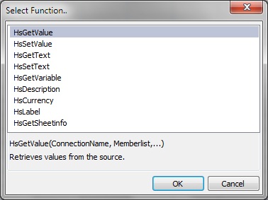

  4. In Select Function, select a function from the list and click OK.
    Figure 109. Function Builder, Select Function Dialog Box
    The Function Builder, Select Function dialog box, with HsGetValue, selected as described in this section
    Not all functions are available to all providers. See Table 40, Smart View Functions and Supported Providers for a list of functions and the supported providers.
