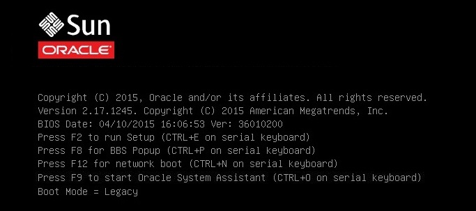

The system begins the boot process and the BIOS screen appears.

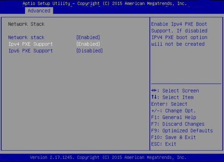

The BIOS Setup Utility Network Stack screen appears.
This causes the server to reset. After resetting, the BIOS screen appears again.

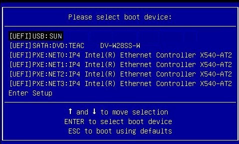

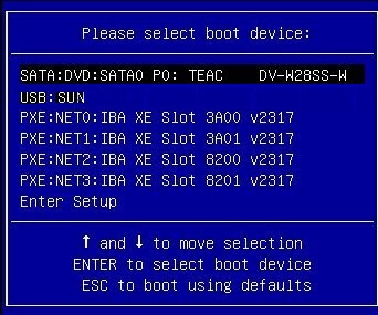

The Please Select Boot Device menu appears, listing the available boot devices. The screen that appears is different, depending on whether you have UFEI/BIOS configured for Legacy BIOS Boot Mode or UEFI Boot Mode.
For Legacy BIOS Boot Mode, a screen similar to the following appears:
For UEFI Boot Mode, a screen similar to the following appears:
The PXE boot port is the physical network port configured to communicate with your network install server.
