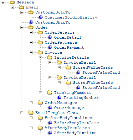

• Outbound Email XML Message (CWEmailOut)

Sample Outbound Email XML Messages
A sample of each type of Outbound Email XML Message (CWEmailOut) is presented below:

Sample Order Confirmation XML Message
<Message source="CWDIRECT" target="CWINTEGRATE" type="CWEmailOut" date_created="2005-01-12" time_created="15:11:17">
<Email notification_type="OC" notification_type_desc="Order Confirmation" email_addr="ekaplan@commercialware.com" company="27" company_desc="EZK Mail Order" entity="1" entity_desc="AVIAN CREATIONS">
<CustomerSoldTo sold_to_nbr="1060" sold_to_company="COMMERCIALWARE" sold_to_fname="GLORIA" sold_to_lname="MUNDI" sold_to_addr1="257 LOVELL STREET" sold_to_city="WORCESTER" sold_to_state="MA" sold_to_state_name="MASSACHUSETTS" sold_to_postal="01602" sold_to_country="USA" sold_to_country_name="UNITED STATES" sold_to_alternate_id="ABCDEFG" sold_to_cust_class="18" sold_to_cust_class_desc="LOYALTY">
<CustomerSoldToHistory sold_to_LTD_nbr_orders="537" sold_to_LTD_order_dollars="3737031" sold_to_LTD_nbr_sales="462" sold_to_LTD_sales_dollars="2342701" sold_to_first_buyer="N" sold_to_last_src="SOURCE" sold_to_last_src_desc="2005 SOURCE"/>
</CustomerSoldTo>
<CustomerShipTo ship_to_company="COMMERCIALWARE" ship_to_fname="FRANK" ship_to_lname="HALSEY" ship_to_addr1="24 PRIME PARK WAY" ship_to_city="NATICK" ship_to_state="MA" ship_to_state_name="MASSACHUSETTS" ship_to_postal="01760" ship_to_country="USA" ship_to_country_name="UNITED STATES"/>
<Order order_nbr="10484" order_date="2005-01-12" order_source="SOURCE" order_source_desc="2005 SOURCE" order_offer="OFR" order_offer_desc="2005 OFFER" order_process_date="2005-01-12" order_ship_to="1" ost_discount="850" ost_tax="765" ost_merch="7650" ost_freight="765" ost_addl_freight="234" ost_total_amt="9414">
<OrderDetails>
<OrderDetail odt_item="PEN23" odt_item_desc="COMFORT-GRIP PEN" odt_SKU="BLK" odt_SKU_desc="BLACK INK" odt_item_class="OFC" odt_item_class_desc="OFFICE SUPPLIES" odt_set_master="N" odt_offer="OFR" odt_offer_desc="2005 OFFER" odt_price="450" odt_qty="10" odt_extended_price="4500" odt_availability_msg="In stock." odt_seq_nbr="1" odt_line_nbr="1"/>
<OrderDetail odt_item="MOSAIC KIT" odt_item_desc="MOSAIC KIT" odt_alias_item="MALIAS" odt_item_class="CRT" odt_item_class_desc="CREATIVITY TOYS" odt_set_master="Y" odt_set_component_seq="1" odt_offer="OFR" odt_offer_desc="2005 OFFER" odt_price="2250" odt_qty="1" odt_extended_price="2250" odt_availability_msg="In stock." odt_seq_nbr="2" odt_line_nbr="2"/>
<OrderDetail odt_item="SEAGLASS" odt_item_desc="SEAGLASS PIECES FOR MOSAIC" odt_SKU="BLUE" odt_SKU_desc="COBALT BLUE" odt_set_master="N" odt_set_component_seq="1" odt_free_gift="N" odt_offer="OFR" odt_offer_desc="2005 OFFER" odt_qty="1" odt_availability_msg="Backordered" odt_expected_ship_date="2005-01-13" odt_seq_nbr="3" odt_line_nbr="3"/>
<OrderDetail odt_item="SEAGLASS" odt_item_desc="SEAGLASS PIECES FOR MOSAIC" odt_SKU="GRN" odt_SKU_desc="GREEN" odt_set_master="N" odt_set_component_seq="1" odt_free_gift="N" odt_offer="OFR" odt_offer_desc="2005 OFFER" odt_qty="1" odt_availability_msg="Backordered" odt_expected_ship_date="2005-01-13" odt_seq_nbr="4" odt_line_nbr="4"/>
<OrderDetail odt_item="GROUT" odt_item_desc="SANDED GROUT FOR MOSAIC" odt_set_master="N" odt_set_component_seq="1" odt_free_gift="N" odt_offer="OFR" odt_offer_desc="2005 OFFER" odt_qty="1" odt_availability_msg="Backordered" odt_expected_ship_date="2005-01-13" odt_seq_nbr="5" odt_line_nbr="5"/>
<OrderDetail odt_item="MUG" odt_item_desc="COLLECTIBLE COFFEE MUG" odt_item_class="KIT" odt_item_class_desc="KITCHEN GOODS" odt_set_master="N" odt_offer="OFR" odt_offer_desc="2005 OFFER" odt_price="900" odt_qty="1" odt_extended_price="900" odt_availability_msg="No longer available." odt_seq_nbr="6" odt_line_nbr="6"/>
<OrderDetail odt_item="BEDROOM" odt_item_desc="BEDROOM DECORATOR KIT" odt_set_master="N" odt_offer="OFR" odt_offer_desc="2005 OFFER" odt_price="900" odt_qty="1" odt_extended_price="900" odt_availability_msg="Exp Date" odt_expected_ship_date="2005-01-19" odt_seq_nbr="7" odt_line_nbr="7"/>
</OrderDetails>
<OrderPayments order_payment_count="2">
<OrderPayment opm_payment_type="98" opm_payment_type_desc="CREDIT/COUPON" opm_gift_certificate_cpn="206301"/>
<OrderPayment opm_payment_type="5" opm_payment_type_desc="VISA" opm_credit_card="****************7890" opm_credit_card_exp_date="12/05"/>
</OrderPayments>
</Order>
<EmailTemplateText>
<BeforeBodyTextLines>
<BeforeBodyTextLine before_line_msg="We have received your order for the following items listed"/>
<BeforeBodyTextLine before_line_msg="below. Typical order processing time for in-stock items"/>
<BeforeBodyTextLine before_line_msg="is approximately 24 hours. Please be assured that we will"/><BeforeBodyTextLine before_line_msg="ship your order as soon as possible."/>
</BeforeBodyTextLines>
<AfterBodyTextLines>
<AfterBodyTextLine after_line_msg="Thank you for your order. Please think of us for all your"/>
<AfterBodyTextLine after_line_msg="pet supply and household needs."/>
</AfterBodyTextLines>
</EmailTemplateText>
</Email>
</Message>

OrderDetail
The OrderDetail element is not included in the shipment, return, credit card credit confirmation, or stored value card messages. For backorder notifications, only the backordered lines are included; for soldout notifications, only the sold out lines are included.
Note: If you pre-bill items, the Pre Billed Amount Item (J72) is included in the outbound XML order or shipment notification message. See the Pre Billed Amount Item (J72) system control value for a discussion.

OrderPayments
The OrderPayments element is not included for backorder or soldout notifications.
order_payment_
count
numeric
2
The number of payment methods on the order.
Only active payment methods are included in the message. As a result, if you deactivate an order payment method (even if you have already charged it for a shipment) it is omitted from the message and not included in the order_payment_count.
OrderPayment
The OrderPayment element is not included for backorder or soldout notifications; however, the other notification types include all active payment methods. For example, credit card credit notices include all payment methods on the order, not just the one receiving the credit or included on the credit invoice.

Invoice
This element is included only for shipment, return, credit card credit, and stored value card notices. There is a separate confirmation message for each invoice number and ship-to on an order. As a result, there is a single Invoice element in each message.
The Consolidated Invoice (B49) system control value controls whether each shipment billed against an order on the same day is assigned to the same invoice number. Similarly, the Consolidated Credit Invoice (K06) system control value controls whether each return billing against an order on the same day is assigned to the same credit invoice number. See these system control values for discussions.
If the invoice represents a credit for a return, dollar values are negative and are preceded by minus signs; however, the cc_credit_amt included for a credit card credit notice is a positive amount.
See the Display Invoice Header Screen for a general discussion of the fields in the Invoice Header file.
• Pre-bill? If you pre-bill items, a shipment confirmation XML message is generated when you pre-bill. See the Pre Billed Amount Item (J72) system control value for a discussion.
• Immediate notices and consolidating invoices: If you generate shipment and return confirmations immediately (based on the setting of the E-mail Shipment/Return Confirmation Notification Immediately (K07) system control value) and if you also consolidate invoices (based on the setting of the Consolidated Invoice (B49) system control value) or consolidate credit invoices (based on the setting of the Consolidated Credit Invoice (K06) system control value), then it is possible for the billing async job to generate the shipment or return confirmation email message multiple times in a single day, adding the newly-billed or returned items to the email each time. See the discussion under the E-mail Shipment/Return Confirmation Notification Immediately (K07) system control value for more information.
invoice_nbr

StoredValueCard
Included only in stored value card notices.
Available in XML version: 2.0 in CWDirect release 12.5 or later.

TrackingNumber
CWDirect release earlier than 12.0: This element is included for shipment confirmations if a tracking number exists in the Manifest Upload Audit file.
CWDirect release 12.0 and later: This element is included for shipment confirmations if a ship via code exists in the Manifest Upload Audit file; the system includes the TrackingNumber element and its tags even if there is no tracking number for the Manifest Upload Audit record.
Brokered Backorder? If a shipment occurred through the Brokered Backorder Integration with Locate version 5.1 or higher, then the tracking number and ship via for a shipment confirmation are from the Order Transaction History file rather than the Manifest Upload Audit file.
The TrackingNumber element is included only in the shipment, credit card credit, and stored value card notices; however, the element is empty for credit card credit and stored value card notices.

OrderMessage
The OrderMessage element is included for shipment, return, credit card credit, and stored value card notifications only.
For more information: See Adding Order Messages.
Available in XML version: 2.0, in CWDirect release 12.5 or later.
oms_seq_nbr
numeric
3
A unique number to identify the message line on the order.
oms_message
alpha
60
A message for or about the order.
oms_print_flag
alpha
1
Determines whether the order message line prints or is available for internal use only.
Valid values are:
• B = Print on both invoice and pick slip
• C = Print on refund check only
• G = Gift message
• I = Print on invoice only
• N or blank = Do not print
• P = Print on pick slip only
• R = Print on detachable area of refund check not visible to the customer
• U = Print on the document defined by the user, such as a custom pick slip. If there is no user-defined document, the message does not print anywhere in CWDirect.
• Y = Message has printed on refund check
• Z = Message has printed on detachable area of refund check not visible to the customer
BeforeBodyTextLine
The text in this element and in the AfterBodyTextLine element comes from the entity associated with the order, if you have set up an email template for the entity; otherwise, it comes from the company. See Email Template Override at Entity Level for a discussion of setting an email template at the entity level, and see Working with E-Mail Notification Templates (WEMT) for a discussion of setting up an email template at the company level.
before_line_msg
alpha
60
The contents of the Text to print above items for the email notification template. You can specify up to ten lines of text.
AfterBodyTextLine
after_line_msg
alpha
60
The contents of the Text to print below items for the email notification template. You can specify up to three lines of text.
