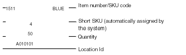

Code field: Enter the code that determines if labels will print and the quantity.
Valid values are:
• N indicates that labels will not be printed.
• Y indicates that a single label for the total quantity received will be printed at PO Receipts and PO Suspense.
• P indicates that you will be prompted for the number of labels to be printed and the quantity to print of each at PO Receipts and PO Suspense.
Sample label:
If you use radio frequency devices in your warehouse, the system will print LPN (license plate number) bar-coded labels when you receive a purchase order. See LPN Tracking (E16).

LPN tracking: The system assigns an LPN to each carton at purchase order receipts. The LPN provides a means to track the movement and location of stock at the carton level, rather than the individual unit. The LPN remains with the carton until you put it away in the item's primary location.
Printing Labels: Normally, you will also print a bar-coded label when you receive a purchase order. This label allows you to scan the LPN and other information with an RF gun when moving inventory. You can also generate labels as needed (for example, for returns).
Suggest Location Placement: The steps the system takes to suggest placement of purchase order receipts varies depending on whether you use LPN tracking in your warehouse. If the LPN tracking system control value is set to Y, use these additional system control values to set up suggest location placement:
