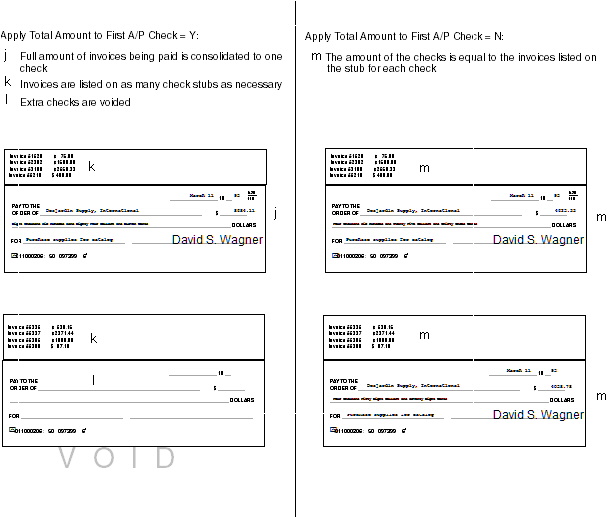

Defines whether the system consolidates payment on vendor invoices to a single check, lists the invoices being paid on multiple check stubs, and voids the remaining checks. |
Yes/No: |

Apply Total Amount to First A/P Check (D18)
Purpose: Use this screen to define whether the system should:
• consolidate payment for multiple vendor invoices into a single check,
• list each invoice being paid on each check stub
• void the additional checks
MSR0052 OPEN Change System Control Value 2/10/97 16:27:53
Description . : Apply total amount to first A/P Check
Yes/No . . . . (Y,N) Narrative . . .
Application . : A/P Applic group . ALL Sequence# . . . 101
F3=Exit F12=Cancel |
Yes/No field: Enter Y in this field to print the entire amount being paid to the vendor on the first check, list each invoice being paid on the check stubs, and void all checks but the first.
Enter N to print the amount being paid to the vendor on each check and print the corresponding invoice numbers on each check stub.
Note: The number of invoices that you can pay off on a single check is controlled by the value in the Max # of Invoices on a Check (C53) system control value.
Examples: These two examples show how the system prints A/P checks based on entering a Y or N value in this field in the System Control file.
Conditions: You are paying off 8 invoices received from the vendor and you can include up to 4 invoices on a check.
For more information: See Accounts Payable Part D: Working with A/P Checks.
