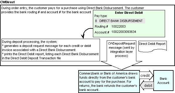

Direct bank disbursement processing illustration:
In Regular Order Entry: When you add a direct bank disbursement pay type to an order, the system displays the Enter Direct Debit For Window (Direct Bank Disbursement Payment Type), which requires the routing number and account number of the customer’s bank account.
A credit card number is not relevant for a direct bank disbursement pay type, so the system defaults the Description of the direct bank disbursement pay type to the Credit card number field.
Note: You cannot use deferred or installment billing with a direct debit disbursement pay type. See Working with Flexible Payment Options (WFPO) for more information on setting up payment plans for deferred and installment billing.
During Deposits: During deposits processing, the system calls the AAR003 user exit point and, if the user function AAR0258 is defined, the system processes direct bank disbursement. When you process deposits for an order containing a direct bank disbursement, the system:
• creates a record in the Direct Debit Deposit Transaction file for each order number/invoice number combination associated with a direct bank disbursement payment. This file contains the information a bank requires to draw funds directly from a customer’s bank account to pay for the purchase.
• prints the Print Direct Debit Report. This report lists each order number/invoice number combination that contains a direct bank disbursement payment and the amount, customer name, routing number, and account number associated with the payment.
Deposit request XML message: During deposit processing, if an integration layer process has been set up in Integration Layer Job Control (IJCT) to generate the deposit request messages for transmission to the per_bankofamerica site, the AUTO_DEP job starts this process and the message generation takes place. The AUTO_DEP job waits until it receives the deposit response message, and then updates each direct debit deposit to confirmed status.
Returns: If you process a return against the direct bank disbursement pay type, the system creates a credit invoice for the refund amount. When you process deposits for the credit invoice, the PERDEP process generates a deposit request for the amount the bank will refund the customer’s bank account.
Note: Returns are available for deposit processing after you use the Process Refunds menu option (MREF) to generate the credits.

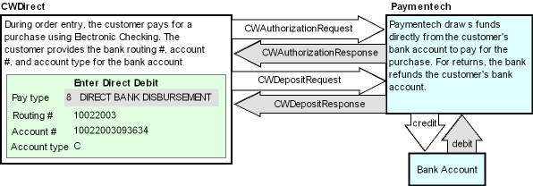

Electronic check processing illustration:
In addition, if the Require account type field for the direct disbursement pay type is set to Y, the system requires you to define the type of bank account from which the funds are withdrawn. Valid bank account types are:
• C personal checking bank account
• S personal savings bank account
• X corporate checking bank account
During Authorizations: During authorization processing (online or batch), the system generates the Authorization Request XML Message (CWAuthorizationRequest) to send to Paymentech.
Paymentech authorizes the electronic check payment against the funds in the customer’s bank account.
During Deposits: During deposits processing, the system generates the Deposit Request XML Message (CWDepositRequest) to send to Paymentech.
When the CWDepositResponse is received from Paymentech and the deposit is confirmed, the system processes the electronic check. When you process deposits for an order containing a direct bank disbursement, the system:
Returns: If you process a return against the direct bank disbursement pay type, the system creates a credit invoice for the refund amount. When you process deposits for the credit invoice, the system generates a deposit request for the amount the bank will refund the customer’s bank account.
