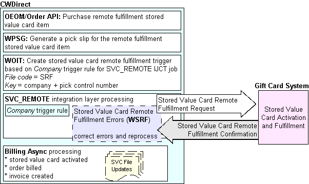

To activate and fulfill a stored value card using a gift card fulfillment system:
1. A customer purchases a stored value card item on an order. To send the stored value card item to the gift card system for activation and fulfillment, the SVC type defined for the stored value card item must be R (Remote Fulfillment Card).
2. During pick slip generation, the system looks at the Company trigger rule defined for the SVC Remote Fulfillment integration layer job and, if the company where the pick slip is generated qualifies, creates an SRF (stored value card remote fulfillment) trigger record in the Working with Outbound Interface Transactions (WOIT) menu option for each stored value card item whose SVC type is set to R.
3. If the SVC Remote Fulfillment integration layer job is active, the system sends a Stored Value Card Remote Fulfillment Request (CWSVCRemoteOut) to the gift card fulfillment system for activation and fulfillment.
4. Once a Stored Value Card Remote Fulfillment Confirmation (CWSVCRemoteIn) is received from the gift card fulfillment system, the system bills the stored value card, creates an invoice for the order, and updates the status of the card to activated.
Stored Value Card Remote Fulfillment Illustration:

To generate the Stored Value Card Remote Fulfillment Request (CWSVCRemoteOut), the system:
1. Creates a remote fulfillment trigger when a pick slip containing a remote fulfillment stored value card item is generated, based on the Company trigger rule defined for the SVC Remote Fulfillment integration layer job.
2. If the SVC Remote Fulfillment (SVC_REMOTE) integration layer job is active, the system looks for unprocessed remote fulfillment triggers to process. The system:
• Looks for remote fulfillment triggers with the File code SRF and a status of ready (R).
• Determines which pick slip to download, based on the Key field for the remote fulfillment trigger. The Key field for remote fulfillment triggers consists of company and pick control number. For example, 5540000345 indicates the pick slip information is located in company 554 for pick slip 345. The system looks for a record in the Pick Control Header file that contains this information.
• Sends each remote fulfillment trigger to the message builder defined for the SVC_REMOTE job.
• For each remote fulfillment trigger, the SVC_REMOTE message builder generates a Stored Value Card Remote Fulfillment Request (CWSVCRemoteOut).
3. The SVC_REMOTE message builder sends the generated Stored Value Card Remote Fulfillment Request (CWSVCRemoteOut) to the outbound queue defined for the SVC_REMOTE job and waits for a response. The Wait time field for the outbound queue indicates how long the system waits for a response.
4. CWIntegrate translates the Remote Fulfillment message into the format required by the gift card fulfillment system and sends the formatted message to the gift card fulfillment system.
5. The gift card fulfillment system receives the formatted request message, activates and fulfills the stored value card, and sends back a response message indicating the stored value card has been activated and fulfilled.
6. CWIntegrate translates the response message into the format required by CWDirect and sends the Stored Value Card Remote Fulfillment Confirmation (CWSVCRemoteIn) to CWDirect.
7. The SVC_REMOTE inbound queue receives the Remote Fulfillment Confirmation and processes the response accordingly.
• If the Stored Value Card Remote Fulfillment Confirmation (CWSVCRemoteIn) does not contain any errors, the system bills the stored value card; see Billing the Remote Fulfillment Stored Value Card.
• If the Stored Value Card Remote Fulfillment Confirmation (CWSVCRemoteIn) contains errors, the system creates a record in the Working with Stored Value Card Remote Fulfillment Errors (WSRF) menu option; see Correcting Remote Fulfillment Confirmation Errors.

Stored Value Card Remote Fulfillment Request Message
The system generates one pick slip for all remote fulfillment stored value card items on the order. A separate pick detail line is created for each order line that contains a stored value card item.

Stored Value Card Remote Fulfillment Response Message
The gift card system returns a remote fulfillment confirmation for the pick slip. A separate CardDetail element is included for each unit of the stored value card item that has been activated and fulfilled.

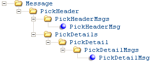

The stored value card remote fulfillment request contains pick slip information for a stored value card item to send to the gift card fulfillment system so that the gift card system can activate and ship the card to the customer.
For more information: See XML Messages for a table that provides links to the DTD, schema, and a sample XML layout for each XML message.

seq_nbr |
numeric |
3 |
A unique number to identify the pick slip message or order header message. Each message type is numbered separately. From the OMS Seq # field in the Order Messages file. |
msg_type |
alpha |
2 |
Indicates whether this is an order header message or pick slip message. Valid values are: OH = order header message PM = pick slip message |
msg |
alpha |
60 (order) or 120 (pick) |
The text of the order header or pick slip message. From the OMS Message field in the Order Messages file. |
The information in this element is stored in the Pick Control Detail file (FLPCTD). See the Display Pick Control Details Screen for more information. Which items included? There is a PickDetail element for each order line available to ship with the pick slip, plus items that are backordered, held, have future arrival dates, or drop ship items. |
company |
numeric |
3 |
The company that generated the pick slip. From the CMP Company field in the Pick Control Detail file. |
pick_nbr |
numeric |
7 |
The pick control number that identifies the pick slip. From the PCH Control # field in the Pick Control Detail file. |
pick_line_nbr |
numeric |
5 |
A unique number to identify the pick slip line number for the item. From the Line # field in the Pick Control Detail file. |
bo_control |
alpha |
1 |
Specifies what action should be taken for this line. Set to C (Ship and cancel remainder) only if the Auto-cancel backorder flag was selected in order entry. Otherwise, the system ship any available quantity and puts the remainder on backorder. From the Backorder control field in the Pick Control Detail file. |
original_qty_printed |
numeric |
5 |
The quantity available to ship on this pick slip. Included only if the item is available to ship (that is, not backordered, held, a future order, or a drop ship item included on a separate drop ship pick slip or purchase order). Included for both the set component and the set master for set items. From the Original qty printed field in the Pick Control Detail file. |
qty_printed |
numeric |
5 |
The same as the original quantity printed. From the Qty printed field in the Pick Control Detail file. |
cart_bin_nbr |
numeric |
3 |
Included only for items with a printed quantity, and if you are Using Cart/Bin Picking. From the Cart bin # field in the Pick Control Detail file. |
line_status |
alpha |
1 |
A status of H indicates that the order line is held. Other statuses are not currently implemented. From the Line status field in the Pick Control Detail file. |
affect_inventory |
alpha |
1 |
Indicates whether shipping this item affects the inventory count. For example, the main set item does not affect inventory, but the set components do. Valid values are: Y = Affect inventory N = Does not affect inventory Not included for items without a printed quantity (held, backordered, drop ship item printed separately, or future arrival date). From the PCD Affect inventory field in the Pick Control Detail file. |
selling_price |
numeric |
7.2 |
The single-unit selling price of the item after applying any repricing or discounts. Not included for set component items, items flagged as “no charge,” or items without a printed quantity. From the PCD Price field in the Pick Control Detail file. |
selling_price_ extended |
numeric |
11.2 |
The selling price times the printed quantity. Not included unless both of these values exist. From the PCD Extension field in the Pick Control Detail file. |
freight_amt |
numeric |
7.2 |
The freight charge for this item on this pick slip. Included only if there is a printed quantity and the source code uses an item-level freight method. See Working with Source Codes (WSRC) for more information. From the PCD Freight charge field in the Pick Control Detail file. |
hand_charge_amt |
numeric |
7.2 |
The total special handling charges for the item. Included only if there is a printed quantity. From the PCD Spec handling $ field in the Pick Control Detail file. |
gift_charge_amt |
numeric |
7.2 |
The total giftwrap charge. Included only if there is a printed quantity. From the PCD Gift charge field in the Pick Control Detail file. |
qty_ordered |
numeric |
5 |
The original quantity ordered for the order detail line. Always included. From the PCD Qty ordered field in the Pick Control Detail file. |
qty_bo |
numeric |
5 |
Included for backordered, held, drop ship, and future arrival items. From the PCD Qty backordered field in the Pick Control Detail file. |
tax_amt |
numeric |
10.5 |
The total tax amount for the item on this pick slip. Included only if there is a selling price included. From the PCD tax field in the Pick Control Detail file. |
gst_amt |
numeric |
10.5 |
The total Canadian GST (goods and services tax) amount, if any, for the item on this pick slip. Included only if there is a selling price included. From the PCD GST field in the Pick Control Detail file. |
pst_amt |
numeric |
10.5 |
The total Canadian PST (provincial services tax) amount, if any, for the item on this pick slip. Included only if there is a selling price included. From the PCD PST field in the Pick Control Detail file. |
order_nbr |
numeric |
8 |
A unique number to identify the order. Always included. From the Order # field in the Pick Control Detail file. |
order_shipto_nbr |
numeric |
3 |
Identifies the shipping address on the order. Always included. From the Ship to # field in the Pick Control Detail file. |
numeric |
5 |
Identifies the order line number, which may be different from the pick slip line number. Always included. From the Seq # field in the Pick Control Detail file. |
item |
alpha |
12 |
A unique code to identify the item. Always included. From the ITM Number field in the Pick Control Detail file. |
item_desc |
alpha |
40 |
The description of the item. Always included. From the Description field in the Item file. |
sku |
alpha |
14 |
The item’s unique characteristics, such as its color and size. Always included if the item has SKU’s. From the SKU Code field in the Pick Control Detail file. |
sku_desc |
alpha |
40 |
The description of the SKU. Always included if the item has SKU’s. From the Description field in the SKU file. |
addl_charge_code |
alpha |
2 |
The additional charge code related to special handling, if any. Always included if the item has special handling. From the ADD Add’l chg code field in the Pick Control Detail file. |
addl_charge_desc |
alpha |
30 |
The description of the additional charge code, if any. Always included if the item has special handling. From the Description field in the Additional Charge file. |
PickDetailMessage Note: This element is included if there are any of the following for the pick detail line: • SKU comments (see the Work with Item/SKU Comments Window) • special handling instructions (see the Display Special Handling Screen and the Display Custom Special Handling Screen) • order line messages (see the Work with Order Line Messages Screen) |
pick_line_nbr |
numeric |
5 |
Identifies the line number of the PickDetail. |
seq_nbr |
numeric |
3 |
A unique number to identify the pick detail message line. Numbering restarts for each separate msg_type. |
msg_type |
alpha |
2 |
Valid values are: • OL = order line message • SC = SKU comments • SH = special handling |
msg_label |
alpha |
Not currently implemented. |
msg |
alpha |
30 |
The message text. |
