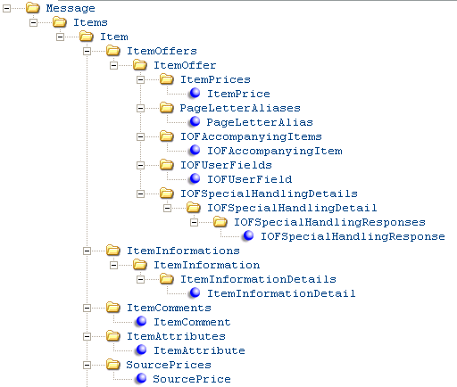

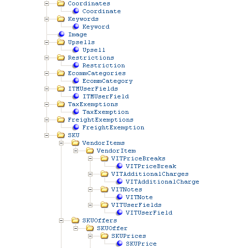

For each item download trigger, the Item Outbound message builder determines which elements to include in the item download message, based on XML inclusion rules.
You can define Item Outbound XML inclusion rules at the Outbound Interface XML Inclusion Screen.
XML inclusion defines which elements to include in the item download message.
• If the element is included, that element and its parents are included in the generated item download XML message.
• If the element is excluded, that element and its children are excluded from the generated item download message.
This table indicates which elements in the item download message are included, based on which elements you flag to include or exclude.
Include element in XML message? |
Element |
Y = Include Item N = Exclude Item and all of its children; the system sends a message with only the Message element and its attributes |
Item |
Y = Include ItemOffer and its parent Item N = Exclude ItemOffer and its children ItemPrice, PageLetterAlias, IOFAccompanyingItem, IOFUserField, IOFSpecialHandlingDetail and IOFSpecialHandlingResponse |
ItemOffer |
Y = Include ItemPrice and its parents, ItemOffer and Item N = Exclude ItemPrice |
ItemPrice |
Y = Include PageLetterAlias and its parents ItemOffer and Item N = Exclude PageLetterAlias |
PageLetterAlias |
Y = Include IOFAccompanyingItem and its parents ItemOffer and Item N = Exclude IOFAccompanyingItem |
Y = Include IOFUserField and its parents ItemOffer and Item N = Exclude IOFUserField |
IOFUserField |
Y = Include IOFSpecialHandlingDetail and its parents ItemOffer and Item N = Exclude IOFSpecialHandlingDetail and its child IOFSpecialHandlingResponse |
IOFSpecialHandlingDetail |
Y = Include IOFSpecialHandlingResponse and its parents IOFSpecialHandlingDetail, ItemOffer, and Item N = Exclude IOFSpecialHandlingResponse |
Y = Include ItemInformation and its parent Item N = Exclude ItemInformation and its child ItemInformationDetail |
ItemInformation |
Y = Include ItemInformationDetail and its parents ItemInformation and Item N = Exclude ItemInformationDetail |
Y = Include ItemComment and its parent Item N = Exclude ItemComment |
ItemComment |
Y = Include ItemAttribute and its parent Item N = Exclude ItemAttribute |
ItemAttribute |
Y = Include SourcePrice and its parent Item N = Exclude SourcePrice |
SourcePrice |
Y = Include Coordinate and its parent Item N = Exclude Coordinate |
Coordinate |
Y = Include Keyword and its parent Item N = Exclude Keyword |
Keyword |
Y = Include Image and its parent Item N = Exclude Image |
Image |
Y = Include Upsell and its parent Item N = Exclude Upsell |
Upsell |
Y = Include Restriction and its parent Item N = Exclude Restriction |
Restriction |
Y = Include EcommCategory and its parent Item N = Exclude EcommCategory |
EcommCategory |
Y = Include ITMUserField and its parent Item N = Exclude ITMUserField |
ITMUserField |
Y = Include TaxExemption and its parent Item N = Exclude TaxExemption |
TaxExemption |
Y = Include FreightExemption and its parent Item N = Exclude FreightExemption |
FreightExemption |
Y = Include SKU and its parent Item N = Exclude SKU and all of its children VendorItem, SKUItemInformation, ItemWarehouse, ContinuityItems, FinishedGood, SetItem, VariableSet, SKUComment, SKUAttribute, UPC, SKUUserField |
SKU |
Y = Include VendorItem and its parents SKU and Item N = Exclude VendorItem and its children VITPriceBreak, VITAdditionalCharge, VITNote, and VITUserField |
VendorItem |
Y = Include VITPriceBreak and its parents VendorItem, SKU, and Item N = Exclude VITPriceBreak |
VITPriceBreak |
Y = Include VITAdditionalCharge and its parents VendorItem, SKU, and Item N = Exclude VITAdditionalCharge |
VITAdditionalCharges |
Y = Include VITNote and its parents VendorItem, SKU, and Item N = Exclude VITNote |
VITNote |
Y = Include VITUserField and its parents VendorItem, SKU, and Item N = Exclude VITUserField |
VITUserField |
Y = Include SKUOffer and its parents SKU and Item N = Exclude SKUOffer and its children SKUPrice, SKUOfferPage, SKOAccompanyingItem, SKOUserField, and SKOSpecialHandlingDetail |
SKUOffer |
Y = Include SKUPrice and its parents SKUOffer, SKU and Item N = Exclude SKUOfferPage |
SKUPrice |
Y = Include SKUOfferPage and its parents SKUOffer, SKU, and Item N = Exclude SKUOfferPage |
SKUOfferPage |
Y = Include SKOAccompanyingItem and its parents SKUOffer, SKU, and Item N = Exclude SKOAccompanyingItem |
Y = Include SKOUserField and its parents SKUOffer, SKU, and Item N = Exclude SKOUserField |
SKOUserField |
Y = Include SKOSpecialHandlingDetail and its parents SKUOffer, SKU, and Item N = Exclude SKOSpecialHandlingDetail and its child SKOSpecialHandlingResponse |
Y = Include SKOSpecialHandlingResponse and its parents SKOSpecialHandlingDetail, SKUOffer, SKU, and Item N = Exclude SKOSpecialHandlingResponse |
Y = Include SKUItemInformation and its parents SKU and Item N = Exclude SKUItemInformation and its child SKUItemInformationDetail |
SKUItemInformation |
Y = Include SKUItemInformationDetail and its parents SKUItemInformation, SKU, and Item N = Exclude SKUItemInformationDetail |
Y = Include ItemWarehouse and its parents SKU and Item N = Exclude ItemWarehouse and its child ITWUserField |
ItemWarehouse |
Y = Include ITWUserField and its parents ItemWarehouse, SKU, and Item N = Exclude ITWUserField |
ITWUserField |
Y = Include ContinuityItems and its parents SKU and Item N = Exclude ContinuityItems and its child ContinuityItem |
ContinuityItems |
Y = Include ContinuityItem and its parents ContinuityItems, SKU, and Item N = Exclude ContinuityItem |
ContinuityItem |
Y = Include FinishedGood and its parents SKU and Item N = Exclude FinishedGood |
FinishedGood |
Y = Include SetItem and its parents SKU and Item N = Exclude SetItem |
SetItem |
Y = Include VariableSet and its parents SKU and Item N = Exclude VariableSet and its children VariableSetGroup and VariableSetItem |
VariableSet |
Y = Include VariableSetGroup and its parents VariableSet, SKU, and Item N = Exclude VariableSetGroup and its child VariableSetItem |
VariableSetGroup |
Y = Include VariableSetItem and its parents VariableSetGroup, VariableSet, SKU, and Item N = Exclude VariableSetItem |
VariableSetItem |
Y = Include SKUComment and its parents SKU and Item N = Exclude SKUComment |
SKUComment |
Y = Include SKUAttribute and its parents SKU and Item N = Exclude SKUAttribute |
SKUAttribute |
Y = Include UPC and its parents SKU and Item N = Exclude UPC |
UPC |
Y = Include SKUUserField and its parents SKU and Item N = Exclude SKUUserField |
SKUUserField |
Y = Include SKUCrossReference and its parents SKU and Item N = Exclude SKUCrossReference |
SKUCrossReference |

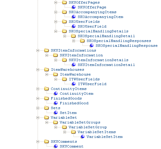

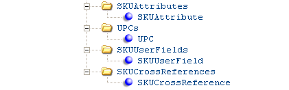

Item Download XML Message (CWITEMOUT)
The item download message contains item and SKU information to send from CWDirect to another system, such as a retail store or warehouse management system.
Message formatting specific to item download:
• Delete transactions contain all elements (based on XML inclusion rules) since an item can be identified using fields other than Item number and SKU code.
• For non-SKU’ed items, the SKU element does not include the SKU_Code attribute. The following elements are not included for non-SKU’ed items:
• SKUOffer and its children, SKUPrice, SKUOfferPage, SKOAccompanyingItem, SKOUserField, SKOSpecialHandlingDetail, SKOSpecialHandlingResponse.
• SKUItemInformations and its children, SKUItemInformation, SKUItemInformationDetails, and SKUItemInformationDetail.
• SKUComments and its child, SKUComment.
• SKUAttributes and its child, SKUAttribute.
• SKUUserFields and its child, SKUUserField.
• If you exclude the element Item and all of its children (using the Item Outbound XML Inclusion rules), the system sends an item download message including the Message element and Items element with no attributes.
For more information: See:
