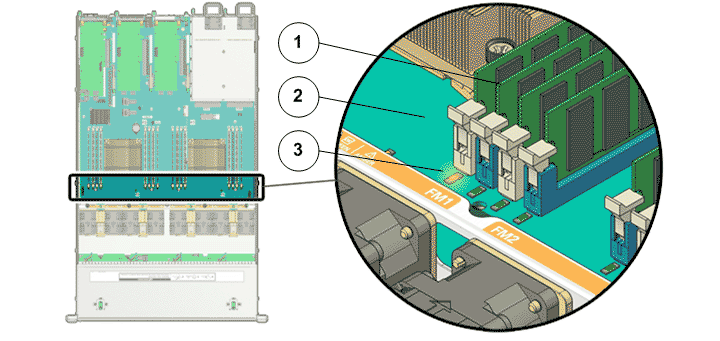

Dual in-line memory modules (DIMMs) provide random access memory (RAM) for the central processing units (CPUs) in the Pilot. A failed DIMM would cause the Pilot to fail and must be replaced as soon as possible.
Before handling a component, touch a grounded surface to discharge any static electricity.
Attach an electrostatic discharge (ESD) wrist strap to your wrist, and stand on an ESD mat while replacing components.
Ensure that all DIMM slots are filled with either filler panels or DIMMs to ensure proper airflow.
Fail over the Pilot before replacing the component using Guided Maintenance.
Figure 1: Location of the DIMMs on the Pilot motherboard
| 1 DIMMs |
| 2 Motherboard |
| 3 DIMM LED |
