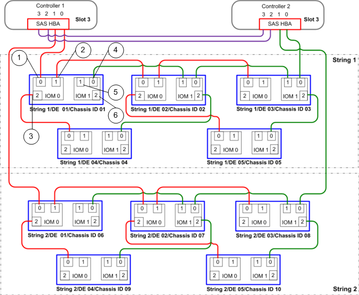

The following figure shows a base system with two strings. In a performance system where three SAS HBAs are installed per Controller, the arrangement of the Drive Enclosures within each string is the same as for base systems. In the following figure, the connections between Controller 1 and I/O module 0 (IOM 0) are shown in red. The connections between Controller 2 and I/O module 1 (IOM 1) are shown in green. The connections between Controller 1 and Controller 2, which mirror the SAS cross connections, are shown in purple.
Figure 1: SAS string topology
 | 1 IOM 0, port 0, always an ingress port connecting from Controller 1, SAS HBA port 0 or port 1, or from IOM 0, port 1 or port 2 of an upstream DE | 4 IOM 1, port 0, always an ingress port connecting from Controller 2, SAS HBA port 0 or port 1, or from IOM 1, port 1 or port 2 of an upstream DE |
| 2 IOM 0, port 1, always an egress port connecting to IOM 0, port 0 of a downstream DE | 5 IOM 1, port 1, always an egress port connecting to IOM 1, port 0 of a downstream DE |
| 3 IOM 0, port 2, always an egress port connecting to IOM 0, port 0 of a downstream DE | 6 IOM 1, port 2, always an egress port connecting to IOM 1, port 0 of a downstream DE |
