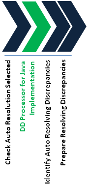

The NetworkIntegritySDK cartridge project contains an abstract discrepancy detection action called Auto Resolve Discrepancies. This abstract action contains the framework for automatic discrepancy resolution.
The Auto Resolve Discrepancies action has the following processors:
Check Auto Resolution Selected: this processor verifies whether a scan is configured with the Auto Resolve Discrepancies option enabled. If enabled, this processor sets a flag to run the next processors.
Identify Auto Resolving Discrepancies: this processor identifies the discrepancies that match the customized implementation.
Prepare Resolving Discrepancies: this processor puts all the identified discrepancies in the DISCREPANCY_SUBMITTED state.
The automatic discrepancy resolution implementation can be completed with either a custom processor or with a properties file. If you complete the implementation with a custom processor, you must create a new discrepancy detection processor in the action that extends the Auto Resolve Discrepancies action.
Figure 7-1 illustrates the processor workflow of the automatic discrepancy resolution solution. The DD Processor for Java Implementation processor is not required for an implementation that uses a properties file.
Figure 7-1 Auto Resolve Discrepancies Processor Workflow
