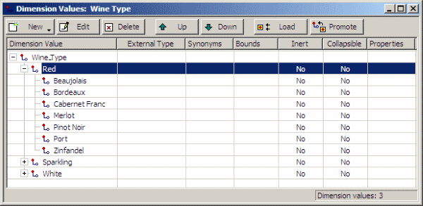

The Dimension Values view displays hierarchical dimension value information about the selected dimension.
In the example below, the Red dimension value has seven child dimension values: Beaujolais, Bordeaux, Cabernet Franc, and so on. The Sparkling and White dimension values also have children, as indicated by the plus sign (+) next to their names.

Open the Dimension Values view from any dimension in the Dimensions view.
To view dimension values for a particular dimension:
In the Dimensions view, select a dimension and click Values. The Dimension Values view opens.
To expand a node in the dimension hierarchy, click the plus sign (+) next to the node's name. To collapse a node, click the minus sign (-). In addition to buttons that allow you to add, edit, delete, or adjust the rank of dimension values, the Load and Promote buttons support two features: editing of auto-generated dimension values and working with externally-generated taxonomies. This view also contains the following columns:
Column Description Dimension Value Lists dimension values in hierarchical order. External Type If the dimension, and its dimension values, were not manually created in Developer Studio, indicates what type of external dimension they are:

Load and promote an auto-generated dimension from within the Dimensions view.
You must use Endeca Workbench and EAC. Endeca Workbench stores temporary copies of auto-generated dimensions. This is the location that Developer Studio retrieves them from during loading.
A dimension must be auto-generated before it can be loaded and/or promoted. This means that you must have already run Forge at least once before attempting to load and promote auto-generated dimensions.
To load and promote an auto-generated dimension:
In Dimensions view, select an auto-generated dimension. Auto-generated dimensions are indicated by this icon:
Click Values to display the Dimension Values view.
You see the root of the auto-generated dimension.
The dimension is populated with the auto-generated dimension values.
The icons next to the promoted dimension values change to indicate that they are now treated as manual dimensions:
Run a baseline update to remove promoted dimensions from auto-generated state files.

Consider an example where Record A is tagged with Merlot from the Wine Type dimension below, and the end-user has searched for "red." Without hierarchical search enabled, Record A would not be returned as part of the search results. With hierarchical search enabled, it would.
Wine Type
Normally, dimension search considers only the text in individual dimension value synonyms when searching for dimension values that match a user's search term(s). With hierarchical search enabled, the MDEX Engine considers ancestor dimension values as well.
To enable hierarchical search during dimension searches:
