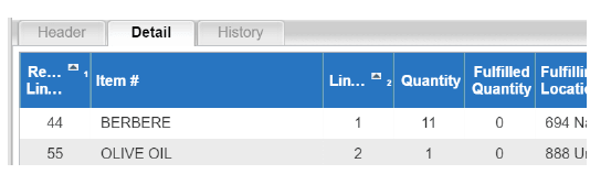

view the items on the order
Click the Details tab.

Details tab
Is line split? Provided the Allow Split Order preference is selected, a line can split if:
         the Allow Split Line preference is selected, and the Routing Engine split a line when initially creating a retail pickup or delivery order, or after the line was rejected by an assigned location; or,
         the Allow Partial Updates preference is selected, and the Routing Engine received a status update for a quantity lower than the current line quantity.
Even if your preferences support splitting lines or partial status update, this does not necessarily mean that the lines on an order will split.
Split lines at Details tab: If any line on the order is split, you need to expand the requesting system line number at the Details tab in order to see and work with the details for all lines and see additional options:
Non-split lines at Details tab: If none of the lines on the order are not split, the details and options are displayed when you open the Details tab:
For more information: See Selecting a Location for a Delivery or Retail Pickup Order for some of the different scenarios that are possible in creating or updating detail lines on retail pickup or delivery orders if you have Order Broker configured to split orders or order lines. Also, see Updating Order Status at the Line or Unit Level for an overview on processing partial status updates for order lines.
Req. Sys. Line # (Requesting system line number)
The line number identifying the order line in the requesting location. From the line_item_no passed in the submit order message. A single line from the requesting system can create multiple order lines in Order Broker if the Allow Split Line preference is selected. Also, a line can split as the result of a partial status update if the Allow Partial Updates preference is selected.
Even if a line is not split in Order Broker, the requesting system line number can be different from the line number in Order Broker. For example, this situation can occur if the placed (originating) location sends only the third line on a multi-line order to Order Broker; in this case, the line number in Order Broker is #1.
If split: If any lines on the order are split, you need to expand the line to see additional details and options. Click the plus sign next to the requesting system line number to expand:
Line #
The order line number assigned by Order Broker. May be different from the requesting system’s line number if the system did not send all of the order lines to Order Broker for fulfillment and the version specified in the submit order message was lower than 3.0, or if an order line is split.
If split: If any of the lines on the order are split, the Item # is before the Order Broker Line # and is always displayed, even if you have not expanded the line by clicking the plus sign next to the Req. Sys. Line # (Requesting system line number); however, the Line # and other fields are not displayed until you click the plus sign.
