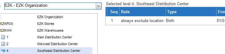

review the levels for rule assignment or review
1.      The organization associated with your Default Shipping System is selected by default. A blue arrow (rule_assigned_icon.png) next to the organization name indicates if there are any rules assigned at any level within the organization. Optionally, you can select a different organization.
2.      Optionally, click the plus sign next to the organization to display each Location Type for the organization if they are not already displayed. Again, a blue arrow next to the location type name indicates if there are any rules assigned at any level within the location type.
         If the organization includes a location type that does not include any locations, the location type is not displayed.
         You might need to increase the zoom in your browser in order to display the blue arrows.
         The hierarchy may not be displayed correctly until you assign a default shipping system to the default admin user. See Assign the default shipping system to the default user for more information.
3.      Optionally, click the plus sign next to a location type to display each Location for the type if they are not already displayed. A blue arrow next to a location indicates if there are any rules assigned to that particular location.
Sort order: This screen sorts all displayed records in alphanumeric order within each organization. In other words, organizations are listed alphanumerically by name, as are location types within an organization, and locations within a location type. Since the sort is alphanumeric, numeric codes are listed before alphabetical codes; for example, location 123 is listed before location ABC.
select location type or location for rule assignment or review, or select a different organization

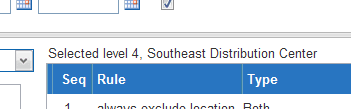

Highlight the location type or location to display the rules that are currently assigned at that level, or select a different organization from the drop-down list.
Note that the currently selected location level is indicated above any assigned rules.

Rule assigned? A blue arrow (rule_assigned_icon.png) next to the organization, location type, or location indicates if there are any rules assigned at that level or below.
Note:  To refresh the display of the blue arrows based on your activity at this screen, close the Probability Location screen and re-enter.
Selected level
When you highlight an organization, location type, or location in the left-hand pane, the code and description are displayed in the center of the screen above any rules that apply to the selection.
