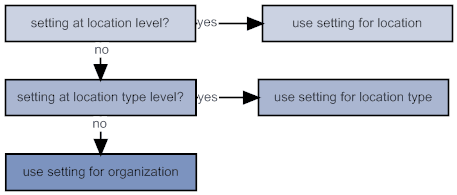

Applying a preference: Set each preference at the lowest level in the hierarchy where it should apply. When determining the preference for an individual location, Order Broker uses the first defined preference it finds, starting at the location level and then working up to the location type level, then finally the organization level. For example, if you set a preference to Not Defined at the location level, the setting at the location type level applies.
Example:  |
		Required result: All US stores should use proximity locator logic except for the Natick store. The US store locations are assigned to the location type of US Store. Correct preference settings: Set Use Proximity Locator for US Stores to Yes, but set it to No for the Natick store location only.  |
