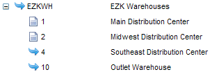

		 by default. A blue arrow (

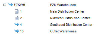

		2. Optionally, click the plus sign next to the organization to display each Location Type for the organization if they are not already displayed. Again, a blue arrow next to the location type name indicates if there are any rules assigned at any level within the location type.
		Note: • If the organization includes a location type that does not include any locations, the location type is not displayed. • You might need to increase the zoom in your browser in order to display the blue arrows. • The hierarchy may not be displayed correctly until you assign a default shipping system to the default admin user. See Assign the default shipping system to the default user for more information.  |
		3. Optionally, click the plus sign next to a location type to display each Location for the type if they are not already displayed. A blue arrow next to a location indicates if there are any rules assigned to that particular location.

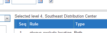

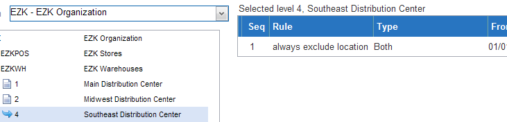

		Highlight the location type or location to display the rules that are currently assigned at that level, or select a different organization from the drop-down list. Note that the currently selected location level is indicated above any assigned rules.  |
