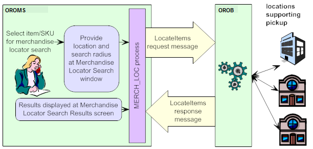

Searching for Pickup Locations Only (Message Version 3.0 or 3.1)
Overview: A typical process of inquiring on locations where an item is available for pickup is described below.
Used when? This process applies when the CW_LOCATE_MESSAGE_VERSION specified in Working with Customer Properties (PROP) is 3.0 or 3.1 for integration with those releases of Oracle Retail Order Broker.
1.
A customer wants to know if an item/SKU is available for pickup at a nearby store. You select the item/SKU for merchandise locator inquiry. This option is available in order entry, order maintenance, and at the Display Item Availability Screen.
2.
You advance to the Merchandise Locator Search Window (Searching for an Item), where you provide or confirm the customer’s geographic location, and the radius to search within (for example, search all stores within 25 miles of the customer’s home).
Note: The Order Broker supports merchandise locator searches only in the U.S. and Canada.
3.
In the background, the MERCH_LOC integration layer process:
• Generates the LocateItems request message and sends it to an external system such as Oracle Retail Order Broker. Oracle Retail Order Broker checks the availability of the item in stores that stock the item/SKU within the search area.
• Receives the LocateItems response returned by Oracle Retail Order Broker. This message lists the item/SKU’s current or estimated availability in each searched location that stocks the item.
4.
You advance to the Merchandise Locator Search Results Screen, displaying the item/SKU’s availability in each of the locations, including information on any open purchase orders.
How does Oracle Retail Order Broker select the locations to include? Only store locations flagged as Pickup available can be included in the search results. Also, Oracle Retail Order Broker uses any probability rules you have set up to determine whether to include locations in the results, and the available quantity to indicate. For example, you might set up a probability rule for certain locations indicating to exclude them if the available quantity falls below 5 units, or to reduce the available quantity returned in the response message by 10%.
What information does Oracle Retail Order Broker return for each location? For each location included in the search results, Oracle Retail Order Broker indicates:
• the available quantity, next purchase order date, and next purchase order quantity
• the name, address, and phone number of the location.
• the distance from the search address:
- locations are sorted in ascending order by distance (closest location listed first)
- locations that are not flagged to Use Proximity Locator are listed without a distance
See the Merchandise Locator Search Results Screen and the Sample LocateItems Messages (Message Version 3.0 or 3.1) for more information.

• available_qty: see the Pickup avail qty field for more information.
• next_po_qty: see the Open PO qty field for more information.
• po_dt: see the Next PO date field for more information.
• fulfillment_type:
- PICKUP = the location is flagged in Oracle Retail Order Broker as Pickup Available, but not as Shipping available;
- OTHER = the location is flagged in Oracle Retail Order Broker as both Pickup Available and either Shipping Available or Transfer Available
Note: If the location is not flagged as Pickup Available, it is not eligible for inclusion in the response message to Oracle Retail Order Management System.
• location name and address: the information entered in Oracle Retail Order Broker for the location

Sample ProductAvailability Messages (Message Version 5.0+)
Sample Product Availability request and response messages are provided below, along with notes on the information included in each message. Oracle Retail Order Management System generates the Product Availability request for a merchandise locator search if the CW_LOCATE_MESSAGE_VERSION specified in Working with Customer Properties (PROP) is 5.0 or higher.
For complete documentation on these messages, see the Oracle Retail Order Broker Operations Guide.
Logged where? Oracle Retail Order Management System does not log these messages; however, they are available for review in Oracle Retail Order Broker’s XML log file. See the Oracle Retail Order Broker Operations Guide for more information.
Not used when creating a pickup order: When you create a pickup order in order entry by selecting the Store Pickup option, Oracle Retail Order Management System uses the LocateItems request message to search for store locations where the customer can pick up the order, regardless of the version specified in the Oracle Retail Order Broker Properties.
Sample Product Availability Request Message
The information in this message includes:
• version: from CW_LOCATE_MESSAGE_VERSION in Working with Customer Properties (PROP)
• destination: from the OROB Account (K49) system control value
• location code: from the OROB Default Location (K51) system control value
• system code: from the OROB System (K50) system control value
• type: the request includes both a fulfillment_type with a type of DELIVERY, and a fulfillment_type with a type of PICKUP
• range_distance: from the distance entered in the Search within field at the Merchandise Locator Search Window (Searching for an Item)
• range_unit: from the Merchandise Locator Distance Measurement (I39) system control value
• item ID: always indicates the Oracle Retail Order Management System item and SKU code, regardless of the setting of the OROB Product Code ID (K66) system control value
• qty: the Search quantity entered at the Merchandise Locator Search Window (Searching for an Item)
• address information: from the address information entered at the Merchandise Locator Search Window (Searching for an Item)
