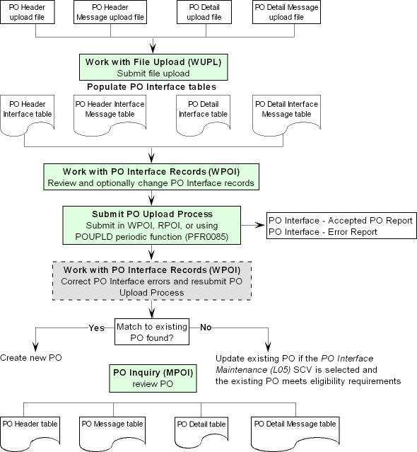

PO Upload Process
Instructions: Use the following steps to upload PO information from an external system.
1.
Create a PO text file for the purchase order information you wish to upload.
You can use the sample data below to create the PO upload text files.
PO Header upload file:
7|416151|REF416151||1150501|N|1150425|1150416|N|1150430|THOMAS BROWN|N||V416151|SHIP INSTRUCTIONS|I|BTM|7|5|7|1|USR1|USR2|USR3|USR4
PO Header Message upload file:
7|416151|1|P|PO HEADER MESSAGE LINE 1
PO Detail upload file:
7|416151|1|1||1150425|100|25.0000|1150430|1150416|RF123SKU4567|ROSE XSML WMNS|EA|7|5|1
PO Detail Message upload file:
7|416151|1|1|P|PO DETAIL MESSAGE LINE 1
Note: If you wish to leave any field in the upload file blank, pass a space in the field so that the file can be processed without errors. Leaving a field with no space is interpreted as null in the database and causes errors.
2.
Once the text files are ready to upload, use the Working with File Uploads (WUPL) menu option to upload the records in the text files to the PO Interface tables in the Oracle Retail Order Management System database.
• PO Header Interface Table (IXPHDP): Each record in this table represents a separate PO.
• PO Header Interface Message Table (IXPHMP): Each record in this table represents a separate PO Header message for the specified PO.
• PO Detail Interface Table (IXPDTP): Each record in this table represents a separate PO line for the specified PO.
• PO Detail Interface Message Table (IXPDMP): Each record in this table represents a separate PO Detail message for the specified PO and PO line.
3.
Review, and optionally change, the records in the PO Interface tables in the Working with PO Interface Records (WPOI) menu option.
4.
When you are ready to upload the records from the PO Interface tables, use the Work with PO Interface Records Screen or Rerun PO Interface Edit Screen to submit the PO upload process.
Note: You can also schedule the PO upload process to run periodically by setting up the POUPLD periodic function using the PFR0085 program. See Scheduling Jobs for background.
See Creating a New PO through the PO Upload Interface and Maintaining an Existing PO through the PO Upload Interface for processing details.
