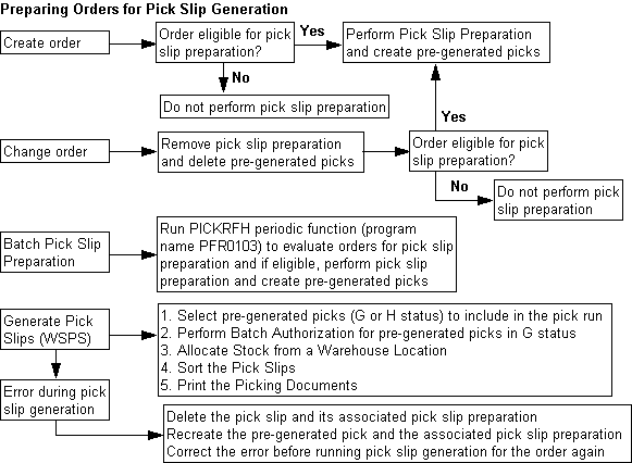

Preparing Orders for Pick Slip Generation
Pick slip preparation prepares an order for fulfillment when you create or change an order, such as creating pre-generated picks in the Pick Control Header and Pick Control Detail tables and defining whether the pre-generated picks require authorization. Preparing the order for pick slip generation in advance reduces the time it takes to run Streamlined Pick Slip Generation (WSPS) to fulfill and print the picking documents.
Pre-generated picks are picks created prior to running pick slip generation for an order. The status of a pre-generated pick is either G Generated No Authorization, indicating the pick requires authorization during pick slip generation, or H Generated Has Authorization, indicating the pick can bypass authorization during pick slip generation. Pick slip generation selects pre-generated picks to fulfill and print based on the pick slip selection criteria specified.
Pick slip preparation process:
Standard pick slip generation: You cannot use standard pick slip generation (WPSG) for orders that are eligible for pick slip preparation; you must use Streamlined Pick Slip Generation (WSPS) to complete the pick slip generation process.

Batch Pick Slip Preparation
The PICKRFH Pick Gen Refresh periodic function (program name PFR0103) allows you to submit a process that evaluates orders for pick slip preparation, and if eligible:
1. Removes any pick slip preparation that may have already occurred for the order; see Removing Pick Slip Preparation from an Order for the updates that are performed.
2. Applies pick slip preparation to the order; see Applying Pick Slip Preparation to an Order for the updates that are performed.
Use this periodic function to:
• Initially prepare existing orders for pick slip generation; see Converting Orders to Pick Slip Preparation.
• Perform pick slip preparation for orders that initially were not eligible for pick slip preparation (for example, the order had a future arrival date).
See How to Schedule a Job for instructions on assigning this periodic function to a periodic process and to schedule when the process runs. Run this periodic function on a daily basis.
For orders that qualify for pick slip preparation, the system performs the following updates.
• Creates Pre-Generated Picks
• Updates Reserved Order Lines for the Order
• Updates Authorizations for the Order
For more information: See Selecting Order Lines for Pick Slip Preparation and When is Pick Slip Preparation Performed? for more information on determining when an order line is eligible for pick slip preparation, and when the system performs pick slip preparation.
When creating pre-generated picks for an order, the system performs the following updates.
