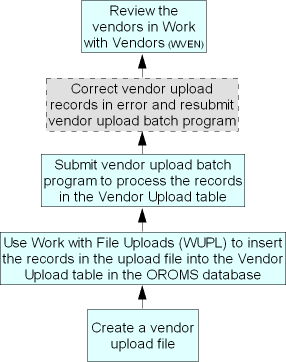

Vendor upload process:
Note: You can also schedule this process to run periodically by setting up the VNUPLD function using the PRF0086 program. See Scheduling Jobs for background.

• Create Vendor Upload File
• Transfer the Vendor Upload File to Order Management System
• Submit Vendor Upload Screen
• Vendor Upload Process
