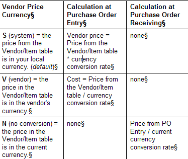

Vendor price currency
Indicates whether the prices from this vendor are in the system's currency or the vendor's own currency and controls how and when currency conversion takes place.
Note: If this field is set to N or V, you must define vendor items in the Vendor Item table for the system to calculate the cost at the time of receiving.
If you override the currency rate during Purchase Order Receiving, the system uses the following calculation:
Price from Purchase Order Entry/current currency conversion rate.
Note: The Supplier Direct Fulfillment integration does not support currency conversion.
Alphanumeric, 1 position; required.
