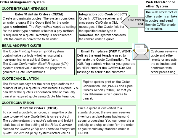

Quote Illustration:

Use the Enter/Maintain Orders (OEOM) menu option to create and maintain a quote. The system uses the Quote field on the order type to identify the order as a standard order or a pre-order quote.
• If the Quote field for the order type is selected, the system identifies the order as a pre-order quote.
• If the Quote field for the order type is unselected, the system identifies the order as a standard order; see Entering Orders.
Receiving a quote through the generic order interface: You can create a pre-order quote on the web storefront and send the quote information to Order Management System using the Generic Order Interface (Order API). See Creating a Quote through the Order API.
Maintaining quotes: You can use the standard Order Inquiry/Maintenance (OIOM) menu option to maintain and inquire on a quote. See Maintaining Quotes in Order Maintenance.

Completing a Quote
When you finish entering the quote, you can either:
• Accept the quote.
• Reject the quote.
Rejecting a Quote
When you select Reject Order, the system looks at the setting of the Capture Order/Call Disposition (K03) system control value to determine how to proceed.
• If this system control value is set to ORDER or ALL, the system advances you to the Confirm Order/Call Disposition Window where you must enter a reject reason code explaining why you are rejecting the quote. In addition, the system creates a record in the Order Disposition Table so that you can track order/call disposition activity; see Tracking Order/Call Disposition Activity.
• If this system control value is set to NONE or blank, the system advances you to the Confirm Reject Window where you must select OK in order to proceed with the quote rejection.
Accepting a Quote
When you select Accept Order:
1.
The system verifies the accuracy of all quote information and, if the Pay method required field for the order type is selected, ensures that you have defined some method of payment.
2.
The system adds the new quote immediately to the Order tables; it becomes available for Order Maintenance and standard or streamlined Order Inquiry.
3.
The system selects the Quote Origin field on the Work with Order Ship to Properties Screen to indicate the order originated as a pre-order quote. The system retains this setting when you convert the quote to an order.
4.
If the Override Freight on Quote Conversion (K76) system control value is selected, the system applies the freight and additional freight charges on the quote as a freight override. You can review the freight and additional freight charges on the quote in the Freight override field on the Work with Order Ship to Properties Screen.
5.
The system assigns the price override reason code defined in the Price Override Reason for Quotes (K75) system control value to each detail line that does not already have a price override reason defined.
6.
The system assigns an expiration date to the quote and each item on the quote if a number of days has been entered in the Expiration days field for the order type on the quote; see Assigning an Expiration Date to a Quote.
7.
The system sends the credit card payment method on the quote to the authorization service if you are set up to perform online credit card authorizations; see Performing Online Credit Card Authorizations.
8.
A scrolling message similar to the following displays at the bottom of the screen: Finalizing order, Finalizing order.
9.
The system advances you to the Print/Email Quote Window, where you can select to print the Quote Form or generate the Quote Confirmation email.
10.
Several updates occur; see Quote Entry Updates.
The Expiration days field for the order type on the quote indicates the number of days a pre-order quote is valid before it expires.
When you accept a pre-order quote in order entry or maintenance, the system updates the Cancel date for the quote based on the quotes arrival date and the expiration days. The system removes the cancel date when you convert the quote to an order.
The system uses the following calculation to assign a cancel date to a quote:
Quote arrival date + Order type Expiration days = Quote expiration date
The system stores the quote expiration date in the Cancel date field in the Order Header table and Order Detail table.
Example: If the arrival date for a quote is 10/29/09 and the expiration days defined for the quote order type is 30, the system updates the Cancel date for the quote to 11/28/09.
If you change the order type on a quote: If you change the order type on a quote to another order type whose Quote field is selected, the system recalculates the cancel date for the quote, based on the number defined in the Expiration days field for the new order type. If an Expiration days has not been defined for the new order type, the system removes the cancellation date from the quote.
Manually entering a cancel date: If you manually enter a date in the Cancel date field on the Work with Order screen or Work with Order Line screen, the system uses this date instead of the calculated quote expiration date.
Adding an item in order maintenance: If you add an item in order maintenance, the system assigns the cancel date defined on the order header to the new order line.
Note: If you change the Expiration days field for the order type, the system applies the new expiration days to new quotes entered and does not update the expiration date for existing quotes.
Expired quotes: Once the cancel date has been reached, the quote prints on the Order Cancellation List. Customer Service uses this list to contact each customer to see if the deadline can be extended. If not, Customer Service must use Order Maintenance to cancel the quote. See Cancelling a Quote through Order Maintenance.
Use this window to print the Quote form or generate the Quote Confirmation email.
If you maintain a quote: If you maintain a quote after printing the Quote form or generating the Quote Confirmation email, and the estimated order totals for the quote change as a result of your changes, you should resend the Quote form or Quote Confirmation to the customer so that the customer has the most recent estimated totals for the quote.
Order history: When you generate the Quote Confirmation email, the system creates an order history message, indicating the email was sent; for example: 10/28/09 LETTER Quote Conf to kbottger@commercialware.co
How to display this screen:
• Select Accept to perform the final accept for a pre-order quote during order entry or maintenance, or
• Select the Print/Email Quotes option on the Display More Options Screen.
Note: This window does not open if:
• The Quote Printing Program (K73) and Quote Confirmation Email Program (K74) system control values do not contain a value, or
• All of the items on the quote are soldout and the Exclude S/O on order confirmation field for the order type on the quote is selected.
Field
Description
Print Quote
Indicates whether you wish to print the Quote form for the pre-order quote. Note: The system prints the Quote form based on the quote totals at the time you select to print the Quote form.
• Selected = Print the Quote form.
• Unselected = Do not print the Quote form.
This field displays only if the Quote Printing Program (K73) system control value contains a value.
See Quote Form for a sample of the form and a description of the contents on the quote form.
Email Quote
Indicates whether you wish to generate the Quote Confirmation email for the pre-order quote. Note: The system generates the Quote Confirmation based on the quote totals at the time you select to email the Quote Confirmation.
• Selected = Generate the Quote Confirmation email. See Quote Confirmation Emails and Quote Confirmation Email Sample and Contents.
• Unselected = Do not generate the Quote Confirmation email.
Order Management System generates a generic outbound XML message, rather than an actual email, for quote confirmations if the XML only? flag for the quote confirmation template is selected. The Outbound Email XML Message (CWEmailOut) includes additional information that is not included in the standard email notice. See Outbound Email API for an overview and message details.
This field displays only if an email address is defined for the order or sold to customer and the Quote Confirmation Email Program (K74) system control value contains a value.
Screen Option
Procedure
Print the Quote form and generate the Quote Confirmation email, based on the fields selected
Select OK. The system prints the Quote form and generates the Quote Confirmation email based on the fields you selected.
See Quote Form for a sample Quote form and see Quote Confirmation Email Sample and Contents for a sample Quote Confirmation.
The system returns you to the Select Customer Sold To screen or Customer Selection screen where you can enter another quote or standard order.
