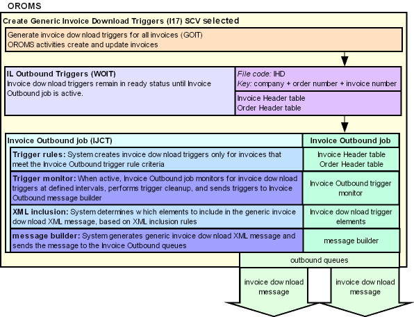

Purpose: Order Management System allows you to capture invoice information to download to another system, such as a retail store or financial system.
Invoice information flow: This flowchart explains how invoice information is downloaded from Order Management System.

The system creates invoice download triggers in the IL Outbound Trigger table when an invoice or credit invoice is created. The Invoice Outbound job in the Working with Integration Layer Processes (IJCT) menu option monitors the IL Outbound table for invoice download triggers to process and generates an Invoice Download XML Message (CWInvoiceOut) to send to the remote system.
Identifying Invoice Download Triggers
You can view all download triggers in the IL Outbound Trigger table at the Work with Outbound Interface Transactions Screen.

Invoice Download Processing
To generate an Invoice Download XML Message (CWInvoiceOut), the system:
1. Creates invoice download triggers, based on Order Management System activities that create an invoice. See Invoice Outbound Trigger Activities for a list of the activities that create invoice download triggers.
2. Evaluates the trigger rules for the Invoice Outbound job to determine if the invoice download trigger is created. Invoice Outbound Trigger Rules define the criteria the invoice must meet in order for the system to create an invoice download trigger.
3. When active, the job’s trigger monitor looks for unprocessed invoice download triggers to process at defined intervals, based on the Outbound delay time.
The Invoice Outbound trigger monitor:
• looks for invoice download triggers with the File code IHD and a status of ready (R).
• removes duplicate invoice download triggers. See Invoice Trigger Cleanup.
• determines which invoice to download, based on the Key for the invoice download trigger. The Key for invoice download triggers consists of company + order number + invoice number. For example, the Key 555000063970001713 indicates the invoice information is located in company 555 for order number 6397 and invoice number 1713.
• sends each invoice download trigger to the job’s message builder.
4. For each invoice download trigger, the message builder determines which elements to include in the invoice download message, based on XML inclusion rules; see Invoice Outbound XML Inclusion.
5. The Invoice Outbound message builder sends the generated invoice download messages to the queues defined for the Invoice Outbound job whose Enabled field is selected. See Outbound Interface Queues.

Invoice Download Setup
Before you can generate invoice download messages, you must perform the necessary Order Management System setup and processing.
Information requiring setup includes:
• System Control Values
• Menu Options
• Periodic Function
Description
Create Generic Invoice Download Trigger Records (I17)
Select this field to create invoice triggers in the IL Outbound Trigger table for certain actions in Order Management System.
Outbound Interface Trigger File Purge Days (I14)
Enter the number of days to retain records in the IL Outbound Trigger table before purging them. Run the PURGIJT periodic function (program name ILR0026) to delete any records if: Last processed date is less than the current system date by the number of purge days and Status is X. You can also use the Purge option at the Work with Outbound Interface Transactions Screen to purge records.
Example: Today is 2/07 and you have set this value to 1. Any record whose Last processed date is 2/06 or earlier is purged.
Include Credit Card Info in Invoice Out XML (M30)
Select this field if you want to include the ipm_credit_card_nbr and ipm_cc_expiration_date in the Invoice Download XML message (CWInvoiceOut); otherwise, unselect this field to remove these tags from the message.
Menu Options
Menu Option
Description
Generating Outbound Interface Triggers (GOIT)
Allows you to create an IL outbound trigger record for each invoice in your company. Run this process to initially send invoices to the remote system.
Working with Outbound Interface Transactions (WOIT)
Allows you to review, delete, or resend IL outbound trigger records.
When active, the Invoice Outbound job creates an Invoice Download XML Message (CWInvoiceOut) for each unprocessed invoice trigger in the IL Outbound Trigger table.
You can also define:
• trigger rules; see Invoice Outbound Trigger Rules.
• XML inclusion rules; see Invoice Outbound XML Inclusion.
• the queues where the invoice download message is sent; see Work with Integration Layer Process Queues Screen.
Periodic Function
Periodic Function
Description
Purge IJCT Download (program name ILR0026)
Run this periodic function to purge processed IL outbound triggers, based on the setting of the Outbound Interface Trigger File Purge Days (I14) system control value: Last processed date is less than the current system date by the number of purge days and Status is X
