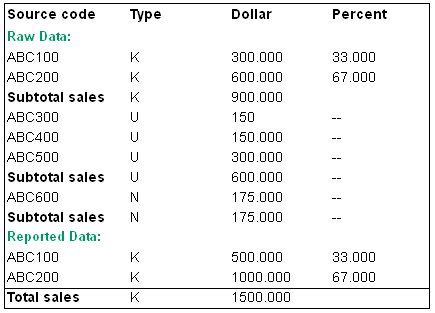

To total the sales on the Source Code Profit Analysis report, the system first calculates the percentage of the total sales for each type K source code. Sales for the type U source codes are then divided based on these percentages and added proportionately to the type K source codes. Type N (unknown) sales are not added.
The chart below illustrates how sales are calculated.
In the table above, the sales for all type K source codes is 900.00. The percentage of total sales is 33% from source code ABC100 and 67% from source code ABC200.
The total sales for type U source codes is $600.00. 33% of type U sales ($200.00) is added to the sales from source code ABC100. 67% ($400.00) is added to the sales from source code ABC200.
The reported sales for sales from ABC100 becomes $500.00.
The reported sales from ABC200 becomes $1000.00.
The total type K reported sales becomes $1500.00.

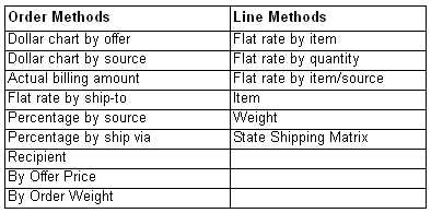

A code that determines how freight charges will be calculated for this source code. Order-level and line-level freight methods are below.
See Freight Charges for a description of each freight method and set up instructions.
Order-level freight methods:
Dollar chart by offer ($ Chart by Ofr): Allows you to charge freight based on the dollar amount of the merchandise ordered for each shipping address on an order. The dollar tier levels and the corresponding freight charges are defined for each offer. See Dollar chart by offer ($ Chart by Ofr) freight for more information.
Dollar chart by source ($ Chart by Src): Allows you to charge freight or service charges based on the dollar amount of the merchandise ordered for each shipping address on an order. The dollar tier levels and the corresponding freight or service charges are defined for each source code. See Dollar chart by source ($ Chart by Src) freight for more information.
Actual billing amount (Actual Bill Amt): Uses the total weight of all the items on the order and the shipper to determine the actual freight charge during Confirmation or Billing. See Actual billing amount (Actual Bill Amt) freight for more information.
Flat rate by ship-to (Flat Rt/Ship To): Uses the flat freight fee defined for the source code (Flat freight rate field) for the source code. See Flat rate by ship-to (Flat Rt/Ship To) freight for more information.
Percentage by source (% Source): Multiplies the merchandise amount of the order by the percentage in the Freight% field for the source code. See Percentage by source (% Source) freight for more information.
Percentage by ship via (% Ship Via): Multiplies the merchandise amount of the order by the percentage in the Freight percent field in the Ship Via table. See Percentage by ship via ($ Ship VIa) freight for more information.
Recipient: Calculates freight by dollar based on the merchandise total of the order including all recipient orders. The Maximum number of ship to’s field defined for the source code is checked. If the number of recipients on the order is less than or equal to this value, the Dollar Chart by Offer will determine the freight fee, based on the merchandise total.
Once the maximum number of recipient orders is reached, the system includes a flat amount with the freight amount for each additional recipient order. See Recipient freight for more information.
Freight by offer price (By Offer Price): Uses the Dollar Chart by Offer to calculate freight, based on the total merchandise value of the order. For this freight method, the merchandise value is calculated by adding the extended single-unit offer price for each item/SKU, disregarding any discounts, associate pricing, price overrides, quantity break pricing, etc. See By Offer Price freight for more information.
Freight by order weight (Order Weight): This freight method is based on the total weight of the order and the number of cartons required to ship the order. See Freight by order weight (Order Weight) freight for more information.
Line-level Freight Methods:
Flat rate by item (Flat Rt/Item): Allows you to charge one freight amount per item, regardless of the quantity ordered of the item. The Freight is defined for each item in the associated Item Offer (default) or SKU Offer table. The freight total represents the accumulation of each item's flat freight fee. See Flat rate by item (Flat Rt/Item) freight for more information.
Flat rate by quantity (Flat Rt/Qty): Allows you to charge a flat rate for a certain number of units ordered and add an additional charge for each unit thereafter. See Flat rate by quantity (Flat Rt/Qty) freight for more information.
Flat rate by item source (Flat Rt/Itm Src): Uses a flat freight charge for each unit ordered multiplied by the number of units ordered. See Flat rate by item source (Flat Rt/Itm Src) freight for more information.
Item (By Item): Uses the freight charge defined in the Item Offer record, multiplied by the quantity ordered. See Item (By Item) freight for more information.
Weight: Uses the weight of each item (defined in the Item or SKU table) and the rate for the shipper. The weight of the item is multiplied by the quantity ordered to calculate the total weight for the order line. In order to determine the freight charge, the system references the associated rate chart for each line, based on the total weight and delivery zone. See Weight freight for more information.
Required.
