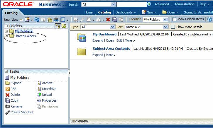

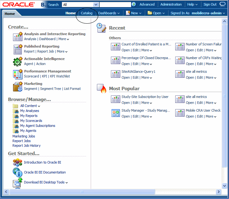

To customize a standard Alert:
Sign in to Oracle Business Intelligence Enterprise Edition.

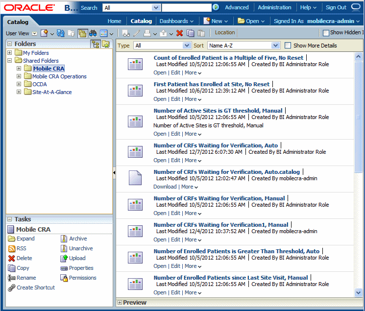

In the global header, click Catalog to display the Catalog page.
Click Shared Folders.
Click the Mobile CRA folder.
All the standard alerts are displayed in the right-hand pane. Navigate to the alert you want to edit and click the Edit link. The alert is displayed in the Analysis Editor.

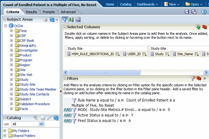

Navigate to the Criteria tab.
On the left-hand side, the Subject Area pane displays OCDA subject area and its hierarchical columns.
On the right-hand side upper section, the Selected Columns pane shows the name of the column's folder (for example, Site-Name) and name of the column (for example, Site_Name).
On the right-hand side lower section, the Filters pane shows filters to create or edit filters for the alert.
Drag and drop columns from the left-hand side Subject Area pane to the Selected Columns pane to modify the alert.
Click the Filter option to edit filters of the alert for the specific column or click Filter in the Filter pane header.
Click OK to save the filter.

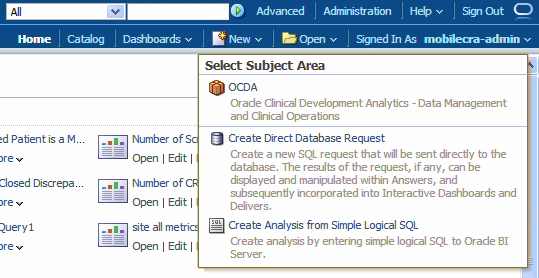

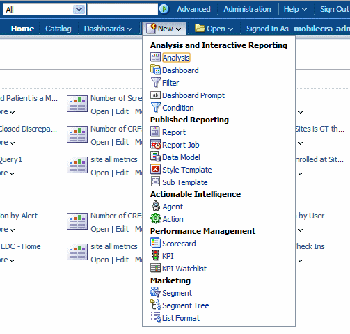

To create a new alert, perform the following steps:
In the global header, click New, then Analysis.
Click OCDA in Select Subject Area menu.

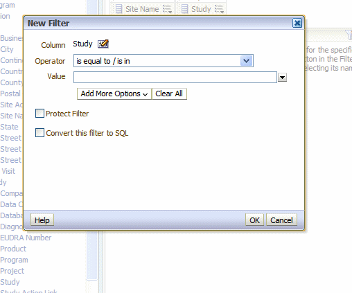

Click the Filter option to add filters to the alert for the specific column or click Filter in the Filter pane header.
Specify the filter condition in New Filter dialog box.

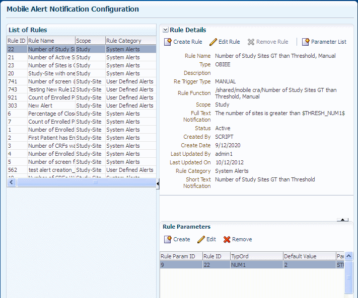

Getting to the Mobile Alert Notification Screen:
Click Alert Notification in left pane of the Home page to reach the Mobile Alert Notification Configuration Screen.
The Rule management module lets you manage Rule definitions and corresponding thresholds. To manage a rule, select the alert name from the navigation panel. When you select a rule, the right pane displays the Rule definition form, which consists of the rule parameters and rule thresholds.
The Rule definition form lets an administrator create, update, or delete a rule based on the business rules defined for the Rule category.
Figure 2-11 represents the basic UI layout for rules and alerts. The left pane displays a list of all rules (which can be sorted). The right upper pane displays rule details and right lower pane displays Rule Parameters with default values.
When you select a rule in the left pane, the right pane displays the information for that particular rule. The toolbar icons are for specific Create, Edit, and Remove operations.
The following fields of rules are displayed in the Rule Details pane:

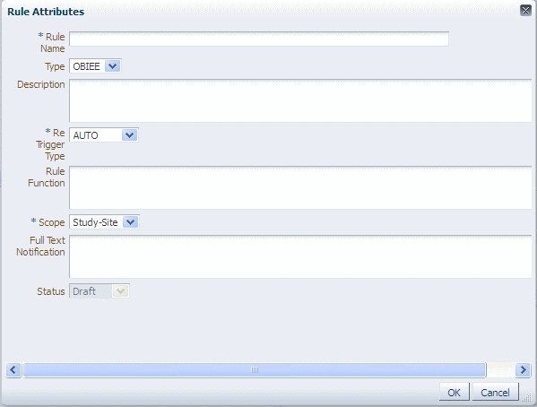

To create a new rule and its thresholds, perform the following steps:
The default category for a new user-defined rule is User Alert.
Click Create Rule in Rule Details pane.
Enter requisite fields in the Rules Attributes screen.
Click OK to create the rule.

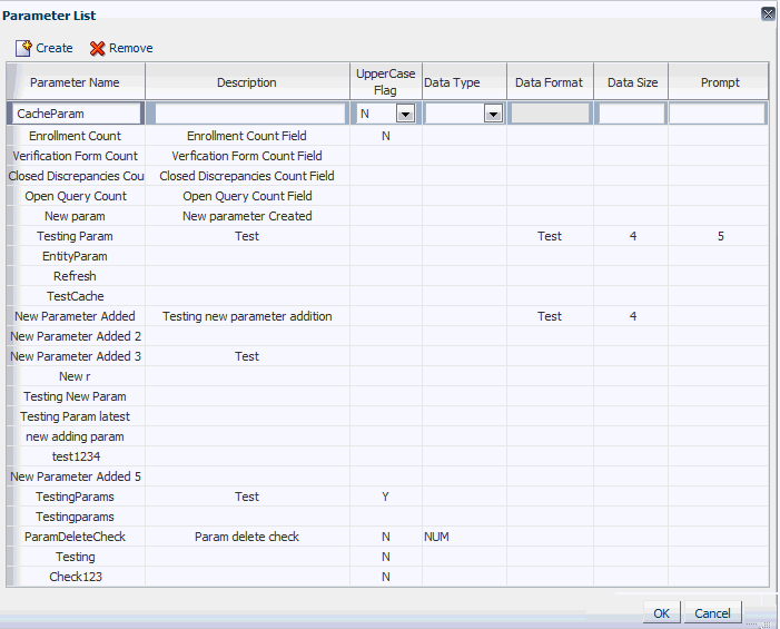

Parameters list lets you manage the standardized list of parameters that are used in the Rule definitions. The interface lets you create and remove existing parameter definitions.
The Rule Parameters list supports the following key operations:
Create - The Create icon lets you create a new Rule Parameter definition. When you click it, it displays the list of attributes required for creating a new Rule Parameter definition.
Delete - The Delete icon lets you delete a parameter definition from the Rule Parameters table. When you select a parameter for removal, and click Delete, ia confirmation dialog box is displayed to remove the Rule.
When you click OK, the parameter record is deleted and the Select Columns table is refreshed.

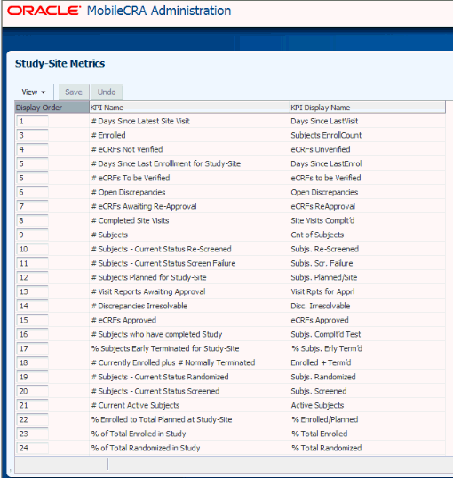

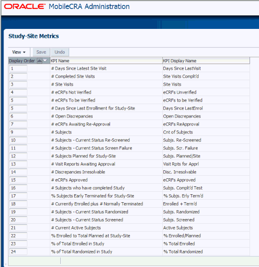

Earlier versions of Mobile CRA displayed only 6 KPIs in the application. Now, there are 27 KPIs which can be configured, the first three are used for the trending graphs. You can also change the display order of these KPIs.
Figure 2-14 The Study-Site Metrics Screen

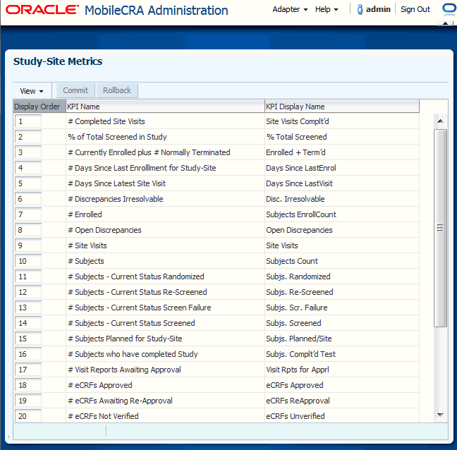

You can change the order of the KPIs displayed. Perform the following steps:
Select the KPI whose display order you want to change. Click Edit.
Enter the new display order number in Display Order. Click OK.

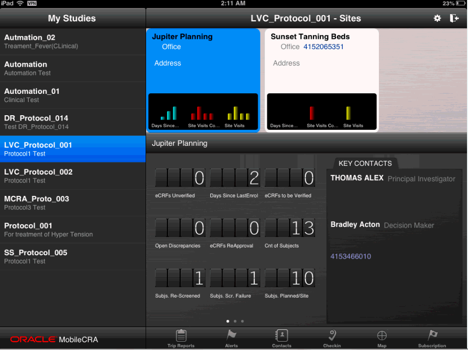

Figure 2-16 displays the corresponding display on the Ipad.
Figure 2-16 Corresponding Display Order on Ipad
Figure 2-17 displays the changed order in the Configuration Utility.

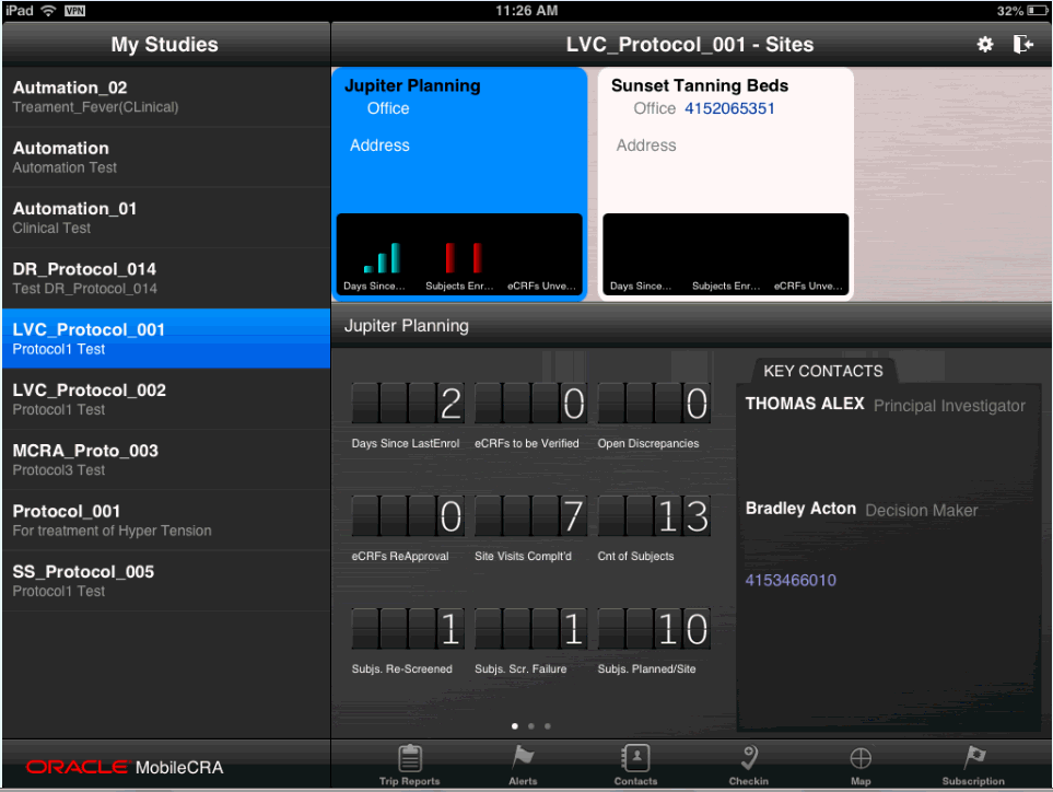

Figure 2-18 displays the changed display in the Ipad.
Figure 2-18 Corresponding Changed Display Order in Ipad
