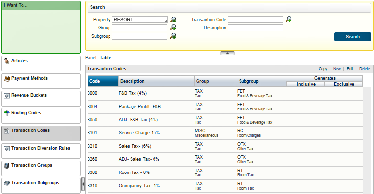

The Transaction Codes jump on the Transaction Configuration Workspace allows you to configure and edit Transaction Codes. Every charge that appears on a folio or an AR invoice must have a transaction code.

- On the Transaction Codes jump, select New to begin.
- Enter the property name, create a numeric code, and create a description to represent your new Transaction Code.
- Select a Subgroup.
- Complete the remaining fields and checkboxes as needed (view Transaction Code Field Explanations below).
