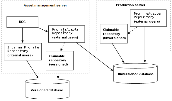

If your external profiles contain any references to versioned repositories, you must configure the profiles so that the references point to the appropriate database. A customer profile on an Oracle Commerce Core Commerce site, for example, can have properties that reference the Claimable repository, which stores information about coupons. The Claimable repository is a versioned repository, whose assets are edited on the management server and deployed to its unversioned instance on the production server. Without additional configuration, the instance of the external profile repository on the asset management server would point by default to the versioned instance of the Claimable repository. The following diagram illustrates this relationship:
In this unconfigured setup, if you used the Business Control Center to edit an external profile that had references to any versioned repository, it would be possible to drill down to properties in the versioned repository on the asset management server. You could not edit any such properties this way (the UI would prevent you from doing so because you would not be working within the context of a project). However, if any of these properties represented an asset that you select through a picker, it would be possible to add the asset to the profile. You would thus be attaching a versioned asset to an external profile on the production server, but the asset might not have been deployed. Doing so could cause undesirable results.
