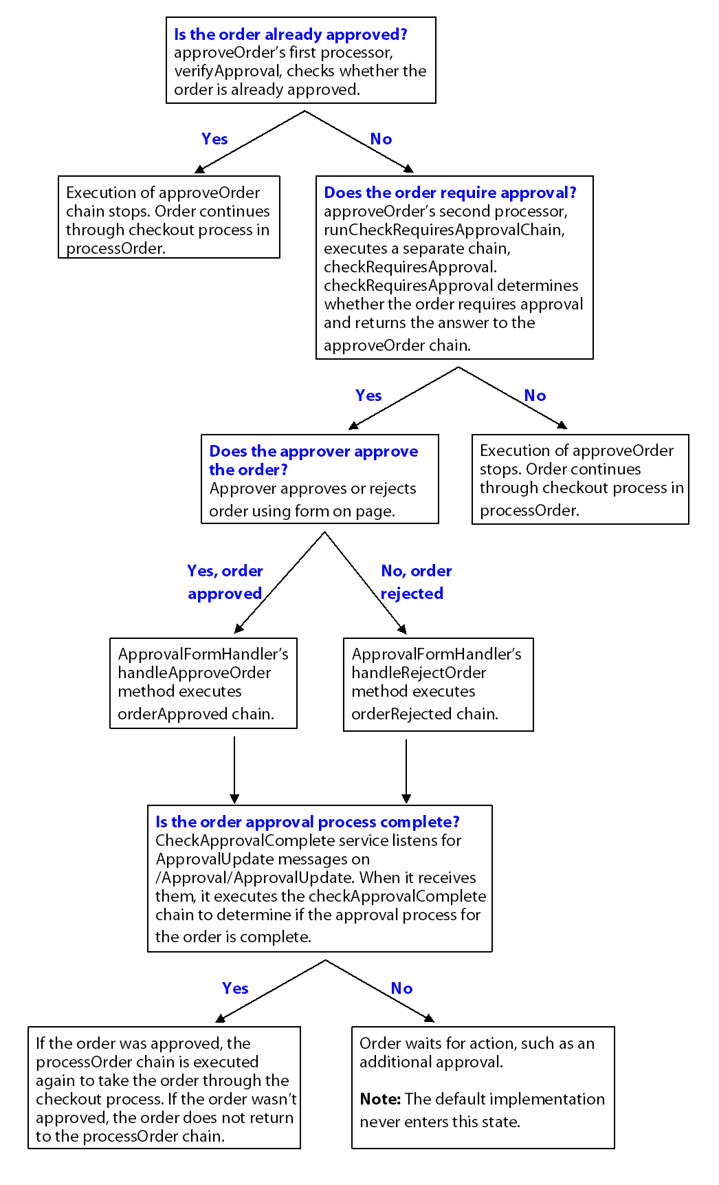

The following diagram illustrates the business logic that drives the order approval process and briefly indicates which components move an order from one step in the process to the next. The complete order approval process is subsequently explained in detail.
In this diagram, a customer has just submitted an order for checkout, and, consequently, the processOrder method has executed the processOrder pipeline chain. processOrder’s first processor, executeValidateForCheckoutChain, has validated the order. processOrder’s second processor, executeApproveOrderChain, begins the order approval process by executing the approveOrder chain. The first processor in the approveOrder chain is verifyApproval.
As is briefly illustrated in the preceding diagram, the order approval process is as follows:
approveOrder’s first processor,verifyApproval, checks whether the order already is approved.If the order is approved, then execution of
approveOrderstops, and the order proceeds through the checkout process inprocessOrder.If the order is not approved, then the order proceeds to the second processor in
approveOrder.
approveOrder’s second processor,runCheckRequiresApprovalChain, executes a separate pipeline chain namedcheckRequiresApproval.checkRequiresApprovaldetermines whether approval is needed for the order and reports back toapproveOrder.If approval is needed, then the order continues through the
approveOrderchain.approveOrderchanges the order’s state to PENDING_APPROVAL. The chain adds to the order’sauthorizedApproverIdsproperty the list of profile IDs of the users who are allowed to approve the order, and it adds to the order’sapprovalSystemMessagesproperty the conditions that triggered an approval to be required. Finally,approveOrdersends out anApprovalRequiredmessage to the/Approval/ScenariosJMS message topic. This message can then be used to execute scenarios.If approval is not needed, then execution of
approveOrderstops, and the order proceeds through the checkout process inprocessOrder. (For detailed information on theprocessOrderpipeline, see Checking Out an Order in the Checking Out Orders section of the Configuring Purchase Process Services chapter.)
Note: The default implementation of the
checkRequiresApprovalchain checks theapprovalRequiredproperty in the customer’s profile. If theapprovalRequiredproperty is true, then approval is required for the customer. An error is then added to thePipelineResultobject, which tells the system that an approval is required, and the reason that approval is required is stored in theerrorMessagesproperty of the Order. This reason for approval is later added to the order’sapprovalSystemMessagesproperty by theapproveOrderchain’saddApprovalSystemMessagesToOrderprocessor. If theapprovalRequiredproperty is false, then approval is not required for the customer.You can edit the
checkRequiresApprovalchain to create specific requirements for whether an approval is required for a given customer. For example, you might want to include a processor that checks the total amount of the customer’s order against an order limit specified in the customer’s profile. If the order amount exceeds the specified limit, then approval for the customer’s order would be required. Similarly, you might want to include a processor that checks the manufacturers of the items in the customer’s order against a list of preferred suppliers specified in the customer’s profile. If a manufacturer is not in the list of preferred suppliers, then approval for the customer’s order would be required.If approval for the order is needed, an approver then approves or rejects the order and submits this decision in a form using the
ApprovalFormHandlerform handler. The form’s “Approve” and “Reject” submit buttons call thehandleApproveOrdermethod or thehandleRejectOrdermethod, respectively.If the
handleApproveOrdermethod is called, the method executes theorderApprovedpipeline chain.orderApprovedadds the profile ID of the user who approved the order to the order’sapproverIdsproperty, and adds the messages associated with the approver’s decision to the order’sapproverMessagesproperty. Finally,orderApprovedsends out anApprovalUpdatemessage whoseapprovalStatusproperty is set to “approved.” This message is sent to both the/Approval/ApprovalUpdateJMS message queue and the/Approval/ScenariosJMS message topic. This message can then be used to execute scenarios.If the
handleRejectOrdermethod is called, the method executes theorderRejectedpipeline chain.orderRejectedadds the profile ID of the user who rejected the order to the order’sapproverIdsproperty, and adds the messages associated with the approver’s decision to the order’sapproverMessagesproperty. Finally,orderRejectedsends out anApprovalUpdatemessage whoseapprovalStatusproperty is set to “rejected.” This message is sent to both the/Approval/ApprovalUpdateJMS message queue and the/Approval/ScenariosJMS message topic. This message can then be used to execute scenarios.
Note: The
orderApprovedandorderRejectedpipeline chains are the same with the exception of the value ofapprovalStatusproperty of theApprovalUpdatemessage that is sent. You can edit these chains to add or remove functionality to meet your application’s needs.The
ApprovalCompleteService, located in Nucleus at/atg/commerce/approval/ApprovalCompleteService, is configured to listen for theApprovalUpdatemessages sent by theorderApprovedandorderRejectedchains to the/Approval/ApprovalUpdateJMS message queue. WhenApprovalCompleteServicereceives a message, it executes thecheckApprovalCompletepipeline chain.checkApprovalCompletedetermines whether the approval process for the order is complete. By default,checkApprovalComplete’s second processor,approvalCompleteAnalyzer, checks whether at least one person has approved or rejected the order. If so, then the approval process for the order is considered to be complete.If at least one person has approved the order,
checkApprovalCompletechanges the order’s state from PENDING_APPROVAL to APPROVED and executes theprocessOrderchain so the order can go through the checkout process. (For detailed information on theprocessOrderpipeline, see Checking Out an Order in the Checking Out Orders section of the Configuring Purchase Process Services chapter.) Additionally, thecheckApprovalCompletechain sends anApprovalCompletemessage whoseapprovalStatusproperty is set to “approval_passed” to the/Approval/ScenariosJMS message topic. This message can then be used to execute scenarios.If at least one person has rejected the order,
checkApprovalCompletechanges the order’s state from PENDING_APPROVAL to FAILED_APPROVAL, and sends anApprovalCompletemessage whoseapprovalStatusproperty is set to “approval_failed” to the/Approval/ScenariosJMS message topic. This message can then be used to execute scenarios.
Note: As previously mentioned, the default implementation of the
approvalCompleteAnalyzerprocessor merely checks whether at least one person has approved or rejected the order. If so, then the approval process for the order is considered completed. You can change the implementation ofapprovalCompleteAnalyzerin order to change the requirements for completion of the approval process.
For detailed information about the pipeline chains and processors mentioned in this section, refer to Appendix E: Pipeline Chains.
