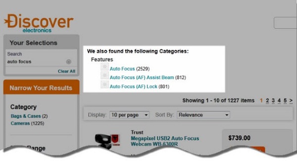

Dimension search results are shown below in the Discover Electronics reference application:
Note that the cartridge does not display in the application if the site visitor never uses keyword search. Additionally, if the visitor refines a keyword search by selecting navigation refinements, dimension search matches no longer display.
