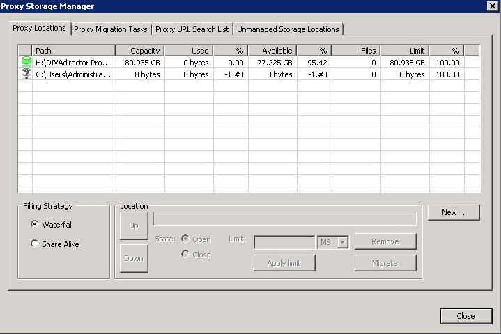

Use the following procedure to check your storage locations and remaining available space:
  1. Click Proxy Storage Manager on the DIVAdirector Server Configuration screen to load the Proxy Manager.
  2. Review the storage locations on the Proxy Locations tab.
    Surrounding text describes c3_proxymanager.jpg.
  3. Check each location's Status Icon (the first column) to identify the current storage location status. The "Proxy Location Operational States" section describes the icons.
    If the location's state is something other than operational (and you didn't set it that way), you must identify why it is the current state and if necessary resolve the issue. You use the server logs and Drop Folder logs to help identify issues. If you are unable to resolve the issue and need further assistance contact Oracle Support.
  4. Check the Used and Available columns to identify how much of the storage space is filled and how much is left available (respectively) for each location. You will need to decide if additional space is required, if data must be migrated to another location, or if the location is fine the way it is.
  5. If you must add a new storage location refer to "Storage Location Configuration".
  6. If you must adjust the storage space limits refer to "Configuring the Proxy Location's Storage Size".
  7. If you must migrate data to another storage location refer to "Proxy Migration Tasks".
